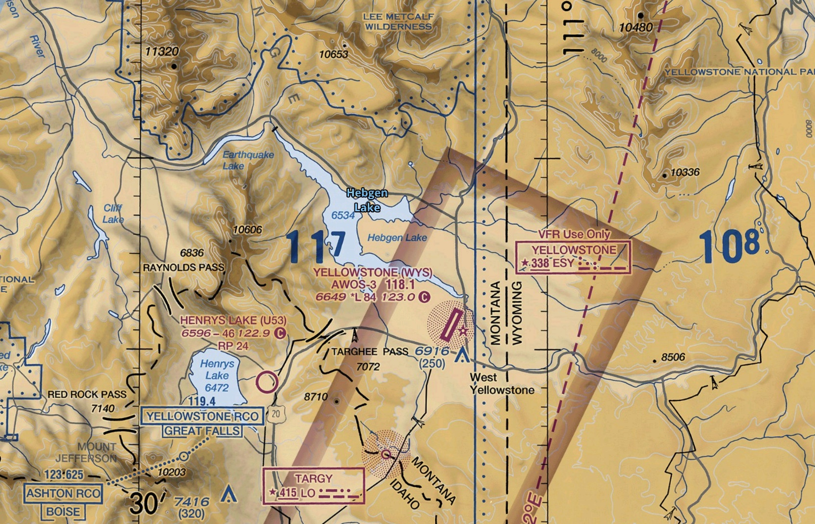

But you also implied that you are flying under Part 107, and so the 5 mile distance to the airport is not relevant - only the airspace class. Since there is no surface Class E around KWYS you are free to fly the entire area provided that you stay out of traffic.
there's another question. once you get your 107 are you always bound by it meaning now every time you fly because you have a 107 certification you will be considered flying under 107 or only when you are doing commercial work . Also when i looked it up i thought it was a five mile radius around KWYS . will double check .there is some flying i would like to do in the Madison arm of the lake that would be nice .
No - you are not constrained to flying under Part 107 - you can still fly under Part 101 for recreation.
You thought what was a five mile radius around KWYS?
restricted air space .
I'm not sure what kind of restricted airspace you mean, but I don't see any around KWYS.
