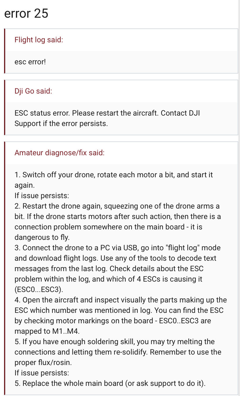

Where would I see error codes? I have a feeling it might be a ESC problem but unlike my P2 that had separate ESC boards the P3 ESC seems to be integrated into the main board.
Below is a snippet from the link @quaddamage gave you earlier in post 3. It notes that you can see the error in your log, in the app, and gives some suggestions for troubleshooting.
Reactions: JoBe and Capt KO

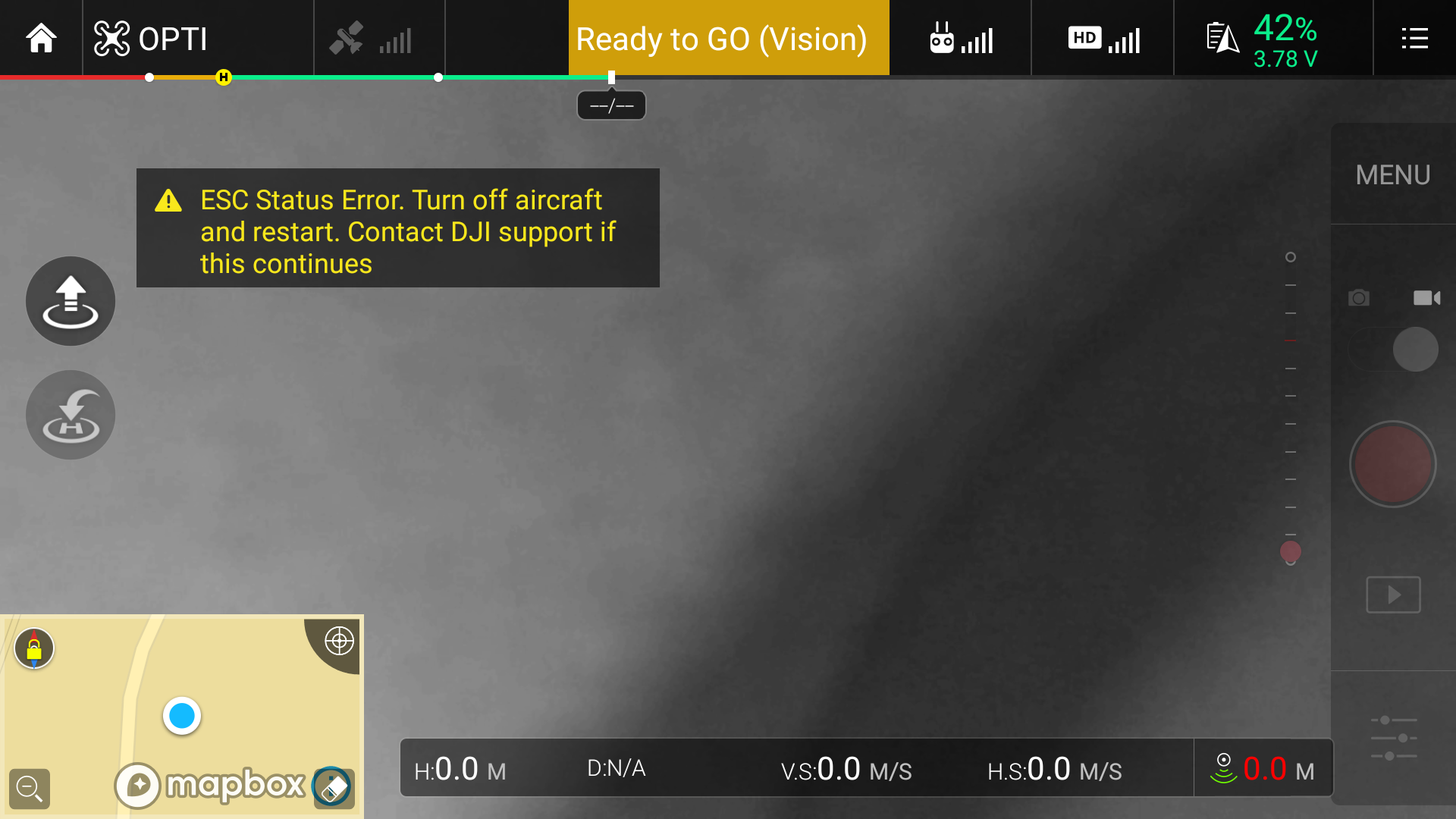

The go app may well show a pop up message concerning the esc error, I have a drone doing this and attached is a screen capture of the go app warning
