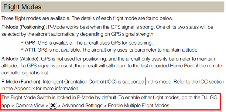

So what happens when your flying out of beginner mode and the right hand s1 switch is In
The middle?
The middle position is ATTI mode.
Beginner mode is an unrelated feature. You'll need to enable the Multiple Flight Mode setting if you want to use ATTI mode.
Reactions: Vzr1

I was actually referring to this:
makes no sense as A mod can help to save your drone due to Compass or GPS malfunction
The bird should auto switch to ATTI when is senses trouble.
