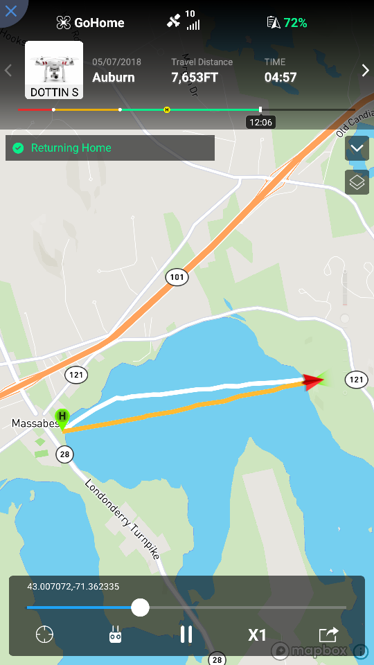

Open area like a Lake I get over 7000ft + (need to return about the battery not lose signal) and Urban 2300 - 3000ft depend conditions..

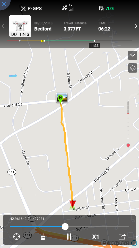

Hey maybe check out my ranges now touching 3 miles (nearly ) no antenna or anything but that’s about the capacity of the battery well within safe margins I’d say
Couple of my flights strong signal all the way choose to return to home just taking small steps

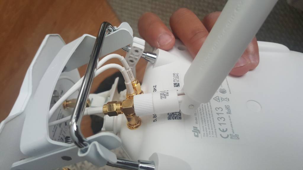

Solutions after that will require opening the controller. Next one I would reccomend would be either an ARGtek Blue Proton range extender kit ($60 Amazon). Or fabricating a 5.8ghz 10db flat panel antenna made by Alfa specifically an APA-M25 combined with 2 2.4ghz 7db flat panel Alfa antennas ($40 Amazon) these will get you up to around 1 mile more or less. While the most expensive option is the DBS mod. Most will tell you the DBS mod is capable of best range although they are difficult to aim at long distances. The Alfa mod will be more forgiving and achieve similar distances as the DBS mod.
Adding Sunhans boosters to an Alfa setup gets 5.845 km - plus good quality shielded cables inside the controller and outside are a must
Could you please specify the amplifier model numbers and possibly post a picture of your controller setup? I have been considering adding amplifiers recently and noticed a few amps on Amazon by that same manufacturer. The Alfa APA-M25 antennas are decent although I'm sure you are getting an immense increase in range with amplified output to Alfa APA-M25 panels. Looking forward to doing a similar mod. I did wonder what sort of power source could be utilized for both portability and energy capacity. Still contemplating just how to mount and configure the amplifiers as well as power source configuration for a handheld, portable remote controller fabrication.

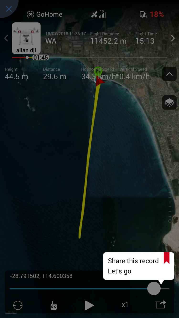

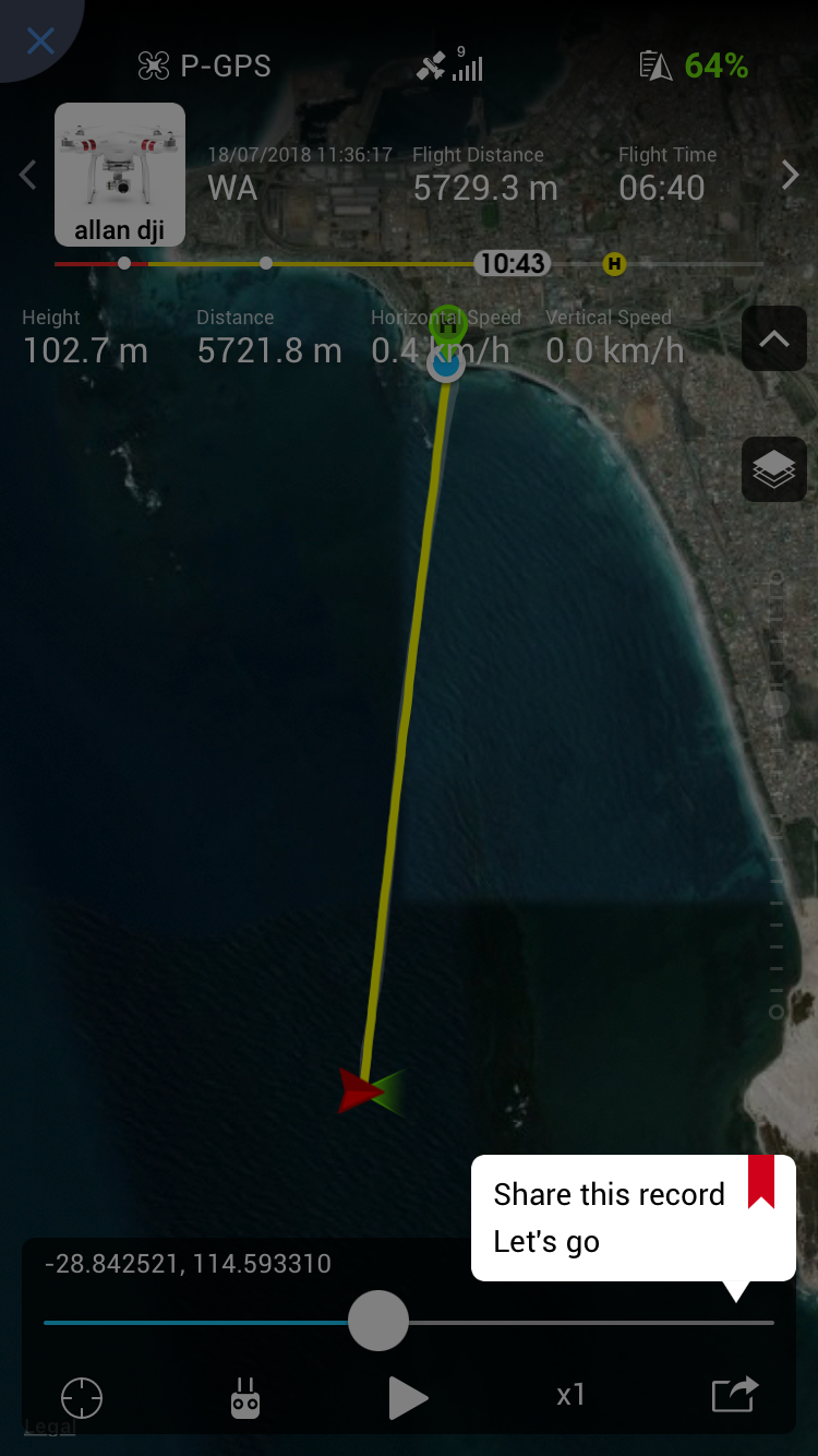

Excellent result, even with Magic Power and a standard antenna, the maximum distance I could get was approximately 1.4 km at 80metres altitude over water
