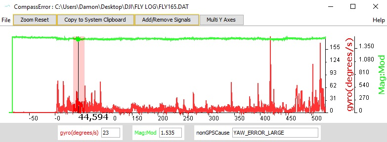

The screenshots of the .DAT show the compass error that occured. Most likely it is coincident with the ATTI mode shown in the Litchi log
This doesn't appear to be one of those launch-from-geomagnetically-distorted-site incidents since the compass error did not occur immediately after launch. But, it could be similar to some recent incidents where there was an abrupt change in the compass. Would it be possible to Dropbox or GoogleDrive the .DAT and post the link here. It would also be helpful if you could include the .DAT for most recent flight before this incident, and the .DAT for a subsequent flight if any.
During ATTI mode there was a 2 second interval where there was a no stick input and the P3 appeared to be flying sideways. Most probably it was drifting with the wind. Was the wind out of the southeast at about 10 MPH?

Thanks for retrieving and posting these. I looked at them all. In summary the incident in FLY165 should be considered to be a one-off as @Meta4 suggests. I've had this happen to my P3 a few times. My perspective is that the Flight Controller can't be perfect, and will sometimes erroneously detect the possibility of a compass error. By switching to ATTI mode the P3 is basically saying to the pilot "you fly this thing until I'm ready".

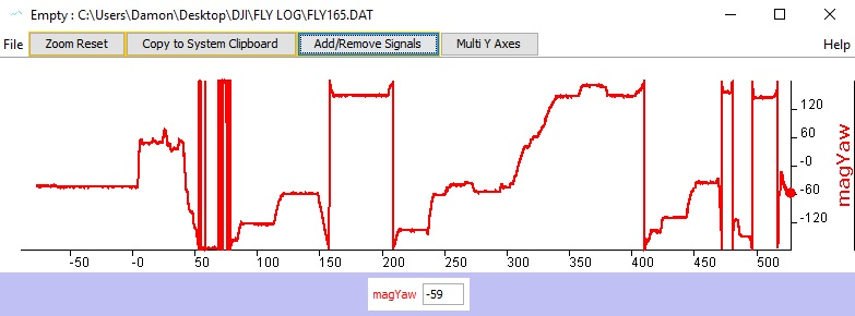

DatCon computes a signal called magYaw that is heading based just on magnetometer data and then corrected for roll and pitch. It's completely independent of Yaw which is computed by the Flight Controller. The two don't always agree. E.g. when launching from a geomagnetically distorted site. Also, once the geoDeclination can be derived from GPS data Yaw will be adjusted by that amount.
The FC must use magYaw (or something like it) to compare against it's Yaw value. When a difference is seen the FC can't really know which is correct and will declare a YAW_ERROR_LARGE compass error just to be safe. With the P3 the switch to ATTI is pretty immediate, the other platforms can vary in the amount of time it takes to switch. You can see this in your flight.
The problem is that magYaw doesn't always get computed correctly and this is the reason for these one-off compass-error-switch-to-ATTI incidents. I've been trying to figure this out for at least 6 months now. The actual magYaw computation has been verified correct in a couple of ways - the FC suffers from the same problem. I had suspected that the larger quantization errors that occur at the higher geoInclination latitudes (i.e. closer to the poles) was the problem. But, that was a science fair project that didn't work out. It does seem like there is some relation to abrupt changes in pitch and or roll, but I haven't gotten very far with that.
Got all that :), It's a one-off. It may happen from time to time in mid flight as it did in this flight. But, if you ever get a compass error immediately after launch that's probably for real. The P3 should be recovered ASAP, and don't initiate an RTH.
