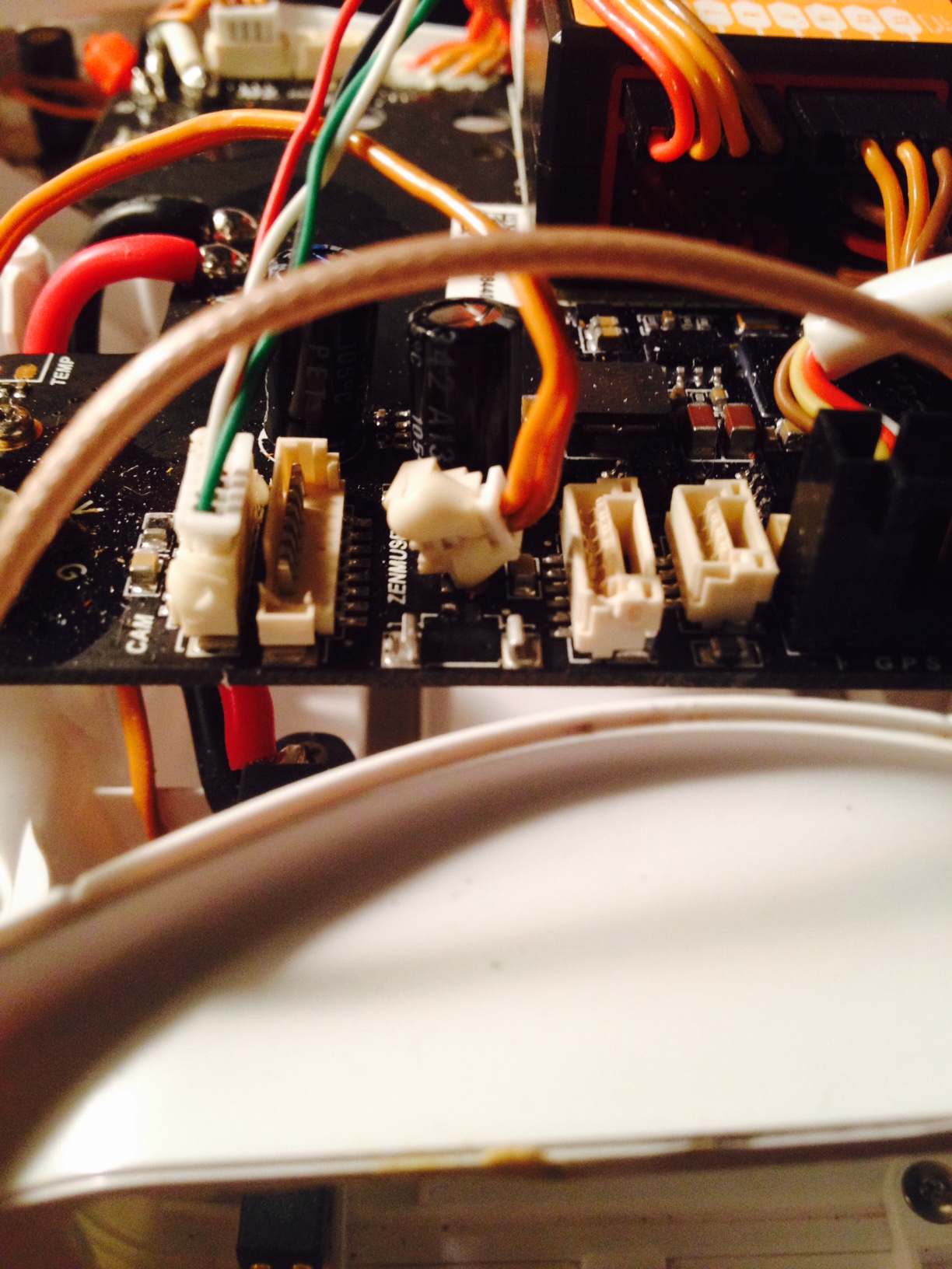

I am not sure but I think if you get a "Not a DJI Battery" it could be one of the connections to the Main board has failed, The bottom one on the battery connection maybe. I am not positive about that but it is ringing a bell (in a far away church) :) If it was the connection it would do it with all of your batteries. If only 1 battery is reporting that, then I would think that 1 battery has failed.

I have seen that issue before. I have no idea why it happens but the entire thing broke off of the main board. I think I replaced at lease 2 main boards because of that issue. Just to check, that is the cable to the data connection on the battery. The bottom connection, below the plus and minus power pins.
Yea those things got to be right but it helps also when the cables from them don't look like this .
View attachment 16905 ;)
Ya..That's the one ;)
Broke a connector right off the main board. Man, that must have hit hard!!! You are correct about catching MIA on the way down. That would have made some very sore fingers and hands.
