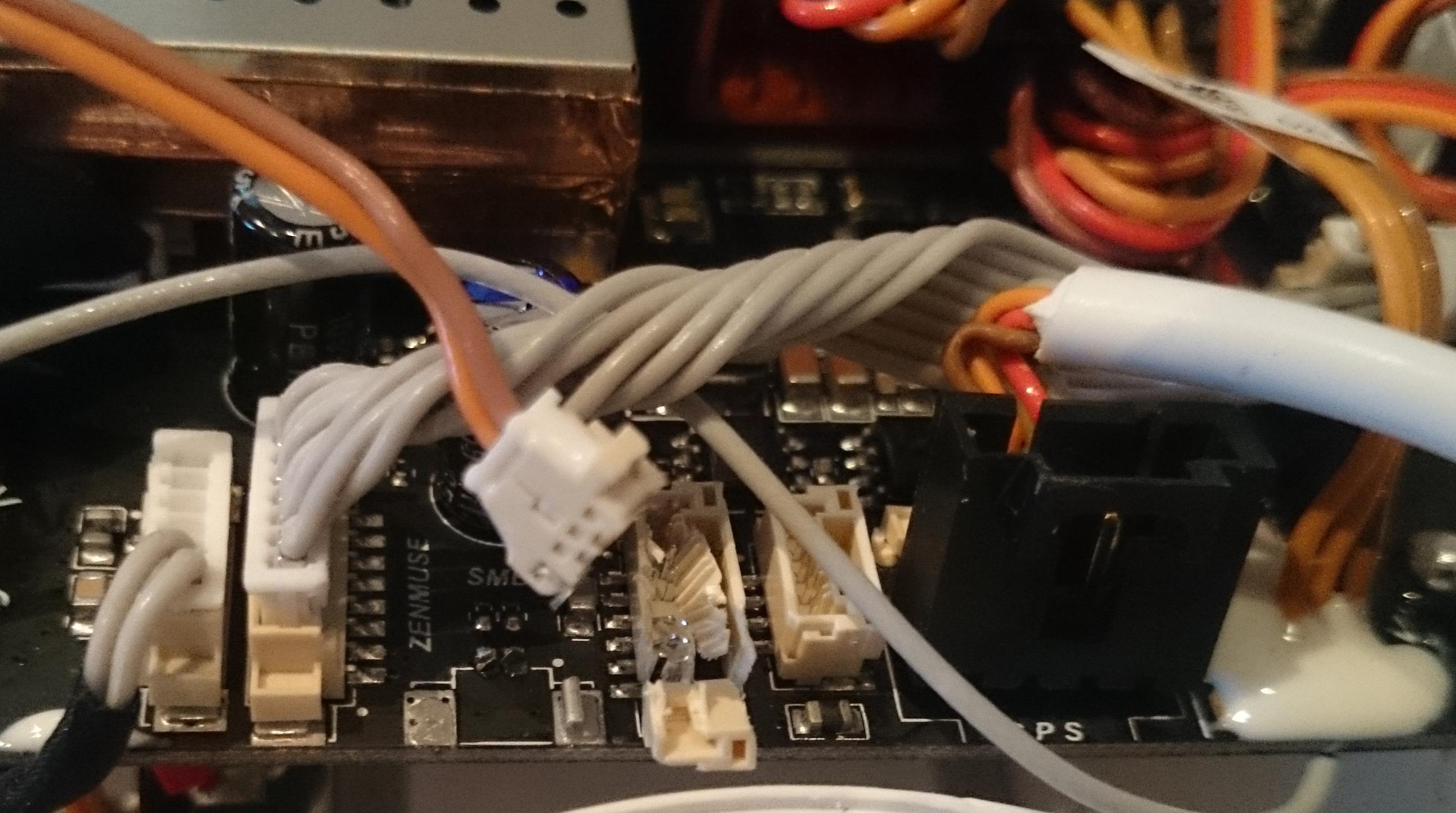

This is not my board but I need to know if that cable in the middle that goes to the
pins in the battery box were to come lose like that while you were up...
would that shut you down ? o_O

Double check the pins on the battery connector which the NAZA chats to the battery through. Are they broken ? Perhaps the battery is OK.

Thanks Hugie and have it sitting here beside me now and just checked those .
They are fine and still push in and come right out .That wire that's in the picture goes straight to those pins . That's the only connecter that has come off . The other's in there were a little loose but this thing hit hard I mean right at my feet !

Yes, it would shut off the motors the instant the cables became disconnected.
