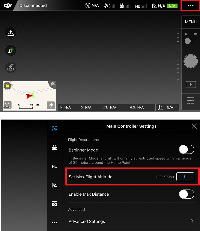

Where in the app do you find it? I browsed around the app for a while and didn't see anything.
You can turn off Beginner Mode in the "Main Controller Settings" section of DJI GO. You'll also need to increase the max altitude here:

Thanks msinger
In Beginner Mode, the max altitude is 98 feet.
