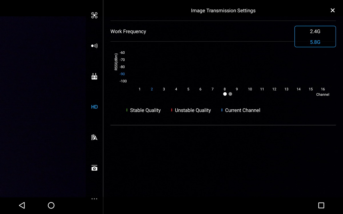

Is anyone else seeing that the option to switch between 2.4Ghz & 5.8Ghz has gone missing in this latest update?
EDIT: I think I may have been looking at the settings when not connected to the Phantom fully. Flew briefly today & the option was available.....sorry for causing panic :)
I'm on latest version and still have the option:
