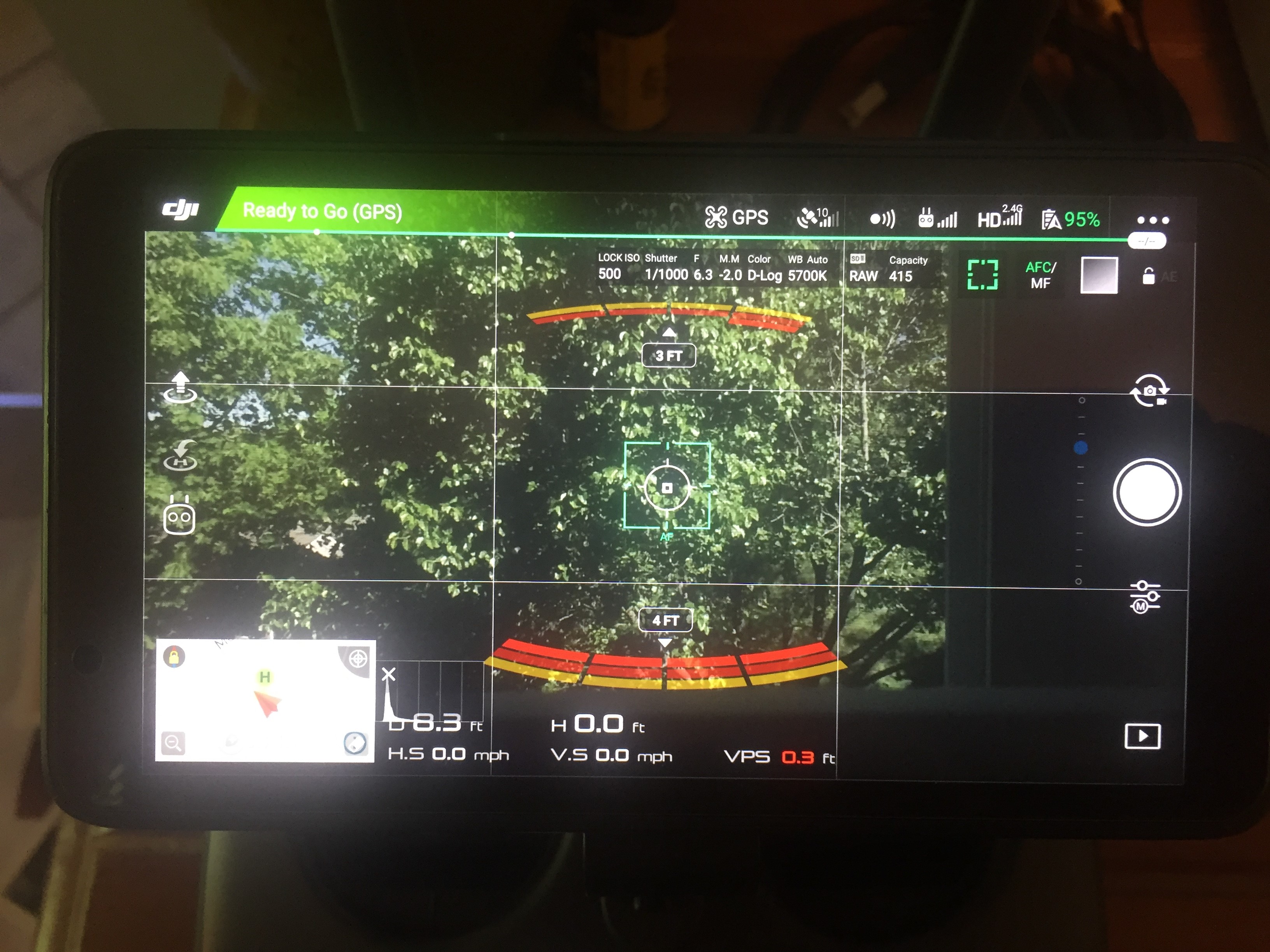

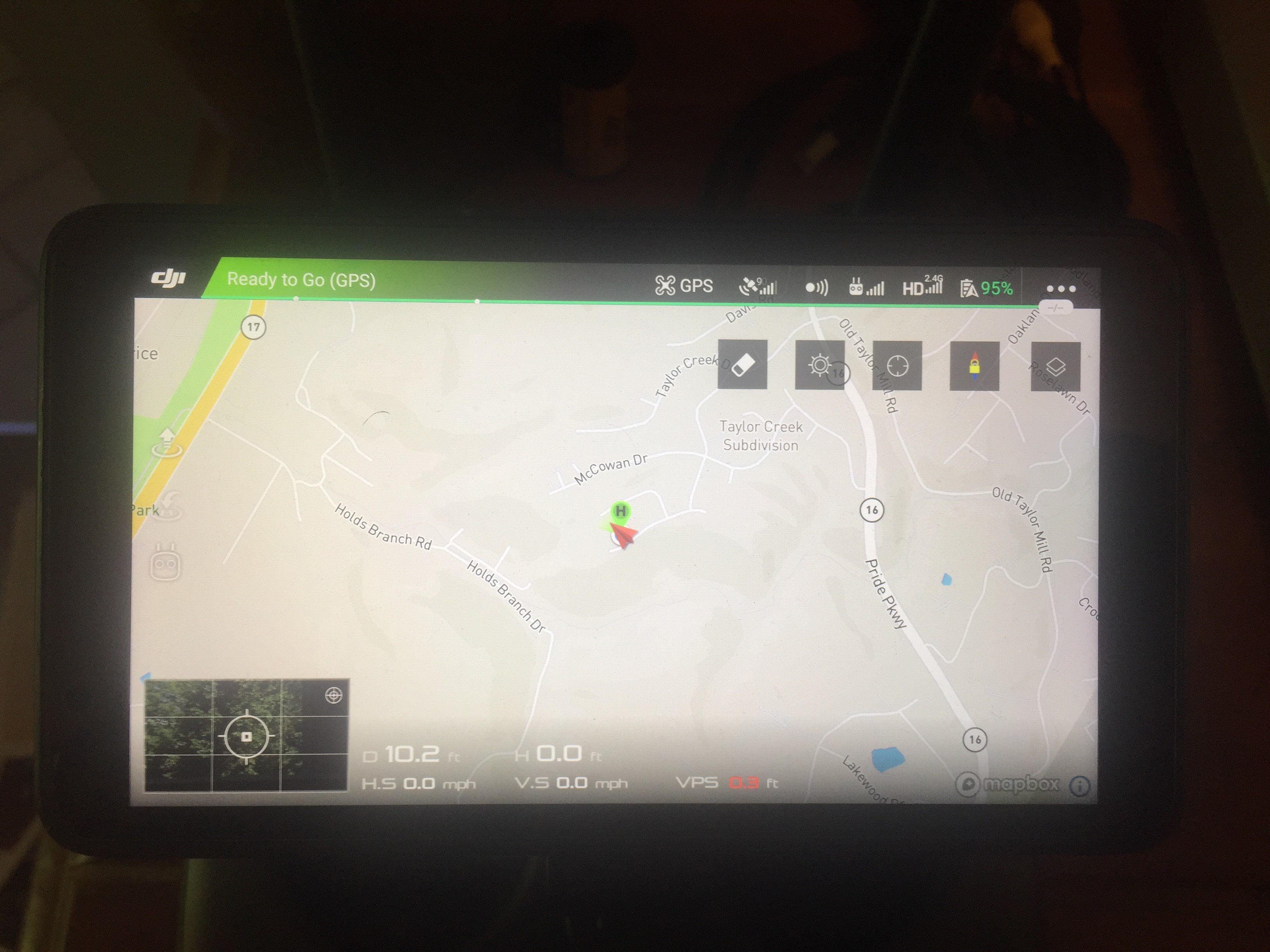

Saw your post again this morning and grabbed my Plus and linked it to see if I could duplicate / resolve this issue.
First 2 pics (below) were after linking.
Maps were blank on mine also?? Uh oh.

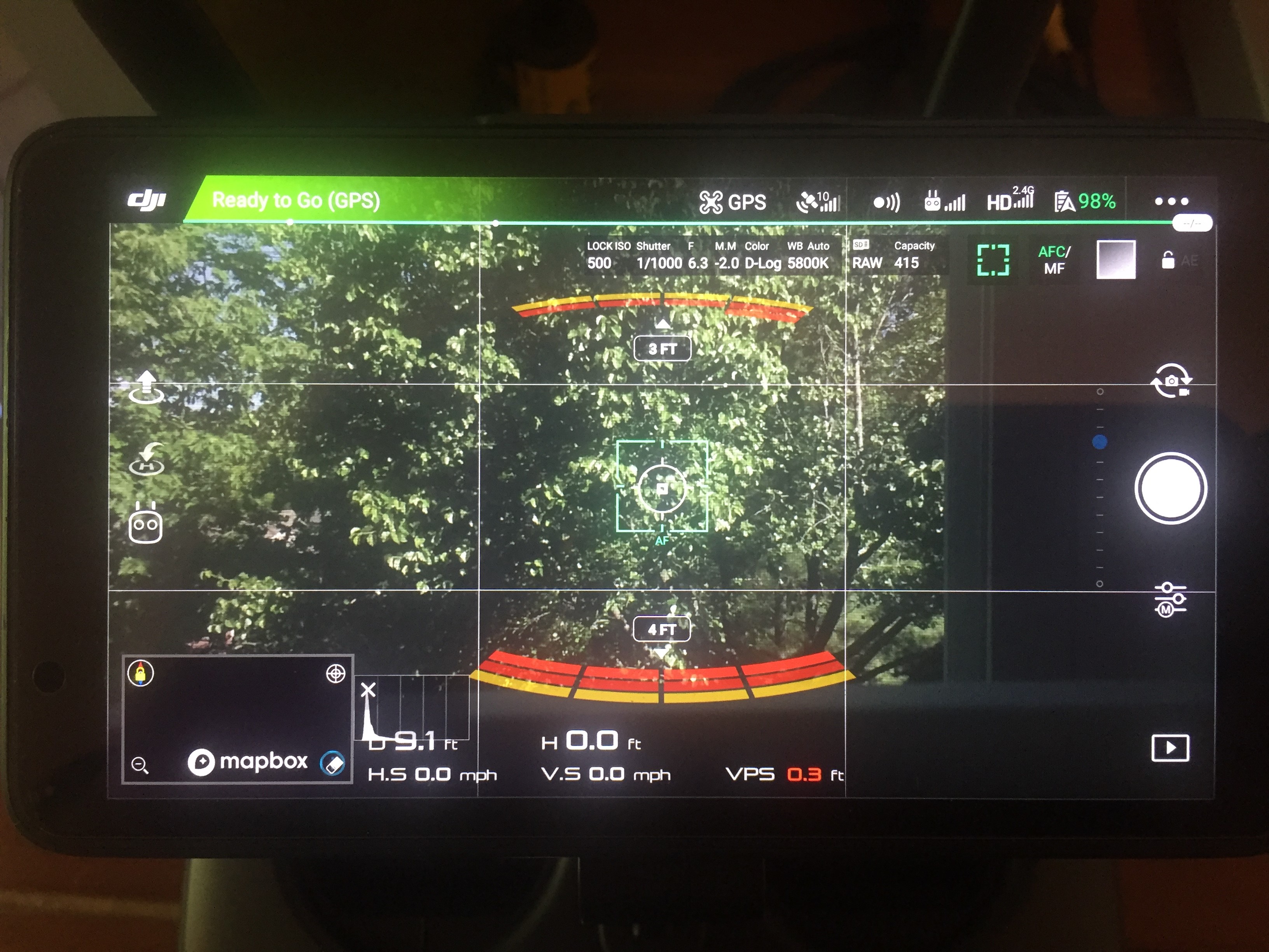

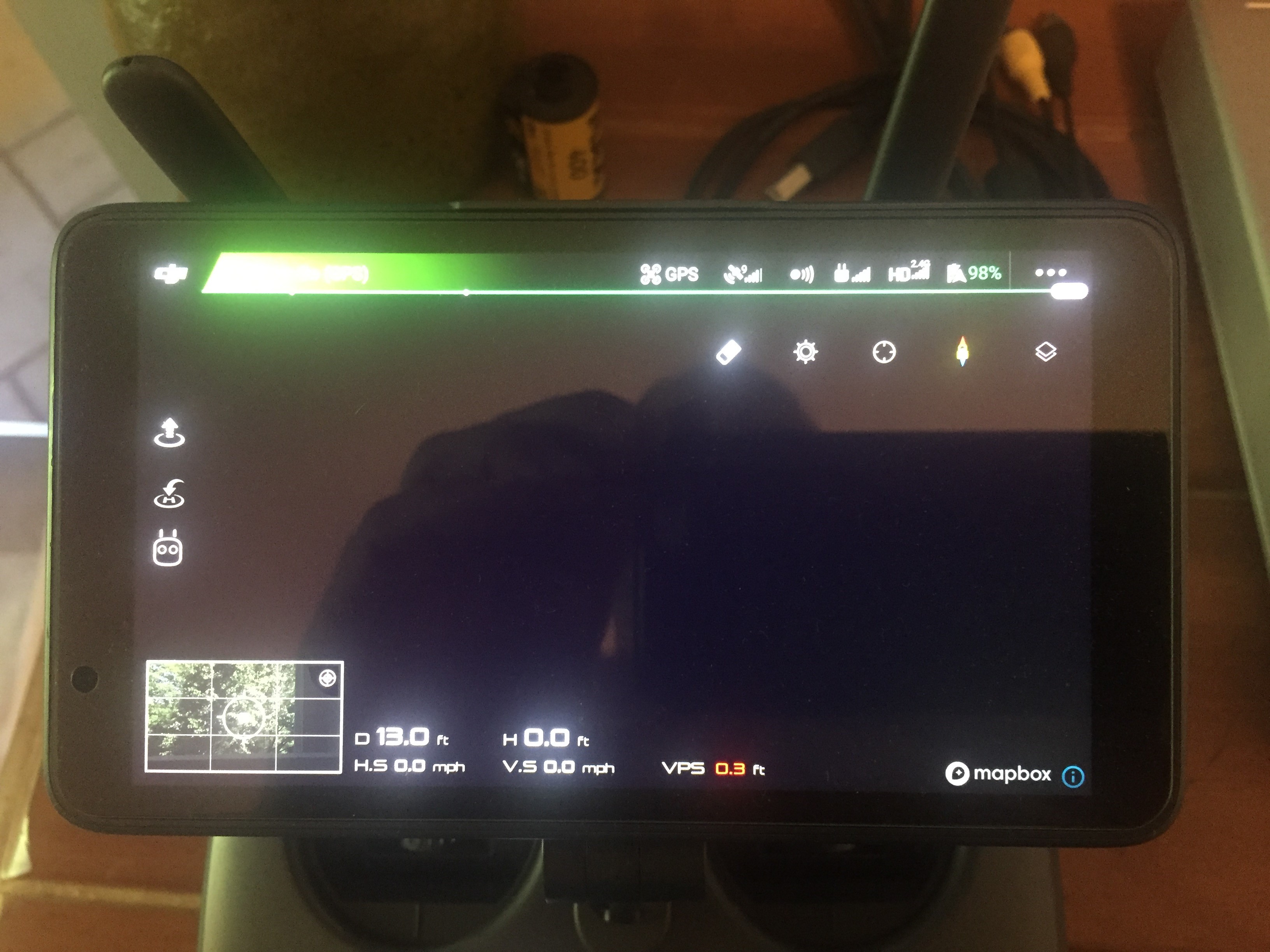

Went to maps menu (DJI GO 4, main page), fourth icon, top left.
Downloaded the area maps where I'm at.
Restarted. All good. Got the maps (last 2 pics).

Here's the fix (was for me anyway).
Place finger top / middle of Pro Plus controller screen.
Swipe down. Should see the Volume and Brightness menu.
Below that, I had a box saying an update for DJI GO 4 was available, version V4.3.14 (8-dpad)
Downloaded the new DJI GO 4 app.
Followed all the installation instructions after the download.
Restart.
Maps returned right away!
This means they were coming thru wifi.
Downloaded my area maps again.
This time, the download did not hesitate and went right through to completion at 100%.
