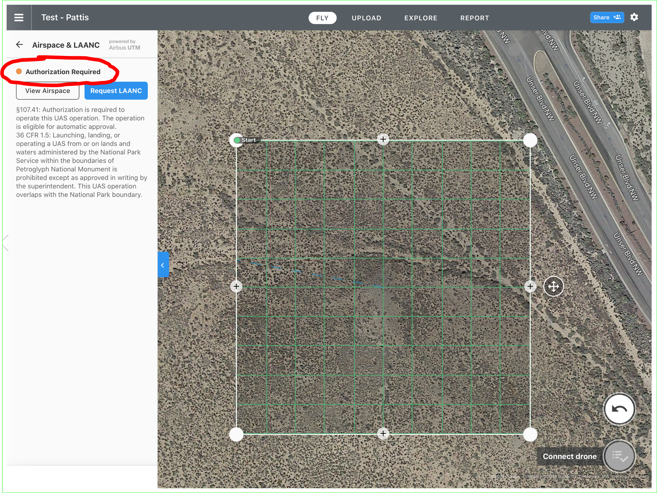

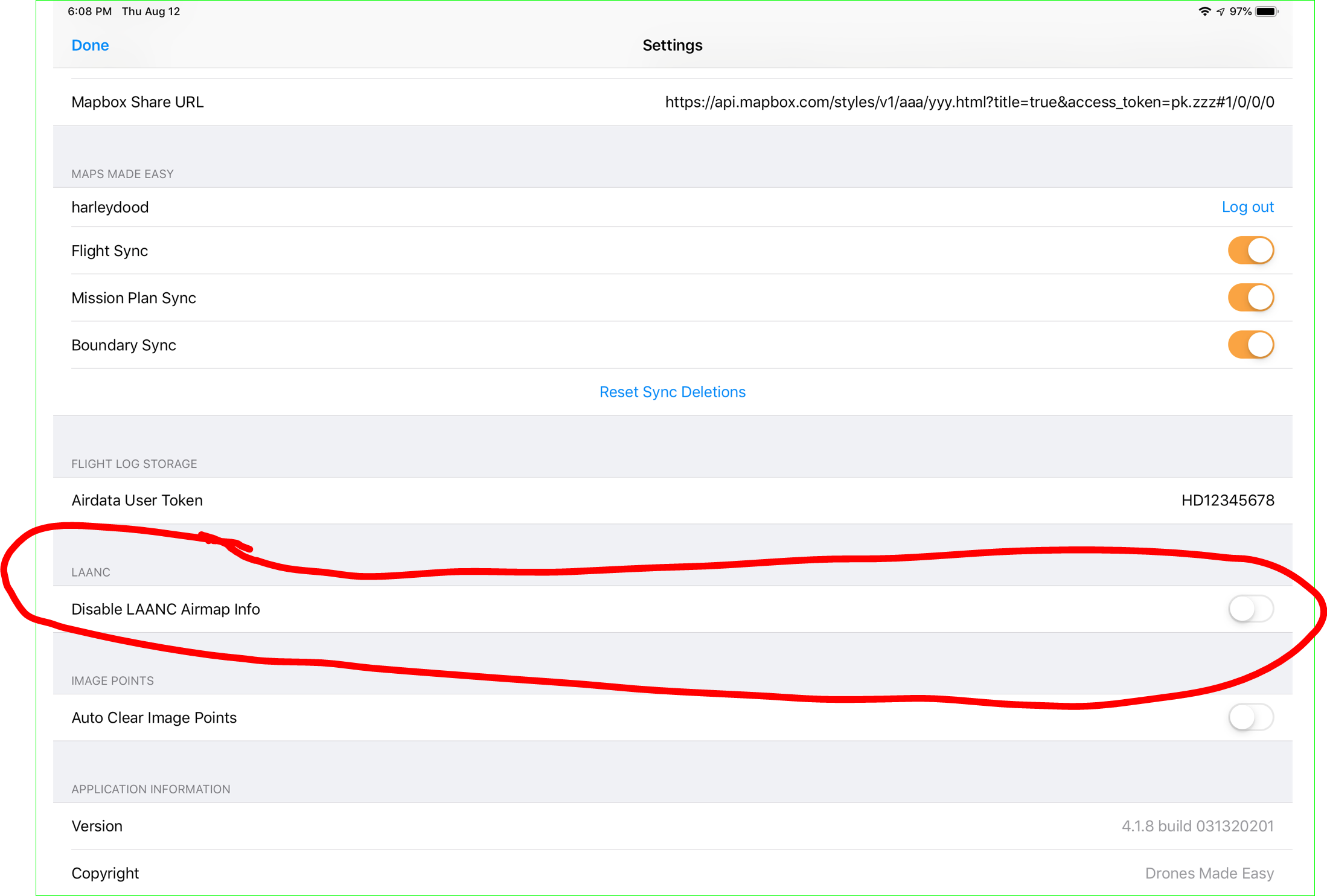

As you're aware, we were able to disable LAANC in Map Pilot:
Drone Deploy doesn't seem to allow this option:
I have emailed Drone Deploy, but haven't heard back from them as of this writing. Their support guy, Tyler, has been pretty good about responding to email. However, it seems Drone Deploy is based out of Australia (it's midnight there now). So support communication is a bit slow.

You'll be happy to know the switch is still there to turn off LAANC with Airmap.

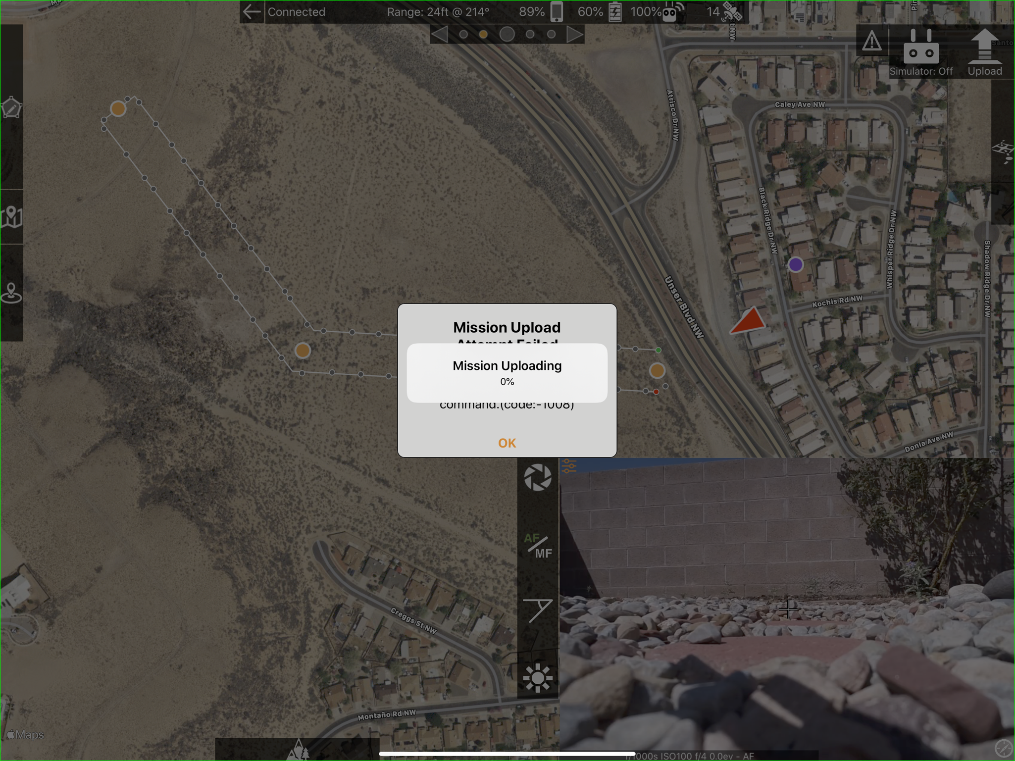

I experienced a double bug where the mission wouldn't upload, and the error message window was covered by the "Mission Uploading" window. A restart of the app fixed it.
A second bug was the app unable to load P4P vehicle parameters, but yet said it was connected to the P4P. I rebooted the bird and the controller and unplugged and replugged the USB-C cable to no avail. The "fix" was to close and then restart the app.
I haven't paid for it yet, but honestly, I probably will. I'm going to see what happens when the trial runs out.
