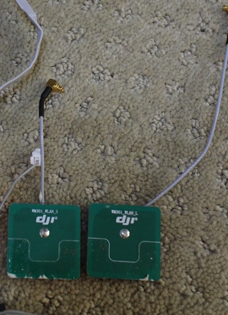

Your 2.4 GHz (VIDEO) link antenna on the bird should be a DIRECTIONAL panel antenna that's BUILD inside the bird. In the P2V+, this is simply "glue" on to the side (right and left) of the bird. I suspect this is the case with P3S as well. So look at the vent on LEFT side and RIGHT side of your drone and see if you see a green square panel that looks like this (picture below).
And see if they are lose or if they are flush against the side of the vent. Interestingly enough, given this is a directional antenna, you get better video signal when either side of your bird is pointing directly at you (ie. flying side way toward or away from you).

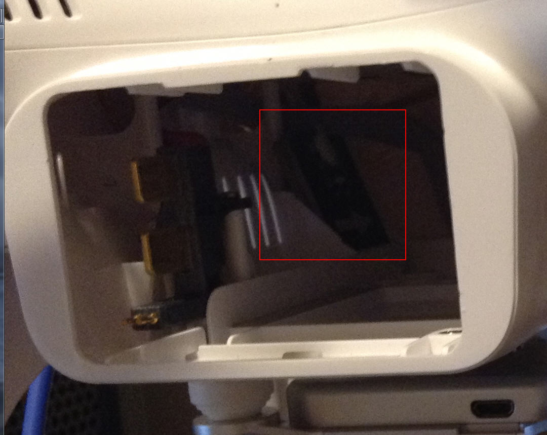

Sides of my bird
Sent from my iPod touch using PhantomPilots mobile app
I don't think there is a way to change to FCC from CE and I was flying it in town with bad signal v.s. in the country with good signal but I wasn't getting as far as I usually am in town.

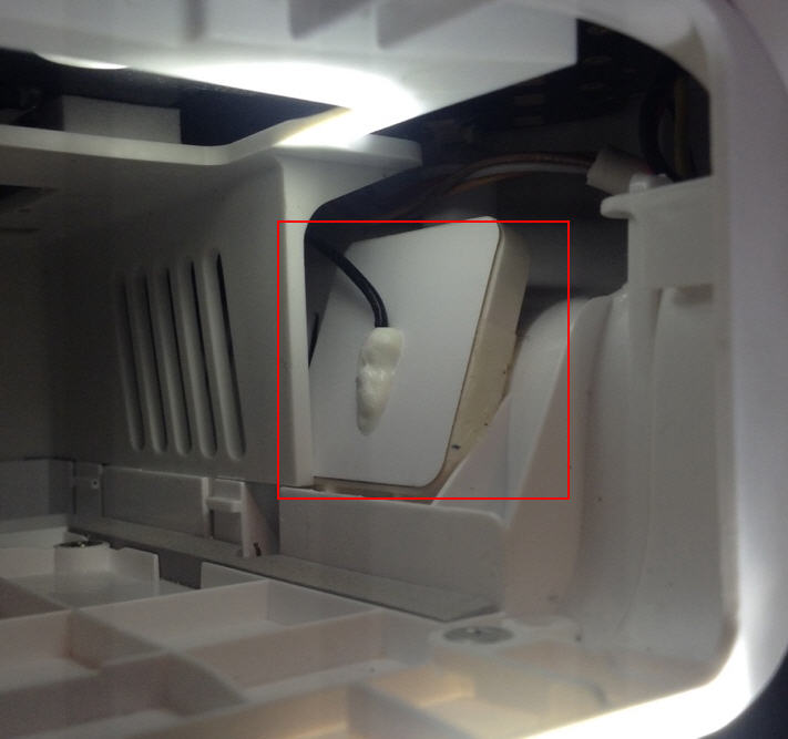

Take a picture from the back of your Phantom looking into the battery bay (without the battery), aim toward the side where the vent is.
On my old P2V+, that's where the antenna was located.
On P2V+, that's where the video antenna is at. If you are losing RC first, then check the antenna down the side of the leg.

Pretty sure that's your 2.4 GHz video directional panel antenna. You are losing RC signal at 600 ft where it used to go 1200 ft, so this isn't the culprit.

Do I need to move it back into place?
You are not losing video signal first, so I wouldn't touch it (Unless you know it was not where it used to be). I don't have a P3 Standard so can't tell you where it should have been at. For all I know, this is where it should have been.
