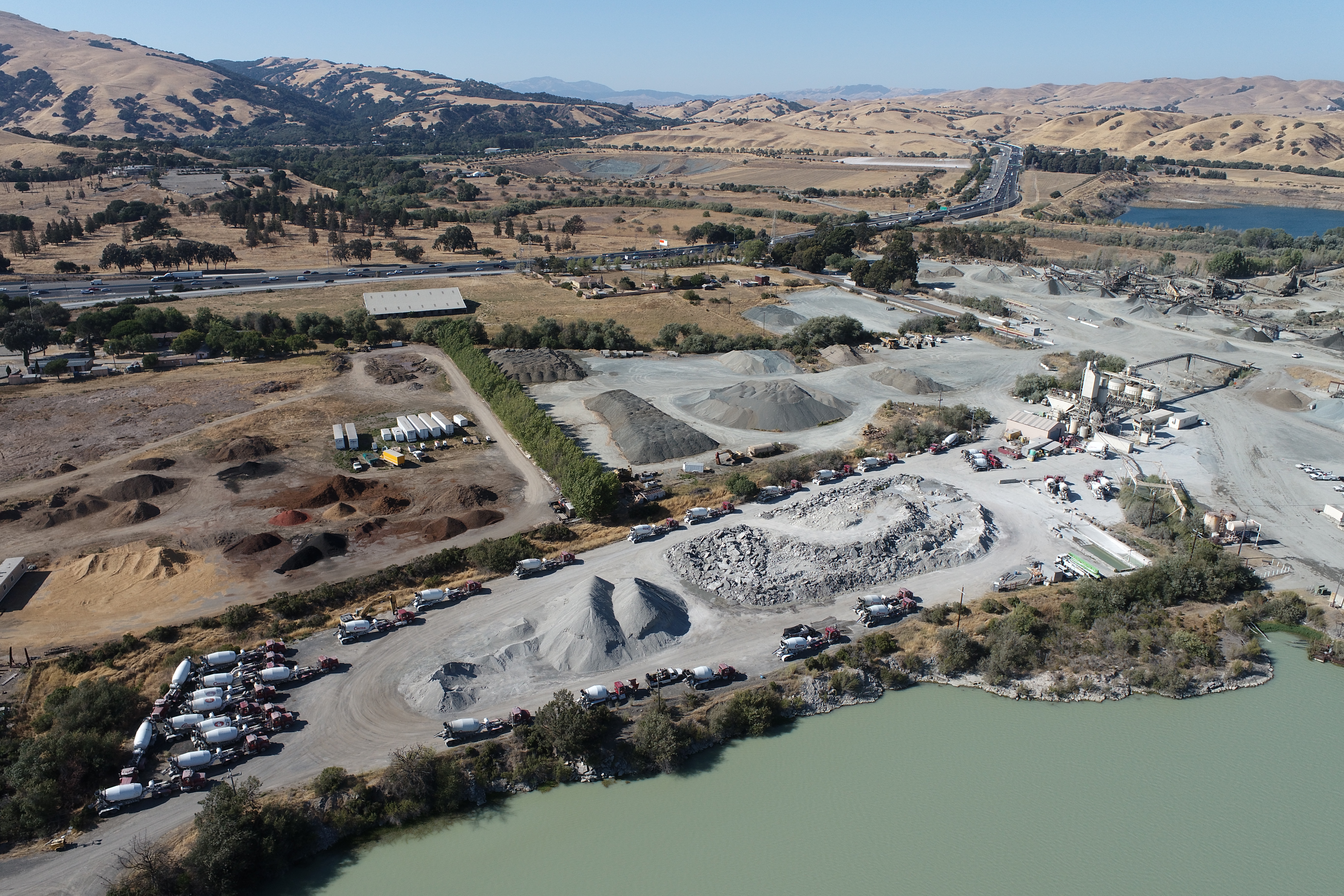

I was just flying a P4PV2 at the stockpiles in Sunol, CA off Interstate 680 to calculate the cubic yards volume. The open pit mine is in the distance.
