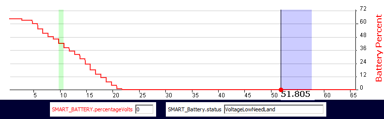

This event was an autoland due to critically low battery voltage, but has at least one unusual feature:
The reported battery level starts at 52% and only drops to 50%. The battery voltage starts at 15.3 V and then drops to a fairly steady 13.3 V or so, but at 51 seconds the FC announces a low-voltage condition and goes directly to auto land, during which time you only had limited lateral control. Impact occurs at 63.75 seconds, as indicated by the wild excursions in the pitch angle.
This looks like an example of the problem that @Meta4 discussed where the % indication is very unreliable if launching with a battery that is not fully charged. The cells are hovering around the 3.3 V level for most of the flight.
The smart battery subsystem seems confused. It shows a very steep drop in percentageVolts from about 64% to 0% at about time 22 secs. But, it isn't until about 52 secs when the smart battery system says VoltageLowNeedLand.
Good spot on the percentage voltage - I didn't look at that. Further evidence that the battery is confused, since the voltage, voltage percentage, and battery percentage bear no obvious relationship to each other in this case.
