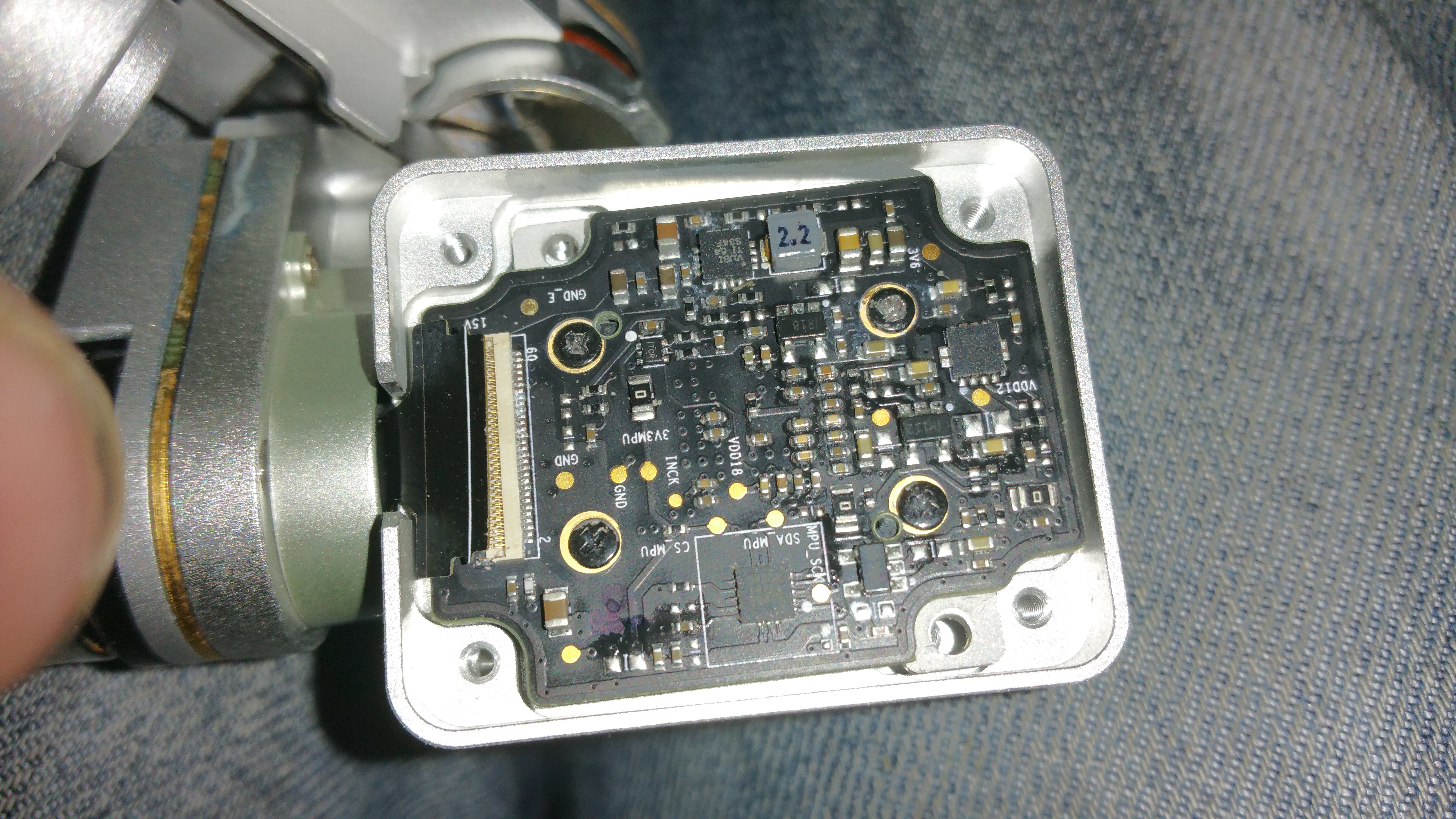

It's a ***** trying to get the ribbon cable into the back of the camera. The brown clip has come off and nearly impossible to put back on View attachment 30041
I encountered popping the clip off multiple times on laptops. What I found works and it is difficult is get the cable in place place the plastic holding clip in place and push it tighly so its holding the ribbon cable in place. One drip of glue on the very ends of each side holding the clip in place at the centre. It has worked for me a good few times. Sadly you can really screw **** up if you get glue on the ribbon cable but if done right it will work.
