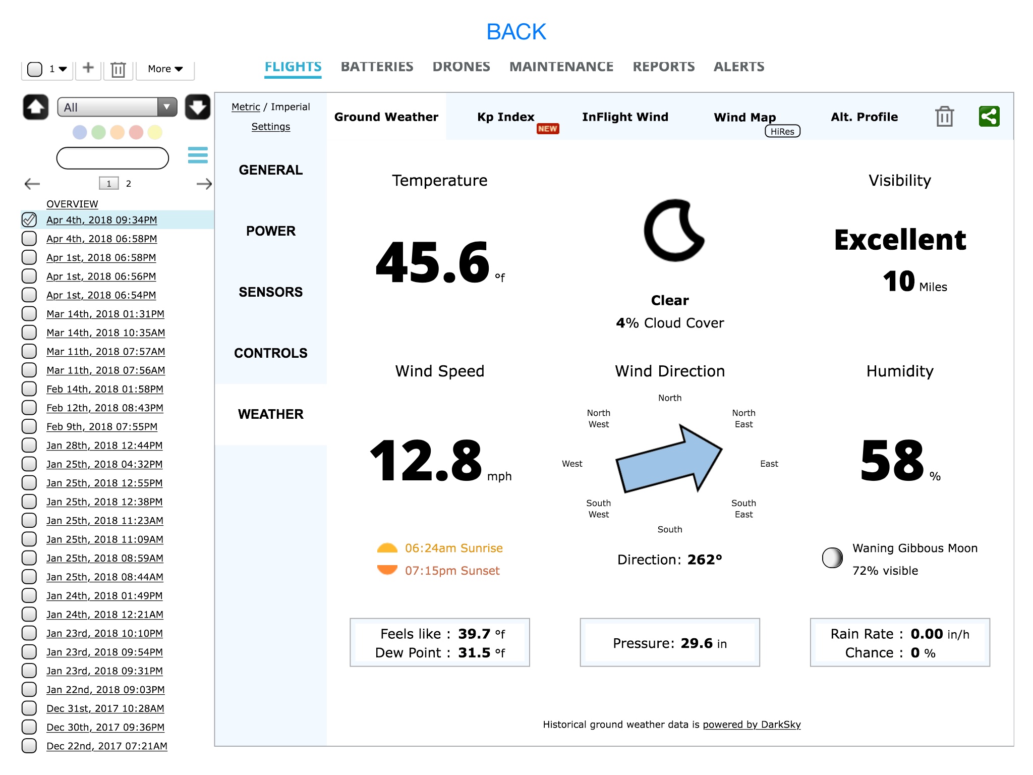

2. How were the winds? If there were significant winds, this is also not calculated into the estimated flight time.

This mission was defiantly pushing the limits and should not have attempted it at all . But I did. Wind speeds during flight at altitude shows a 18.7 mph NE WIND. And flight set to curved path.
The good news is that your basically flying over a green area 90% of that flight so no one would nick it. But it could be in a tree. Straight away I can see the problem with out the log. The wind was 18MPH you say? Usually it's recommended to not fly over 15MPH as the drone struggles to come back. Plus the height you was, most likely the wind was a stronger... Looking at around 30 MPH. also the timing of the mission.... I done a 14 min mission and the battery came back at 20%, so I am guessing yours went into automatic landing at 10% (but it should be near the home point) also when you uploaded the mission, was that before the props started spinning or was it in mid air? This makes a big difference as I done a test and when I hovered the drone, by the time the mission loaded it ate 6% of my battery. In the worse case scenario it may have had compass error causing a fly away. But I highly doubt that. I personally think the strong wind and long mission time basically killed the battery and forced it into an emergency landing. But as mentioned above.... We really need the tx log/CSV/ dat file before we can see what actually happened. At this point it's all guessing
Thanks guys work has been crazy I haven’t had access to my pc yet I’m trying tonight when I get home. But I took off hovered around 20 feet to make sure everything was working fine and connected. I also think the wind took it. I have searched several areas further out thinking it only made it back halfway. I’ve been reading and trying to figure out how much distance I will cover with the drone cruising at 25mph against that 18+ mph wind
