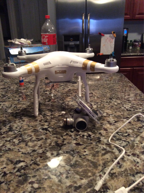

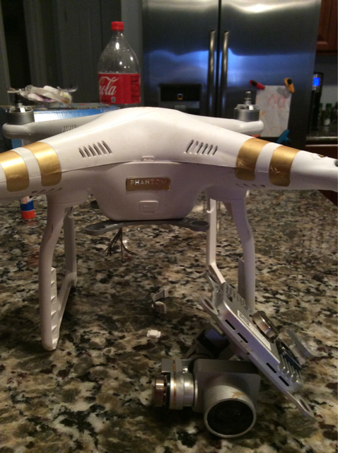

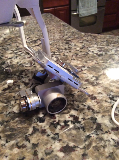

It's bad. Case is cracked I'm a few places. One motor is bad I'm sure. I think camera is ok. It did separate. The gimble mount is broke. Right now I'm really worried about the esc error I'm getting. How can I post pictures using an iPad. Do I need the phantom pilot app?

Maybe I think that is the battery error then made it crashed...so sad,I suggested that you need report to Dji in this case in order to deal with them
Thanks for the follow up. Hope the outcome is favorable. Keep us posted. Sorry you will now have to go through the grueling wait.
