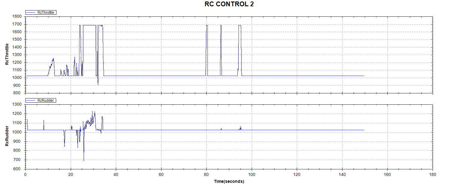

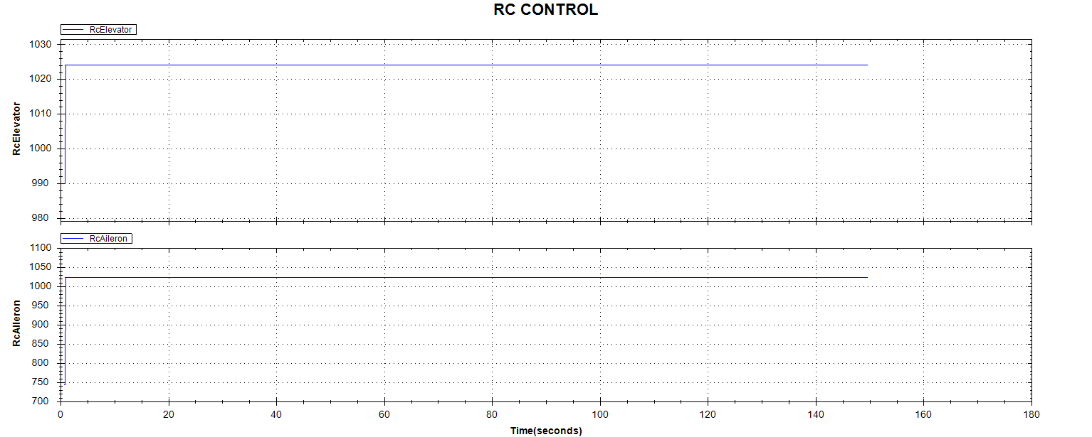

The OP never had a chance. The RC Pitch and Roll controls were completely unresponsive upon takeoff. Not even to mention the compass errors.
They were not unresponsive - they simply were not applied. The problem with the flight appears to have been a serious compass error at the start of the flight - the aircraft orientation was off by nearly 180°.
If you look at the yaw data, the aircraft heading was initialized at around 350°. After takeoff that heading changed to around 45° (NE) and the FC, detecting drift, applied positive (rearward) pitch. That should have resulted in the aircraft moving to the SW but, instead, it moves NE - indicating that it was actually facing SW. Still based on a yaw of NE, the FC applies even more positive pitch to attempt to correct the motion, but that just makes it worse. RTH doesn't work for the same reason and in the end it cannot resolve the compass errors, drops into ATTI and continues to drift away to the NE.
To add to my previous post - the appropriate corrective action would have been to switch immediately to ATTI, which would have stopped the incorrect attempts by the FC to correct for drift, and then fly it back. This was almost certainly due to severe magnetic interference at the launch site.
I say non-responsive, because they were basically at the "Zero" input point. If the op were applying both throttle and rudder, which were responding, I can't fathom to see how it is not possible for the OP, under duress at some point apply Aileron and Elevator. That just does not make sense to me. Would you agree with that statement?
