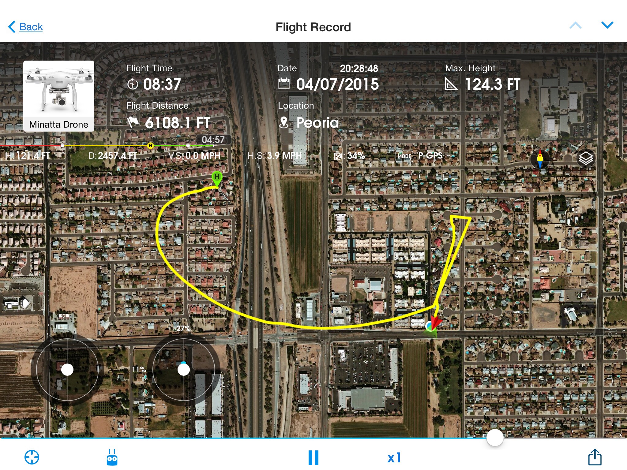

thanks, Frank. i appreciate your help. here is a summary of the events as i have been able to piece them together:
the a/c took off left as soon as it got to about 6' off the ground (it looks like i used auto takeoff according to the logs, but i don't remember). i had read enough in the forums to know that it was going to be uncontrollable at that point. i pushed the left stick to give it some height to make it over some two story houses and anything else in the neighborhood (all other attempts to control the a/c failed), and then i hit RTH in the hopes that it would bring it home. it didn't, but it did stop the a/c from going left, rotated it to face home, and then begin to fly right at a high rate of speed (i believe i saw 57 mph on my screen). it flew almost a mile before i lost contact with it. i thought all was lost, so i jumped in the car and headed to the last known location to gather the scraps. it was at that spot that my controller reconnected with the a/c, and it appeared to begin to head home at that point. i cancelled the RTH and flew it back to me and landed it. after looking at the flight data from the controller, it looks like it drifted a hundred feet or so once i lost connection to it.
there are some pics of the flight path as well as a video of it in this thread somewhere. i don't have them here at work, or i would reupload them to this post.
Here is a screenshot of the flight. Weird thing is the straight leg at the end of the curl shows as an instant jump from one spot to the next (several hundred feet ) when watching the replay. The arc begins near home because I had hit RTH. It just turned toward home and then flew sideways the rest of the arc while pointing home.View attachment 23929
There's that half moon arc again! Every fly away that I've seen a track of, has that half moon shape. Not sure what it means but someone at DJI must know.

Yeah I sure did. You did not calibrate the compass, the gimbal, or the R/C, after the IMU calibration. That's why when the Auto Lift and Land was activated, the a/c did not know where it in order to know what to do. Next time don't watch it fly away. Flip the Mode Switch on Upper Leftside of the R/C to the Middle and fly it back, or set it down if it is windy because there is no gps to help assist with stability.
