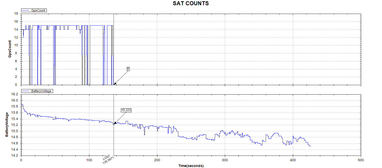

I agree with @LarBear360 . This is not typical at all. From this it appears to be either a faulty connection, and/or a bad GPS antenna. The intermittency noted until complete loss would point to something similar. As for your original question non re-creating the flight path, this can be done but with great difficulty. Really the only way IMO would be to use the Yaw, Speed and Altitude data to very roughly simulate this. However, being the fact that you were flying in ATTI and all over the place in direction, heading, speed, altitude and other categories this would take some time to figure out even a rough location. Even then it would only be a WAG. Below is a chart of your GPS loss. Still looking at the other data. But I do have a question. When you lost GPS completely at approx 2:15 seconds and only 120ft away at only 63 feet in altitude, why did you not simply quickly lose altitude. You could (And should) have landed immediately. Included with the chart is the GPS loss point.

The short answer is that it was out of sight a few seconds later heading west from the house. I was trying to get it back to land it rather than thinking about just forcing it down regardless of the condition. In hindsight, I can repair a crashed drone easier than a missing one.

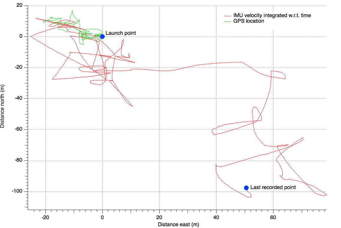

It's relatively straightforward to use the IMU velocity data to determine position - you just integrate the Vx (north) and Vy (east) velocity components with respect to time. The complication is that without any GPS data the sensor fusion scheme that corrects for accelerometer and rate gyro drift and bias has no absolute data to work with, and so the errors will accumulate, in this case for the final 291 s of the flight. That aside, the IMU data yield the following position data when integrated, with the GPS location data for the first 135 s of the flight included (in green) for comparison:

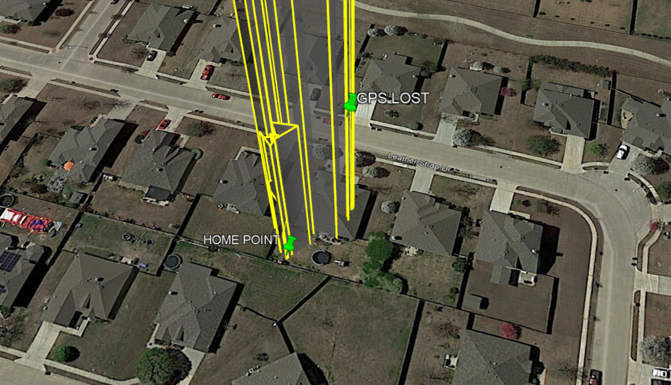

The GPS data are poor even for the first part of the flight, hence the somewhat tepid agreement even then. If we ignore the unknown accumulated bias and drift errors, the final recorded point is 98 m south and 51 m east of the home point. On the ground that shows as:

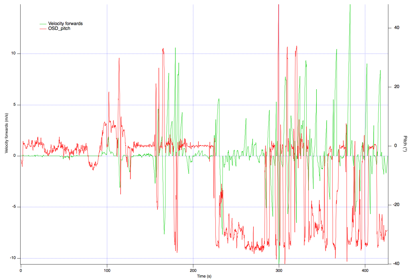

As a sanity check, transforming the frame of reference to convert Vx and Vy to velocity forwards and right with respect to the aircraft, and comparing velocity forwards with pitch (should be inversely correlated), we get:
That has some obvious issues, especially between 200 and 300 s where the significant negative pitch is not producing much of a forwards velocity, so I'm not sure how much we can trust the IMU velocities once sensor fusion failed. Probably worth a look though.
