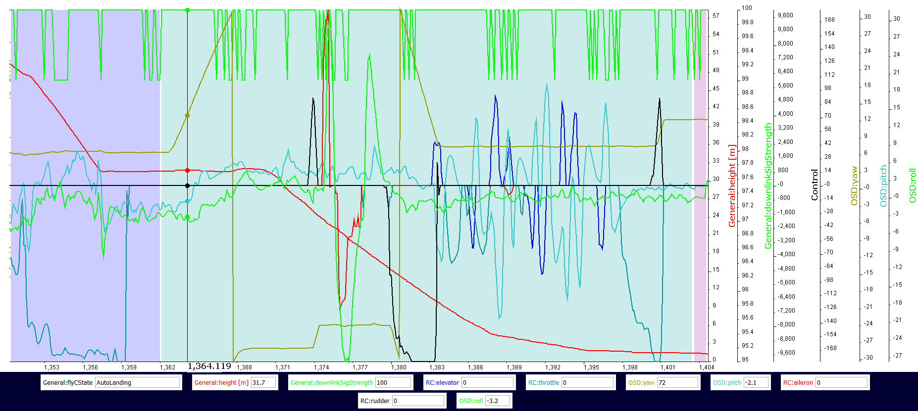

I uploaded your log here.
DJI Flight Log Viewer | Phantom Help
Here is your flight.
Look at 13m 46s
Should be your answer.
You should have had a status on your tablet and you should be able to replay play your flight in DJI-Go.

It was set to orbit poi at 13:46... it orbited fine. I don’t see loss of control?? I see later many 0 seconds of movement... right before I hit rth stick inputs did nothing to drone.??

After poi I was over the house and all inputs stopped working.. it just sat there.. no up,dn left or right. I figured it disconnected and might reconnect, in past even when disconnected I still could fly it with controls.... this time not... I finally hit rth and it did.. I don’t see any loss of gps. Air data not showing and sensor issues of signal errors.
Yeah, I see at:
22m 3.6s
Is when control movements stopped.
Rod
So why? God signal is good throughout flight? I have unsubstantiated guesses?
According to the data, the aircraft was responding correctly to ALL of your inputs after the POI and during. I see nothing that indicates an issue whatsoever.

Better to think again what you were doing as the done works as it should. No issue as Fly Dawg said.
