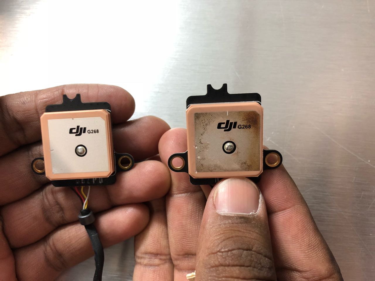

Hi all,
Just to update everyone. I bought a replacement GPS module with shell as suggested above. It was a bit of a task opening up the P4 pro but i got through. Turns out the GPS module seemed like it was burnt had some brown marks on it (as shown by image below, old module on the right.)
I have been using the P4 pro for doing some mapping with way points, so maybe i pushed it too hard?

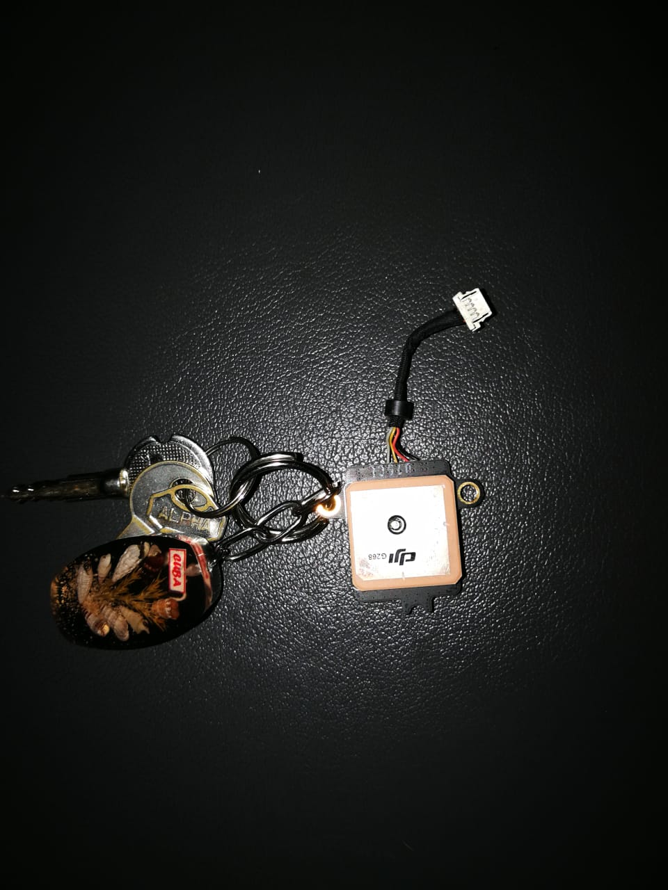

After i swapped out the bad module everything works like it did before. I kept the old module as a souvenir and turned it into a key chain.
Hope this helps anyone with a similar problem.
