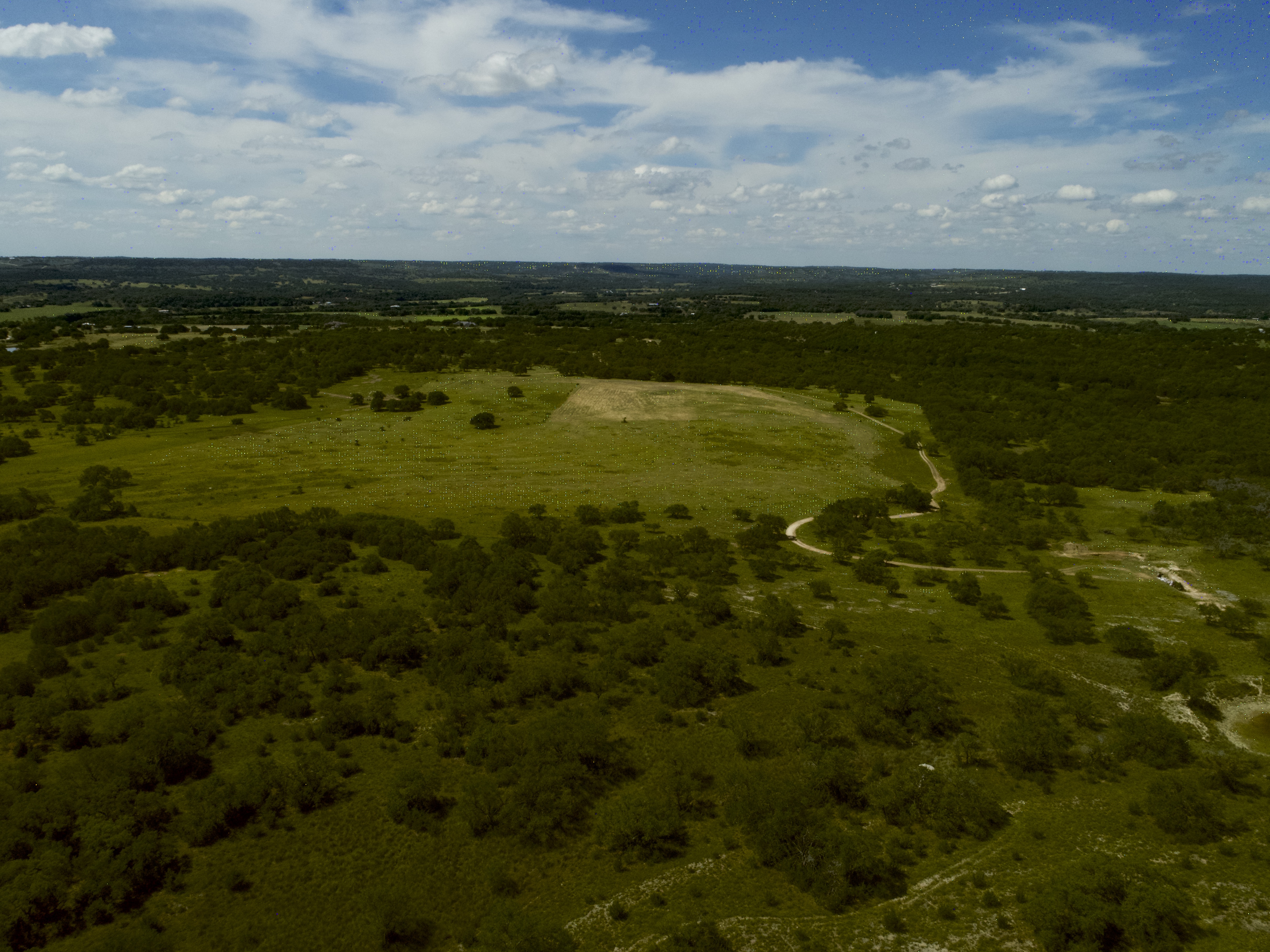

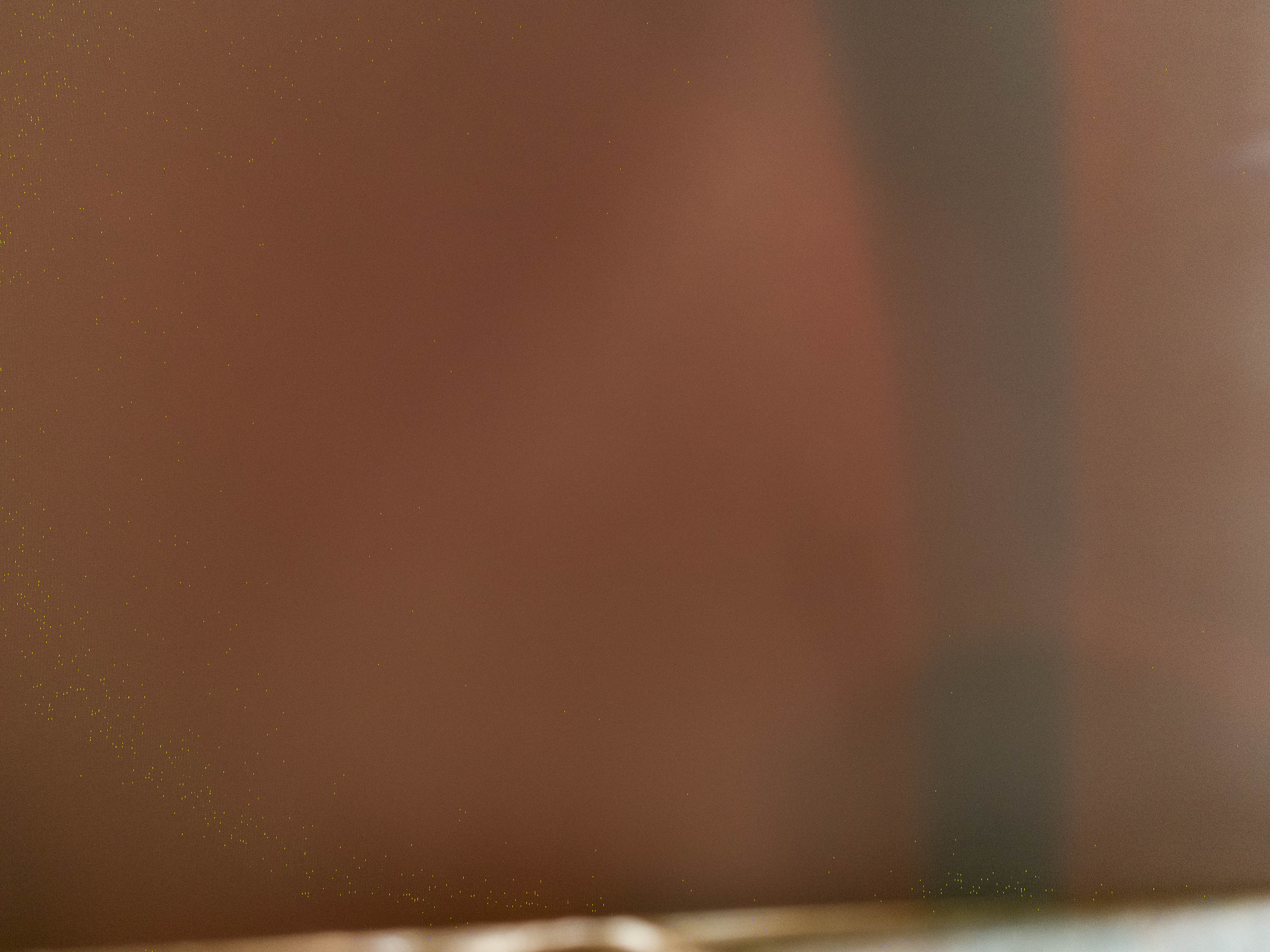

Can anyone tell me what is causing all these little dots in my pictures on a Phantom 4 Pro+. It just started recently. Here is a pictures demonstrating the issue.
Seems like a few times per year someone posts with a similar issue. I don’t know if a root cause has been definitively determined. Often a ribbon cable, sensor, or overheating are mentioned, but most suspect a ribbon cable.

I am challenged by this issue often and have resolved it with a ribbon cable replacement. For some reason, ribbon cables degrade over time. Must be a combination of sun, heat, moisture, all of which can negatively effect the ribbon material.
