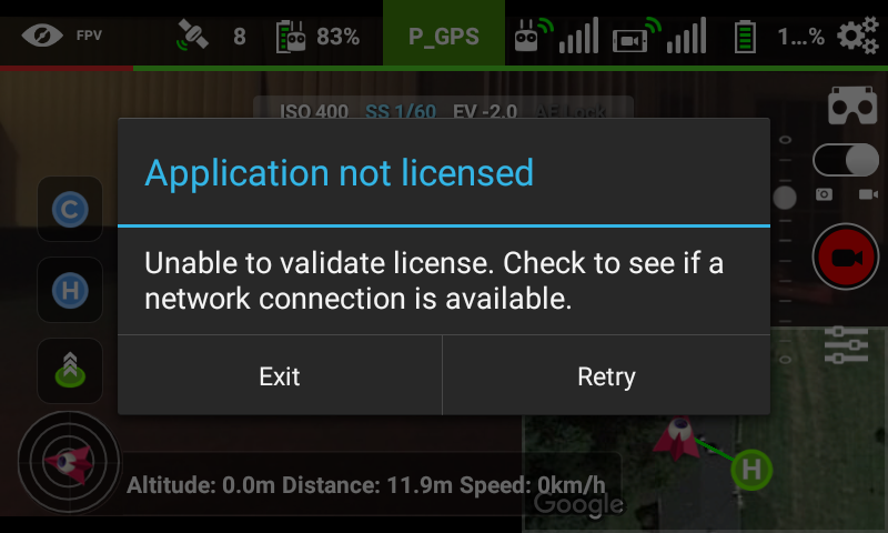

Ok thats what I was thinking because the other way is a lot of trouble and not user friendly at all. I didn't get the notice again until today about APPLICATION NOT LICENSED....I switched over to my home network and i'm guessing it connected....Went back and flew it for about 5 minutes in the front yard for the first time....Is it safe to be flying get the APPLICATION NOT LICENSED error ???? wanna try a mission ;)
I have read your posts about how you acquired the Litchi software and some of the issues that you have had, and I am a bit confused. I think that acquiring this software any way other than downloading it from the proper source (either for iOS or Android) would not be recommended. For what Litchi offers, it is very cheap in my opinion, and I would never consider trusting my system to anything but properly downloaded and licensed software. In no way meant to be a judgement, but rather solid advice for a fellow enthusiast.
