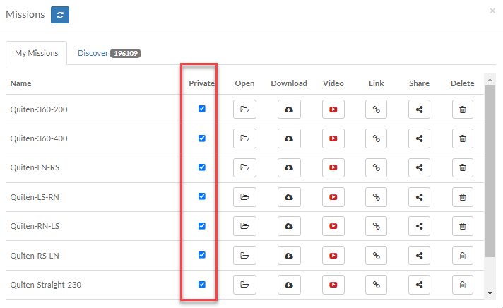

If you're using Litichi mission hub, uncheck "private" and send me the link to the mission. I';ll gladly take a look at it

How do I do that. I see the share widget but how do I send it to you?
From the Litchi mission hub, click "Missions" then "open" a window will open that shows your saved missions. Uncheck "private" to the mission you're talking about.

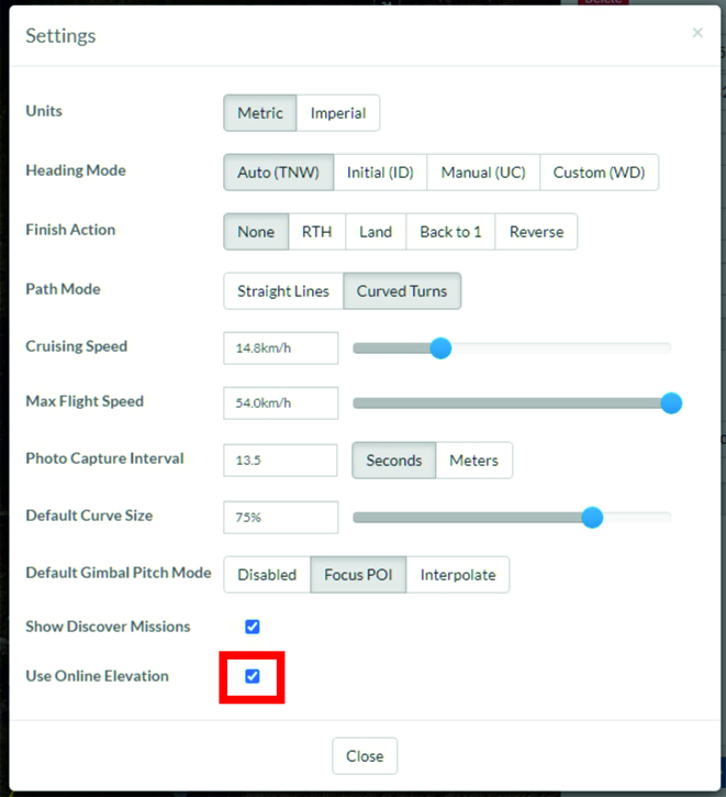

At WP3 grondlevel is 12m (40ft) higher than at WP1.
So at WP3 your drone will be flying 12m lower to the ground.
Also there's a 4m height difference between the start and end of your driveway.
The heights you set at all waypoints are relative to the take-off point, NOT WP1 !!
If you want to set your heights at (all) waypoints relative to ground:
1. In Settings check "Use Online Elevation".
2. In (all) waypoint settings check "Above Ground" directly under "Altitude"
The P4P will fly over obstacles when the obstacle is big and DENSE enough.
I strongly suggest reading the online Litchi-Manual.
