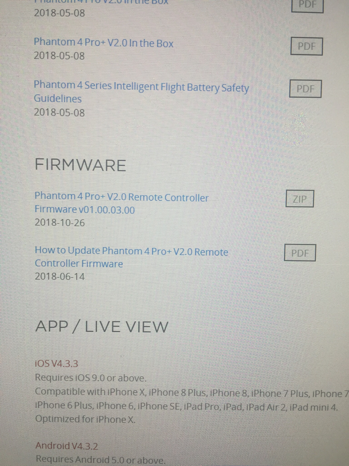

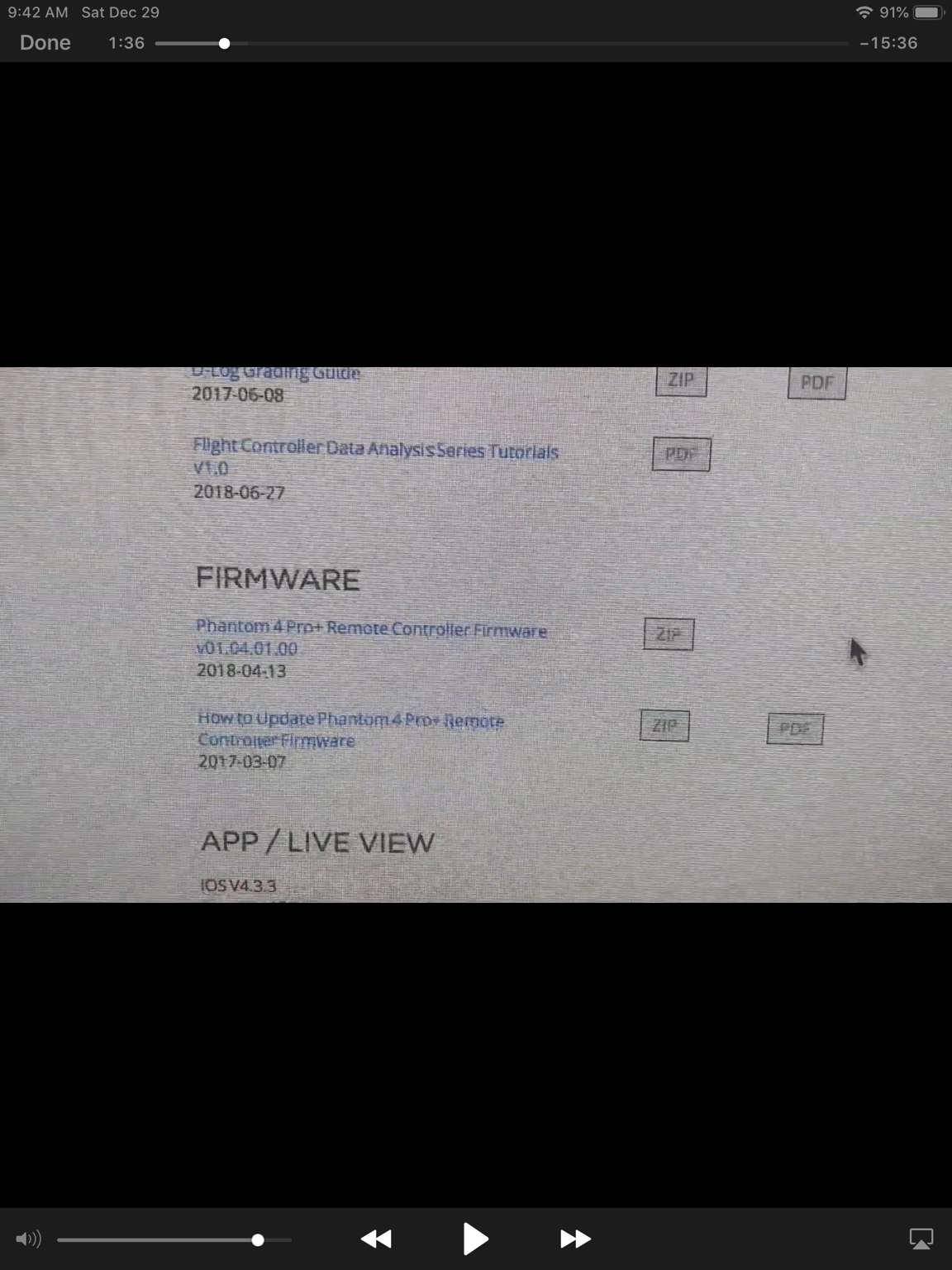

I followed your steps and still no pop up giving options. Went and checked CS firmware version and saw V01.00.01.00, went to DJI to get latest FW and this is what I got
Lower FW version # then what you saw
Even though the date on the lower version is more current than the newer version you got.
Downloaded new v01.00.03.00 put in CS installed it, got the upgrade success then went to check and saw I still had the old version installed. Think this may be why I’m not getting options.
Still don’t understand why you’re shown a higher v# with older date then the one I got with lower v# with more current date.
Please send link of page with the v# you got to see if I can go that route, otherwise I’m going to have to contact DJI and ask WTF is going on here.
Thanks for your help!
This is the Link I used , Phantom 4 Pro Plus
DJI Phantom 4 Pro – Specs, Tutorials & Guides – DJI

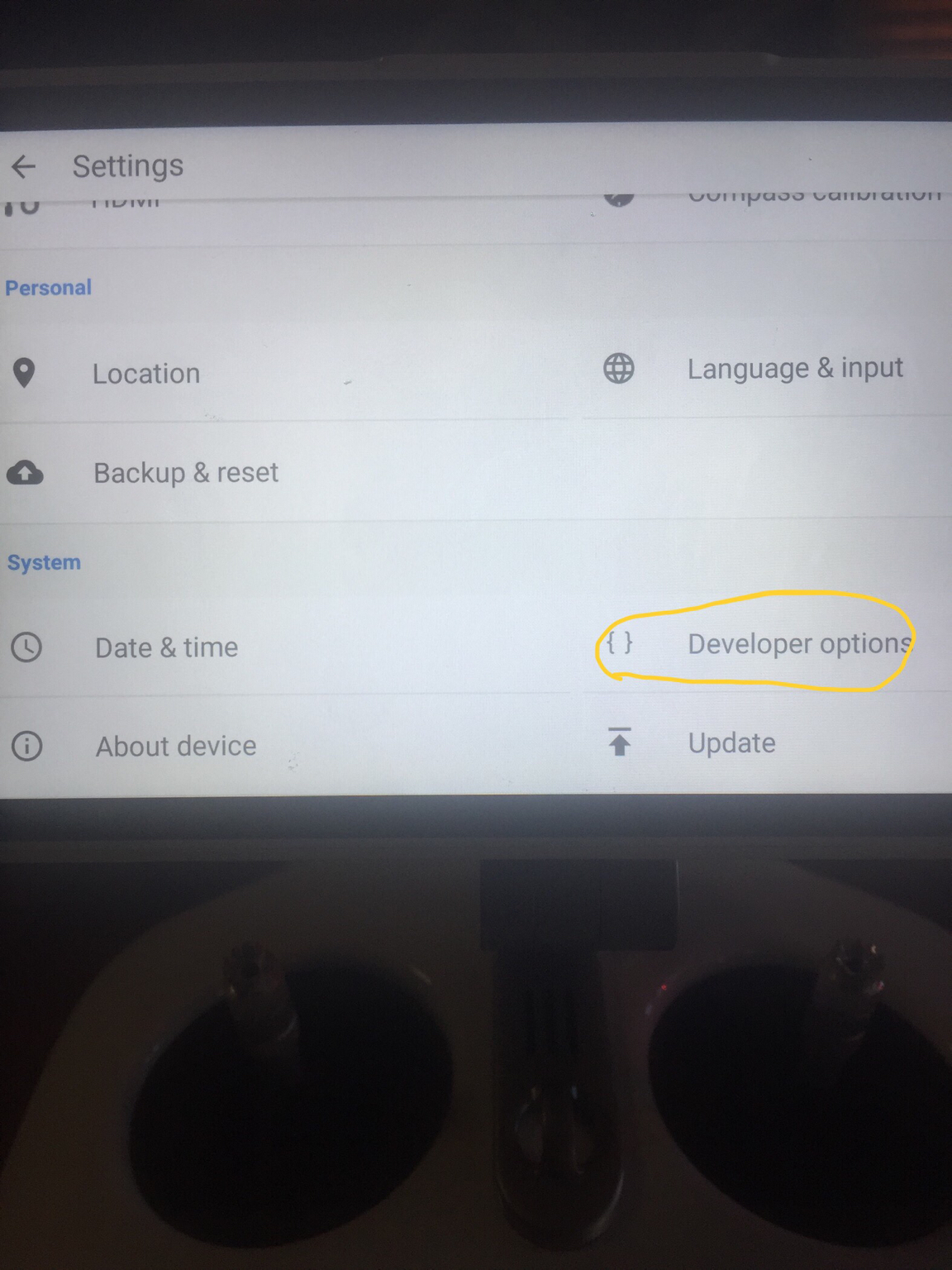

Is there a setting on the DJI that you have to check to use the third party apps maybe. ?
I went to settings-system settings-About device-System version and clicked on it about 5 or 6 times and I got developer status
I am not real knowledgeable in these matters so if anyone with GL300K with same issue and knowledgeable could get Litchi to work properly please shine some light and would very mush appreciated.
