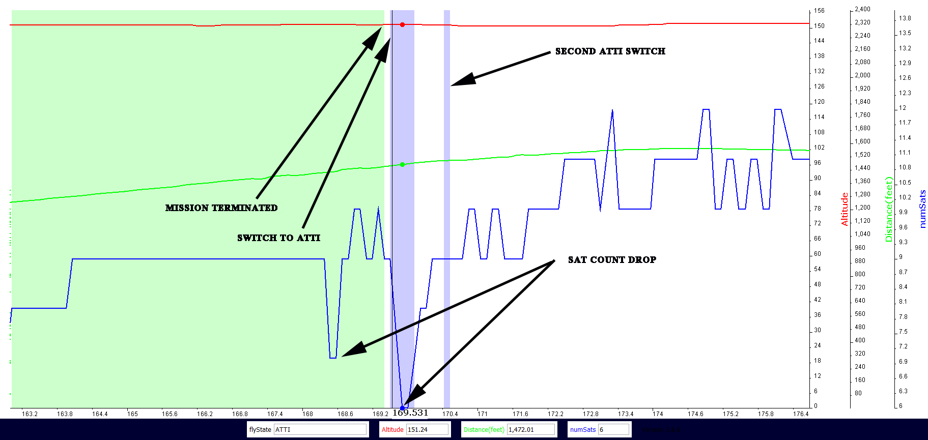

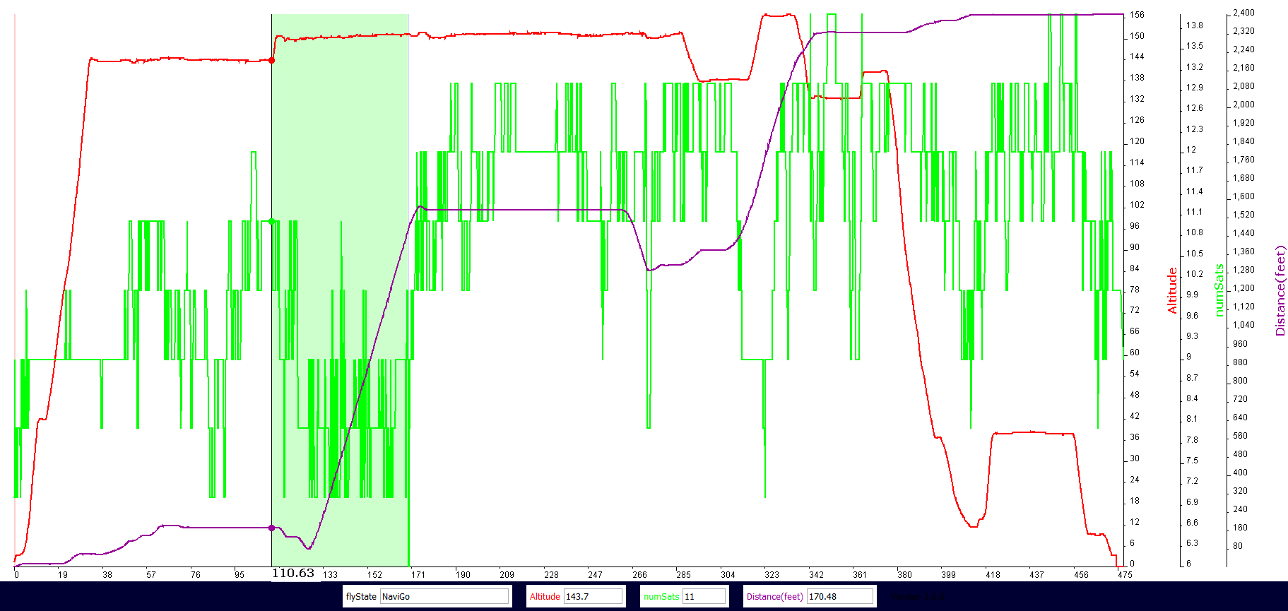

Your mission did load and begin, however as you mentioned terminated itself. Without much more data to go by and unfortunately, I love Litchi operationally wise, however their log files are extremely lacking in detail as DJI GO includes. That being said, I am going to take an educated guess and suggest that you lost GPS lock at some point. That will terminate the mission. The only data to go by is the numsats in the Litchi log which were quite low during the mission time and the fact that there was a very brief switch to ATTI immediately after the mission terminated. If you are interested to know for certain, we would need to see the aircraft .dat log.

@BlueVista If you were curious as to why I suspect a loss of GPS lock. Here is a closer view of the Litchi data. Again, nothing conclusive as we would need the .dat file to verify, but you can see from this the mission termination and 2 brief switches to ATTI which to me would indicate a loss of GPS lock.

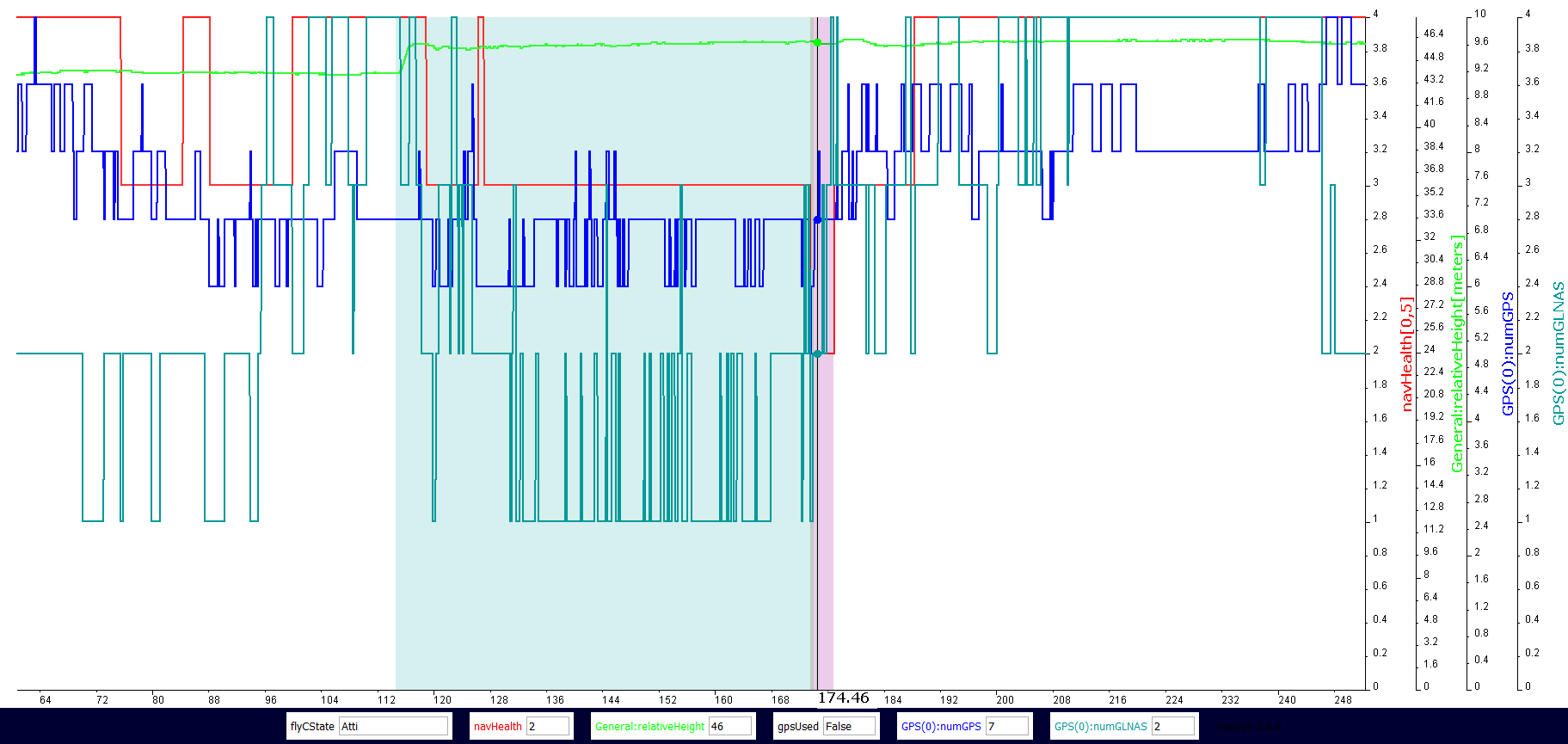

That certainly looks like a cause and effect. But, just to put a nail in it, here's a link to the *.dat file...

It is indeed it appears. First you navhealth was really bad from takeoff. ( Red Plot ) Generally speaking, when the navhealth goes below 4, the aircraft will switch to ATTI. In your case, it dropped out at a navhealth of 3. Oddity is that the entire mission was at a 3, until the switch and it dropped farther.
The Green area shows the mission. The Pinkest area shows where the aircraft switched to ATTI which terminates a mission.
