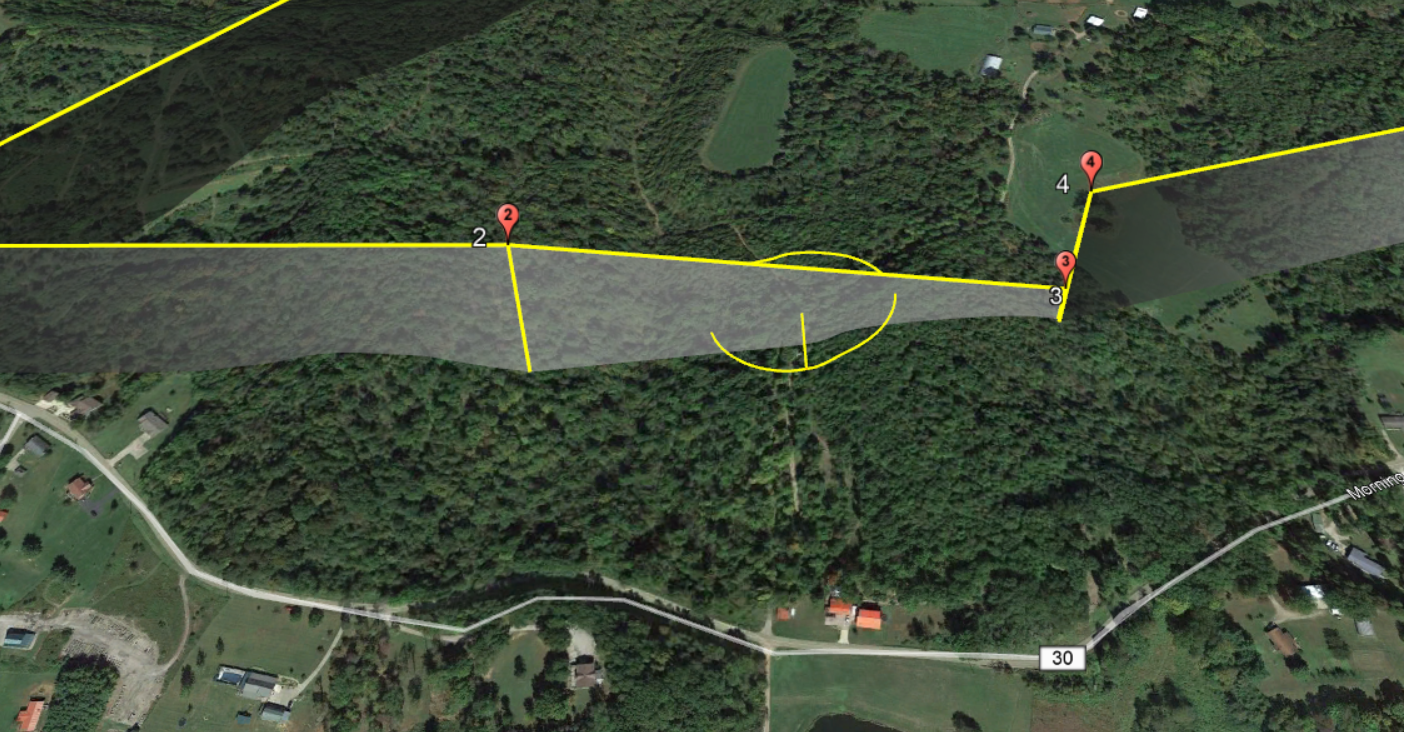

Waypoint 3 obviously was an accidental addition. 30meters is the "default" waypoint altitude and was never changed. The above posted altitude graph is quite crude and not very accurate, but none the less that is close to correct. Looking at the image below, I suggest that the AC hit the trees far before it ever reached Waypoint 3. According to the profile there is a 45 degree incline before Waypoint 3. Most likely the AC will be found within the yellow circle below.
Question, if this was a P4P, would obstacle avoidance prevented this disaster?
This is the best ever promotion for the Obstacle Avoidance System built into DJI’s P4P !
Thanks @bsartist
Maybe, maybe not. OA is not an exact science. Especially true with trees. Most "surfaces" can be detected and avoided, but trees are a bit different due to the intermittency of the foliage. With no foliage, you can pretty much count out any OA, it will not see the smaller bare branches at all, there is just not enough surface area to detect. With full foliage, it may or may not.
