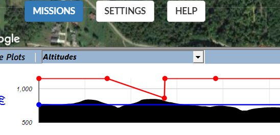

Mission Hub - Litchi
Sorry to tell you but WP3 is set to 98ft...right where the ground increases significantly in altitude. I suspect that is where you are going to find your drone.
Reactions: umanbean
Sorry to tell you but WP3 is set to 98ft...right where the ground increases significantly in altitude. I suspect that is where you are going to find your drone. View attachment 104739

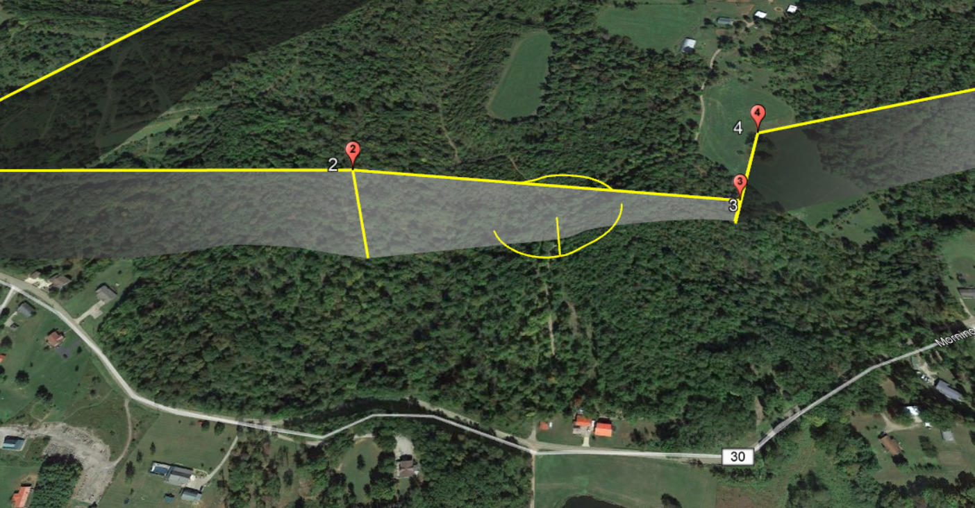

Waypoint 3 obviously was an accidental addition. 30meters is the "default" waypoint altitude and was never changed. The above posted altitude graph is quite crude and not very accurate, but none the less that is close to correct. Looking at the image below, I suggest that the AC hit the trees far before it ever reached Waypoint 3. According to the profile there is a 45 degree incline before Waypoint 3. Most likely the AC will be found within the yellow circle below.

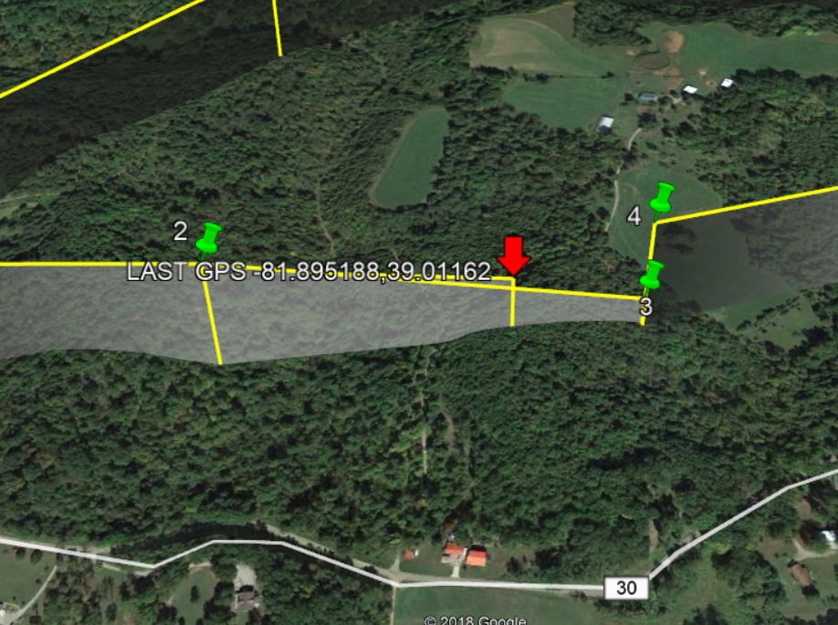

The Last recorded GPS Point is here:
