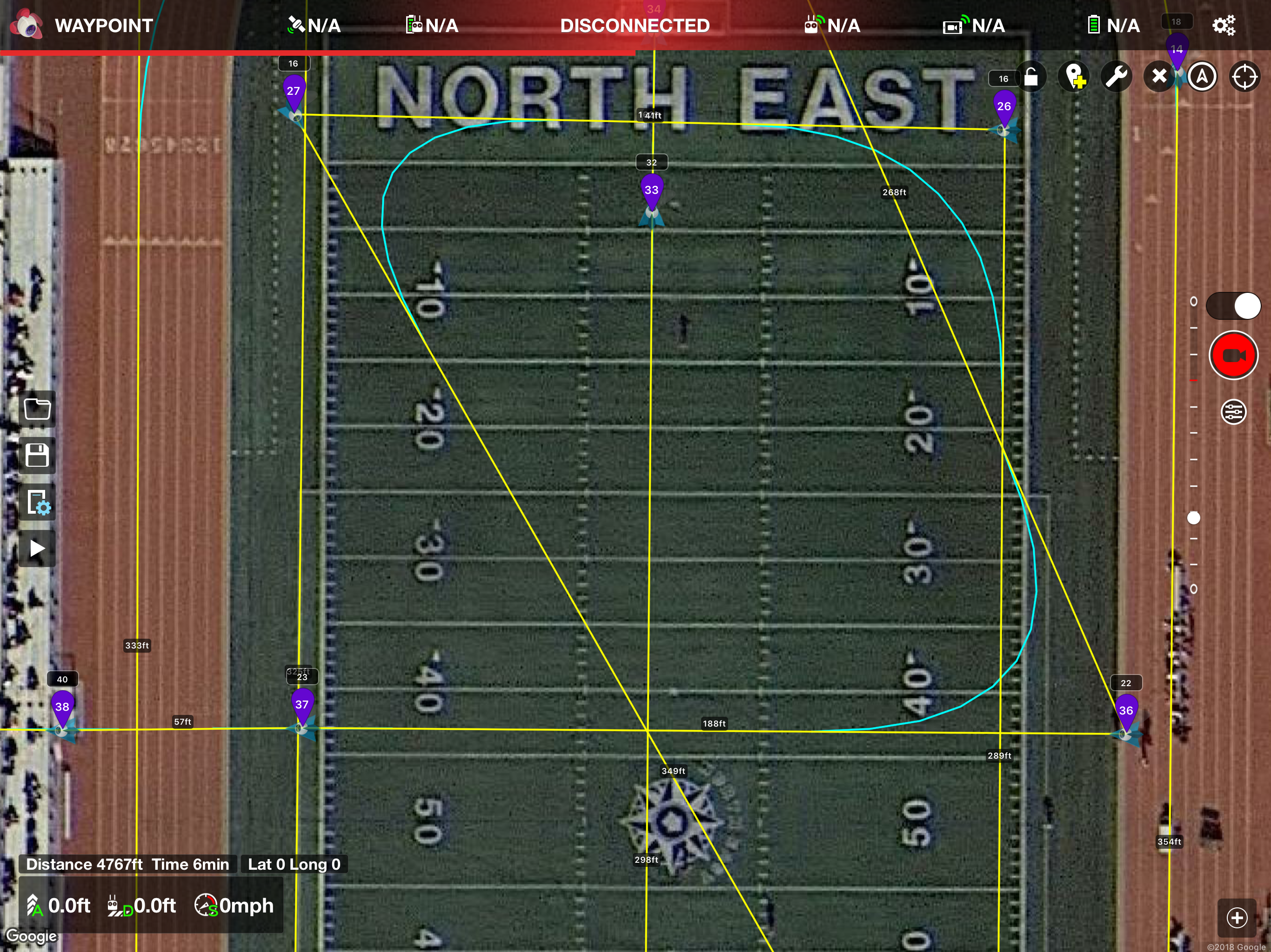

I’ve created some missions by flying a route and creating waypoints as I go for later use. When pulling the mission into Litch mission hub or into the app, I’ve noticed the map is offset by amount 3 meters.
Is there a datum issue that I can fix?
I’m not comfortable creating a mission in Litchi as I need to take to offset into consideration each time. This issue has been there for the last few versions of the app. I’m just getting around to asking about this.

See attached image from my iPad. Pay attention to the sides of the football field. I flew directly down the sideline but from here you can see that it is off.
I'm not sure I can see any indication of where you flew from that.
I see the intended course you laid out (yellow lines) between the waypoints and the blue curved lines are the curved corners that Litchi has plotted for a smooth flight.
What am I missing?
Is it possible you're misunderstanding the lines as @Meta4 has eluded to? The mission hub doesn't show your exact flight path only the "programmed" points. You'd have to find a way to import your flight data into Google Earth Pro and then your could overlay the Litchi Flight over that and make subtle adjustments as needed.
If you want precise (as precise as hobby grade components can be) corners you'll want to turn off "Curves" but remember those "smooth out" the flight a great deal.
