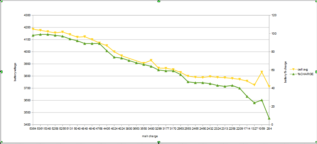

    So. No one sent me data on their batteries as reports by assistant, so I have had to use only my batts... ok... I now enough data to show a trend and make some comments.....
    Here is a chart of some of my data, showing cell voltage vs percent charge reported by dji, vs mah capacity.
    Obviously the one blue point off the trend is bad data - maybe I wrote that point down wrong.
    But it is interesting to just stand back and look at this data......
    We all know that lipo batteries should have a curve like this:
    One major key to making a lipo battery live a long life is to NEVER go over the sharp edge at end of charge point. In this example curve, 3.6vdc. Go past that you do irrepairable damage to the cell.
    No stand back and look at the perecent charge djii shows us in assitant, on our cell phone FPV, and on the smart battery lites.... THEY GO WAY OVER THE AVALANCHE POINT! Go there and you make your possibly 300 charge cycle battery live 20-75 as folks typically get!
    DISCHARGE TO 8% AND KILL IT EACH TIME TOO!
    OK, in dji defense, they are not battery experts. But when they get enough feedbck from customers that discharging to 8% each 20 cycles is killing the life of the batteries, you would think they would ask their batt supplier for comment! Perhaps they could change their docs to stop telling to do this!
    More data is needed to make better curves. I will get that data in another couple years myself if no one ever sends me data to compile here. OK. I will help MY batts last a lot longer by not going below 30-40% charge on them.
    Keep in mind this curve is for unloaded batts: the voltage droop under 5-10-20-30amp flying load is an easy 0.5v more! You can see that actually FLYING at less than 30% or so on the batt lites is killing your batt life.
    More data will refine this, but if you want to believe this data or not is up to you. My opinion is anyone discharging below 25-35% as shown by dji is prematurely killing their batteries. Both mine have spent their life above that level except for that one test here, and check it out: after more than 20 charge cycles they both show MORE capacity than 5200mah new. You decide.
    If you feel like sending YOUR batt data from dji assistant, I will add it to this to get better curve.
  8. yorlik
    Feb 9, 2015
    571
    113
    another thought: it looks like the knee of the curve happens at what dji calls about 45% level; after that, the dji seems to drop %charge indication very fast.
    Hmmm... this sounds familiar to what foks are seeing? batt lasts well down to 50%, 40%, then it can drop in very short time causing RTH or landing on low battery.... hmmmm...

    thank you mike123.
    I added your points to the dji battery curve. I also spent 1.5 hours today charging a battery to fill in the blanks from previous 60-90% dji reported level:
    I am trying to identify what dji thinks is % charge left vs std lipo voltage levels....
    It is appearing their % charge vs lipo actual volts is a bit off; I am SURE it not that their engineer was drinking heavily when he coded it into the smart battery, but I do not understand YET why they have the big drop off in reported % charge in the 90-50% range. This does not jive - yet - with how lipos work.
    I am just trying to identify why some folks get this commonly reported "I was at 60% charge and all of a sudden it dropped to 20% and autolanded out in the field and I lost it...." It APPEARS on the surface that perhaps that engineer maybe WAS drinking that day he coded the curve?
    dji-dave - would you be willing to ASK about this for us?
    Perhaps I do not have enough data yet to make the real dji curve at both ends? It MAY be that great dip is ok but just at wrong point, and they really are keeping us above the killer low voltage knee... I do not have enough data yet to say for sure...
    I know of NO lipo battery curves that have such a knee from 90 to 60%: the chemical makup puts the knee below 25%...
    Please send YOUR battery data and I will add it to this curve so we can all understand better what the telemetry is telling us.

    so I have 38 data points now of %charge/voltage/mah - as reported by dji assitant - to make the dji 5200mah batt curve more accurate:
    It APPEARS when we get down to 40% charge that the %charge nose dives quickly. We really need more data points from folks filling this area in.
    What this seems to be telling us is the %charge left as indicated by batt and assistant is usable and good down to 40%. 40% of 5200 is 2000mah left. But something is missing in this description because it appears that last 2000mah is not really usable before the battery just dies FAST. This point on the battery curve should be about 10% left, not 40%. It should happen at 10% of 5200 or 520mah left, not this huge 2000mah left according to dji... I can't wrap my head around what is happening without more data. I refuse to run my good batteries down in this area so need data from others who have inadvertently or routinely DO run down to 30,20,10%.
    Still keeps pointing to you take your chances of a batt failure or autoland or batt dropping in seconds if you fly below about 40% left!
    consider sending your assistant data ($charge, batt voltage, & mah now) if you plug into assistant and capture a charge less than 40%.
