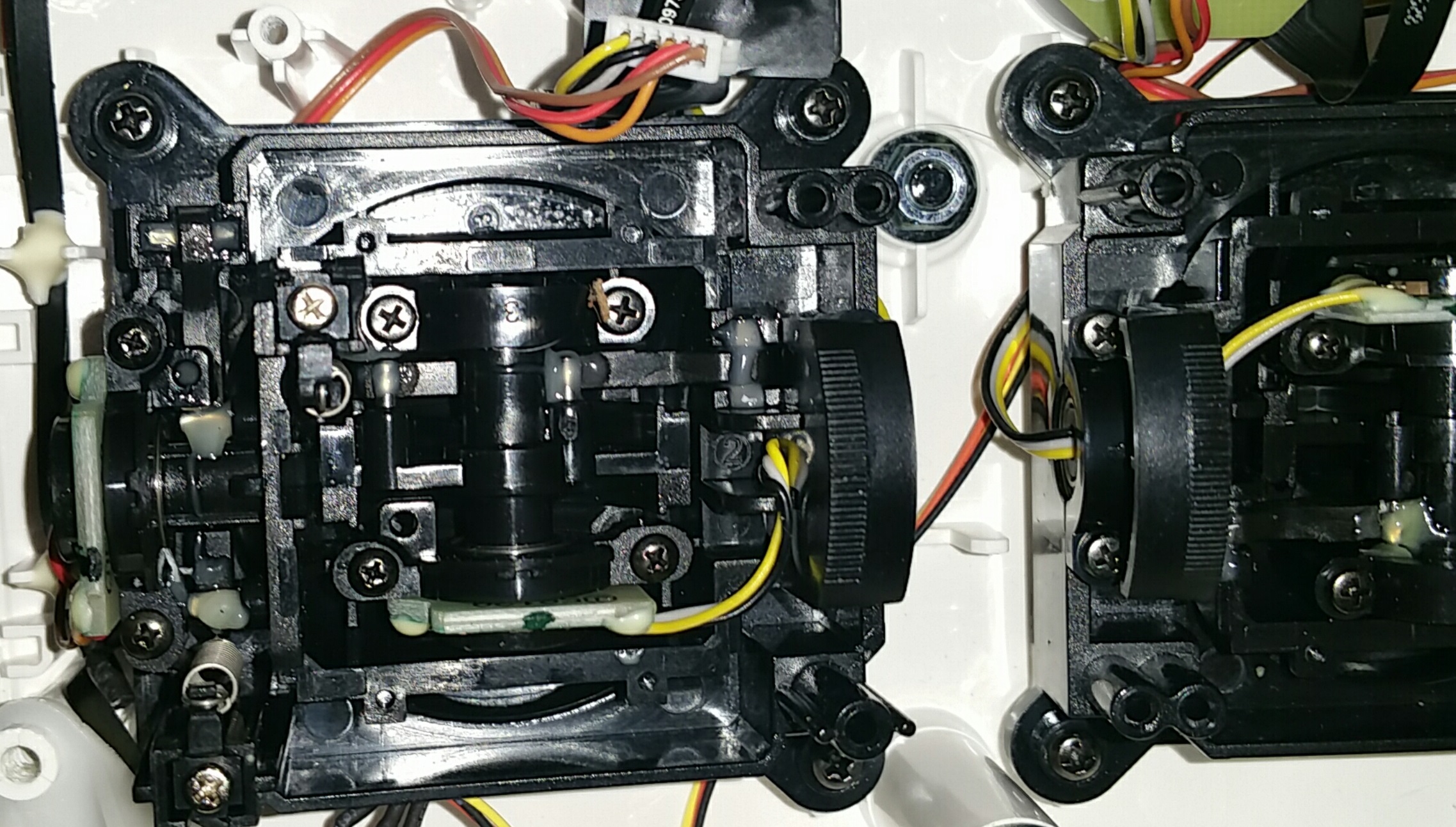

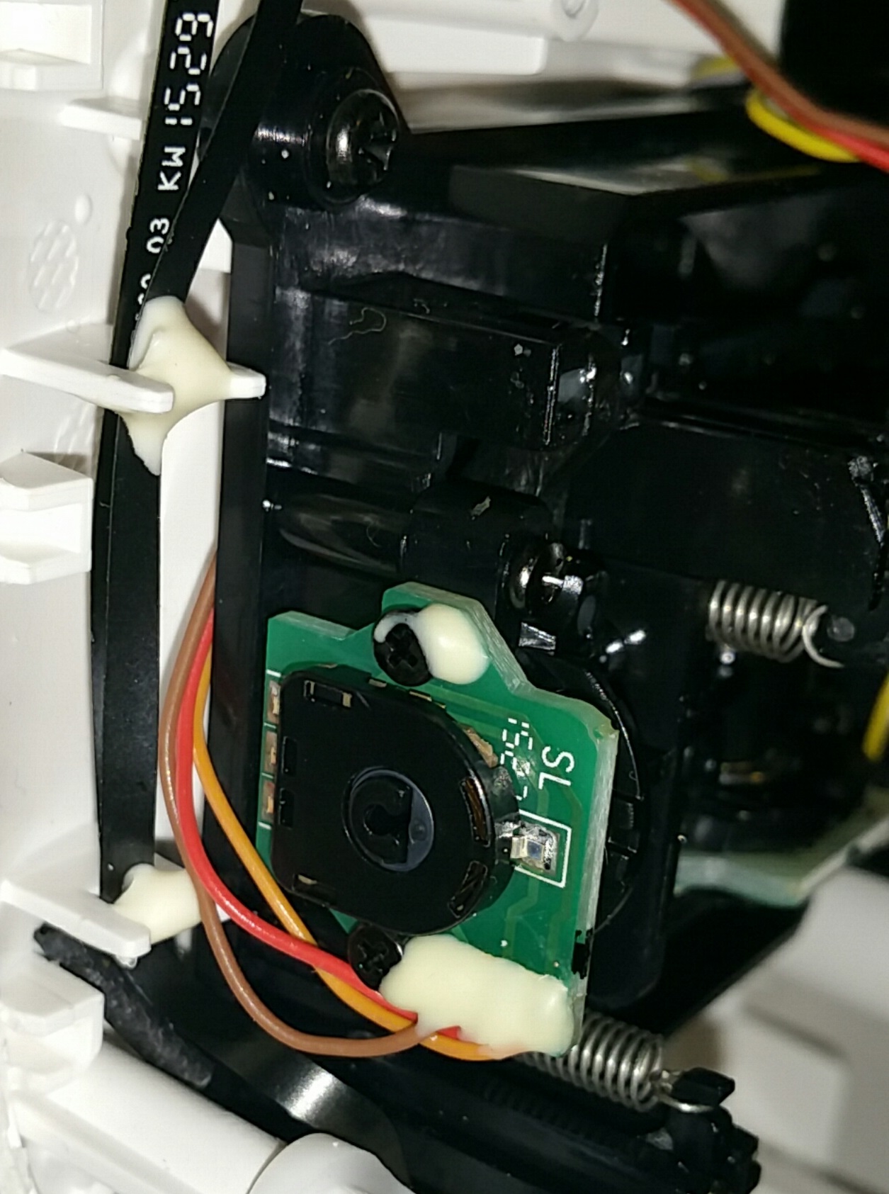

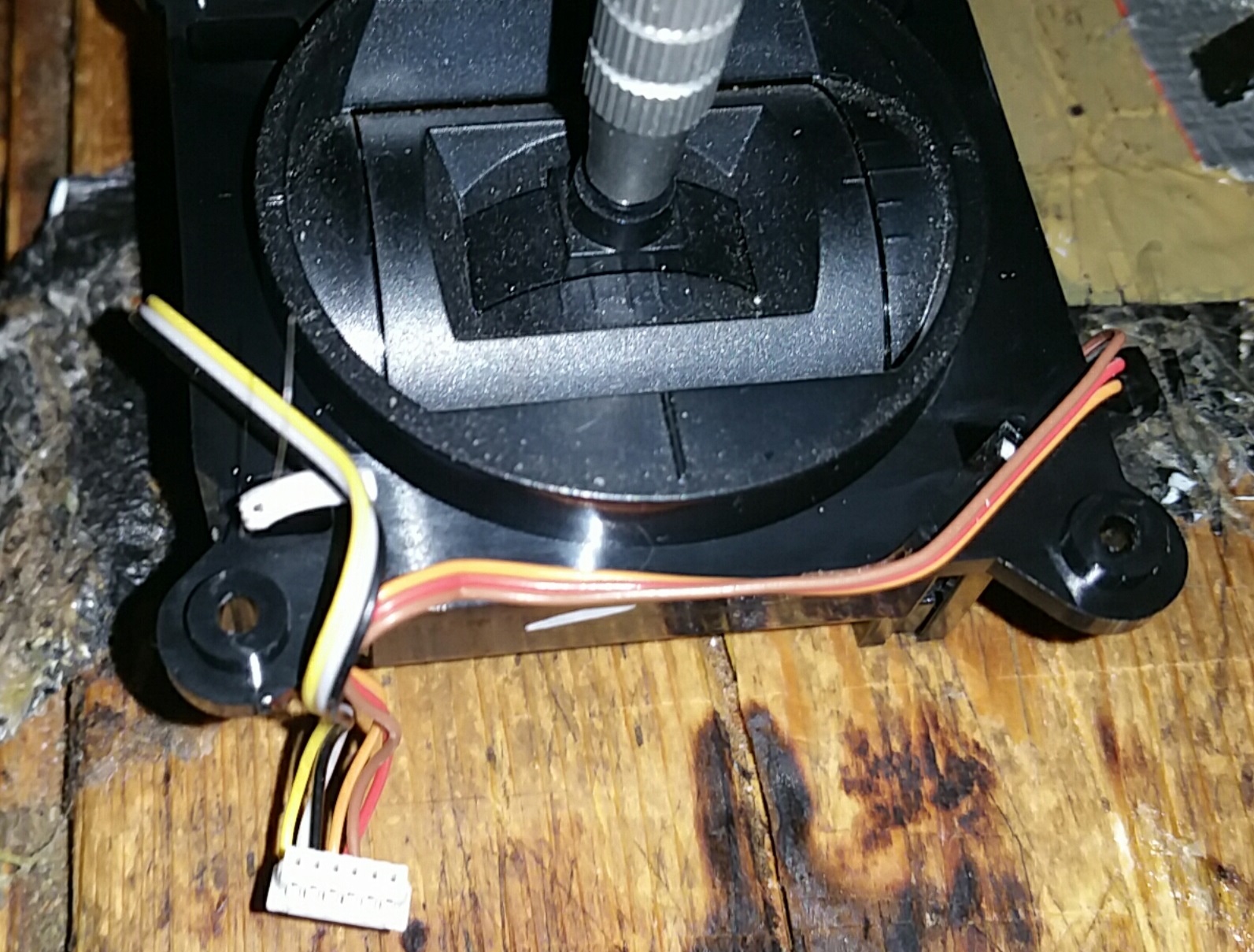

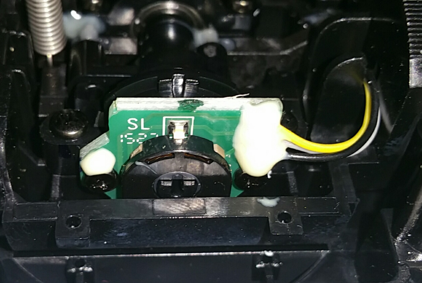

These are the joysticks in a GL300B but as far as I know they are interchangeable across the A, B, & C range and maybe even identical. I do not know if they are compatible with the C ver.b or is it ver.2.

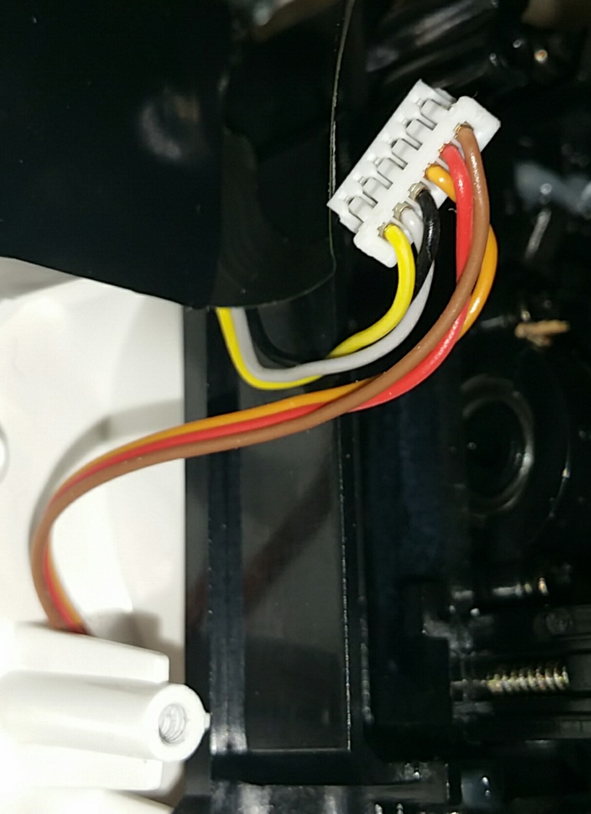

Also the joy sticks are not handed, i.e. can be used for both the left and right joystick, the wiring is bent to bring the connector to the mainboard.
The mainboard from this controller (which had a knackered shell) went into the shell of a GL300C that needed a mainboard (it was otherwise complete) and after calibrating the joysticks etc. it worked and works perfectly well.
