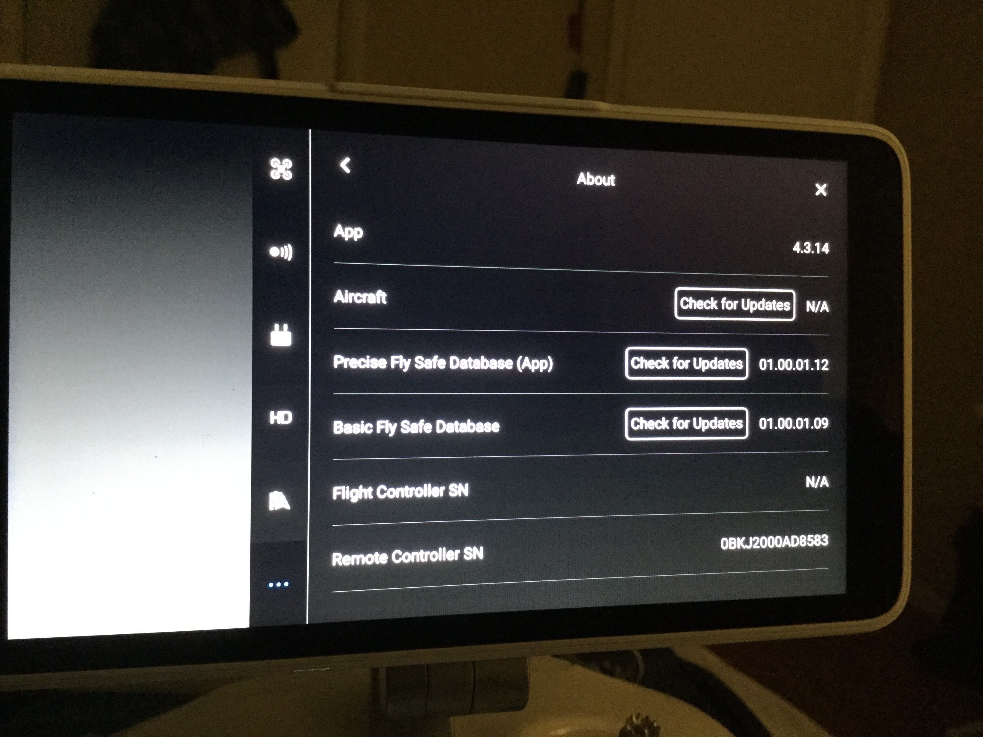

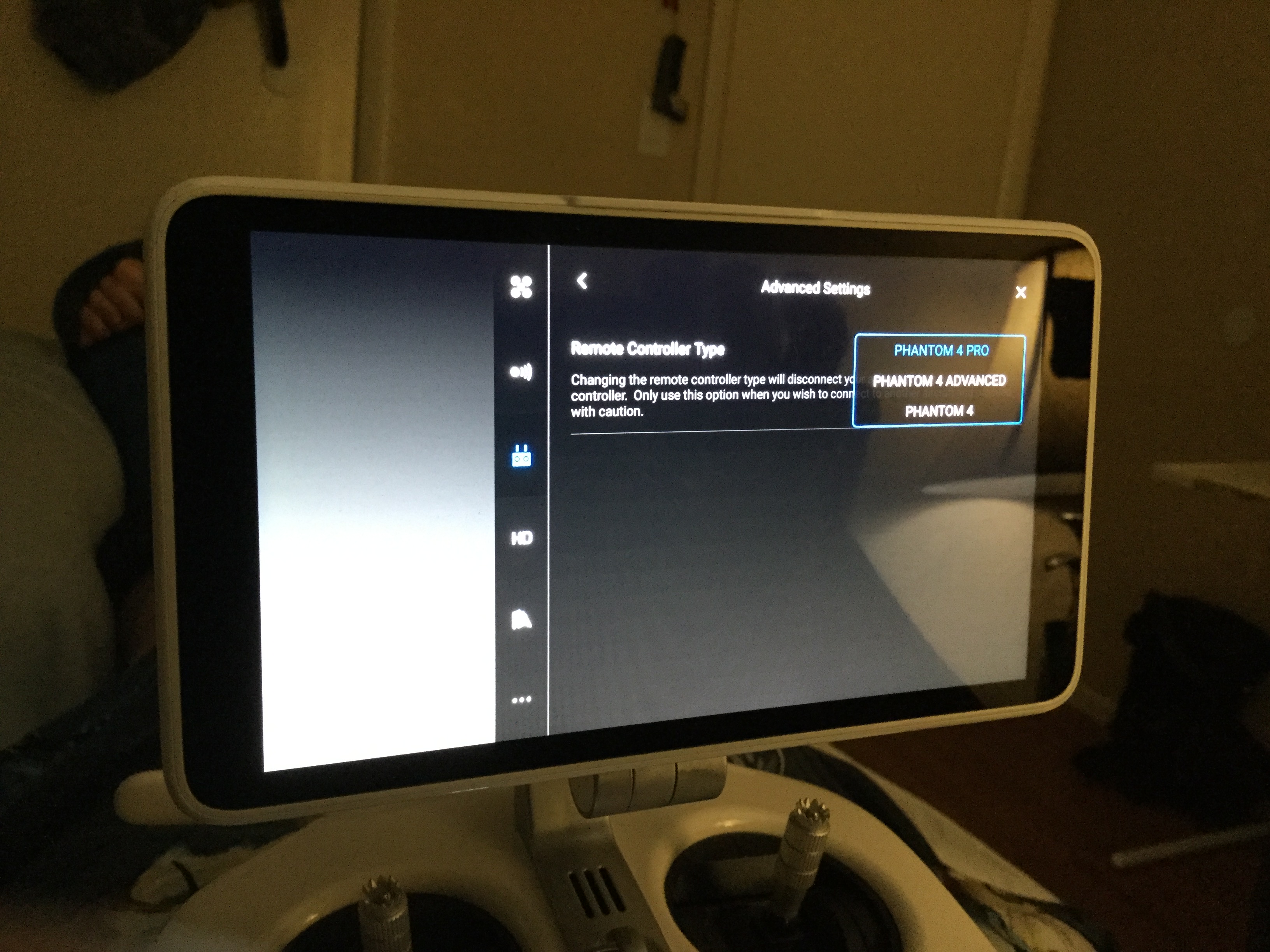

The newest remote firmware (2018) works fine. It also makes the 300E capable of operating all P4 V1 drones. Under advanced settings, all will be listed. If you do not show all 3, do an update. Doesn’t take long. Also update Go 4 if it asks. Nice improvement. I just keep the firmware update on an SD card for a quick use. You do not need to update the AC at the same time.

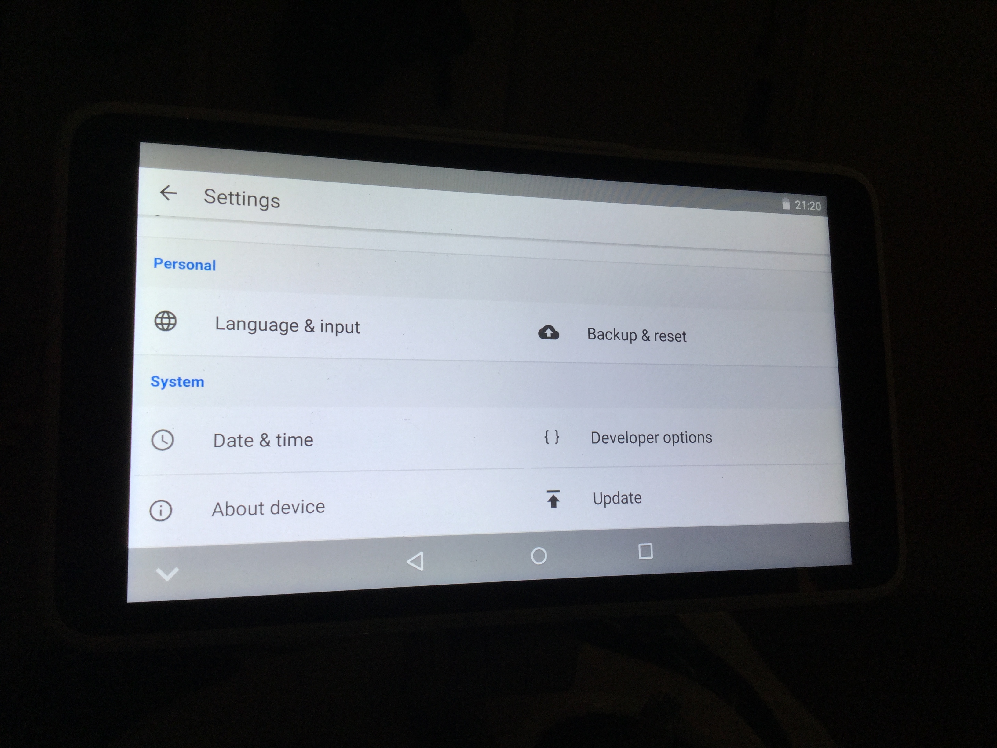

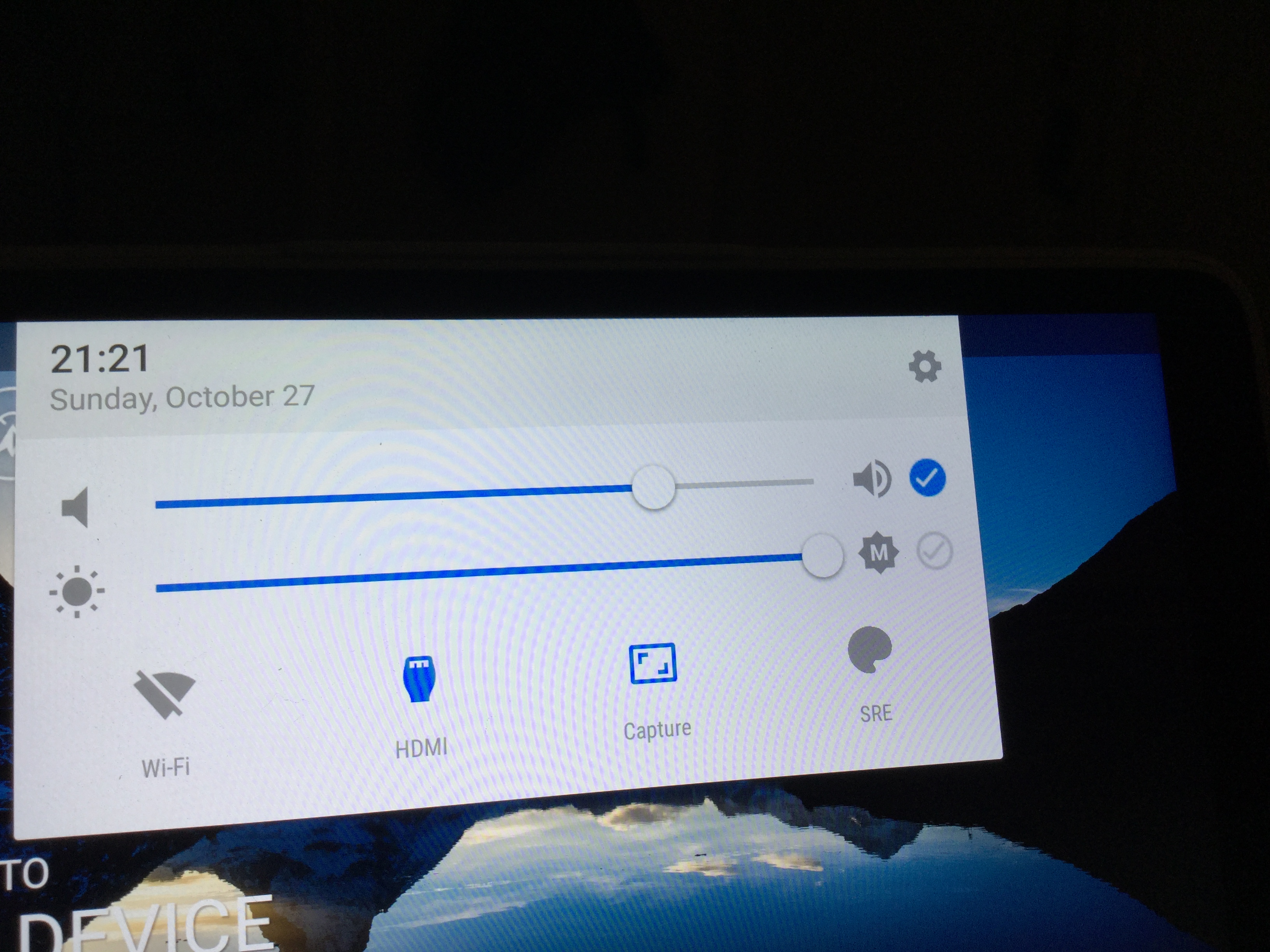

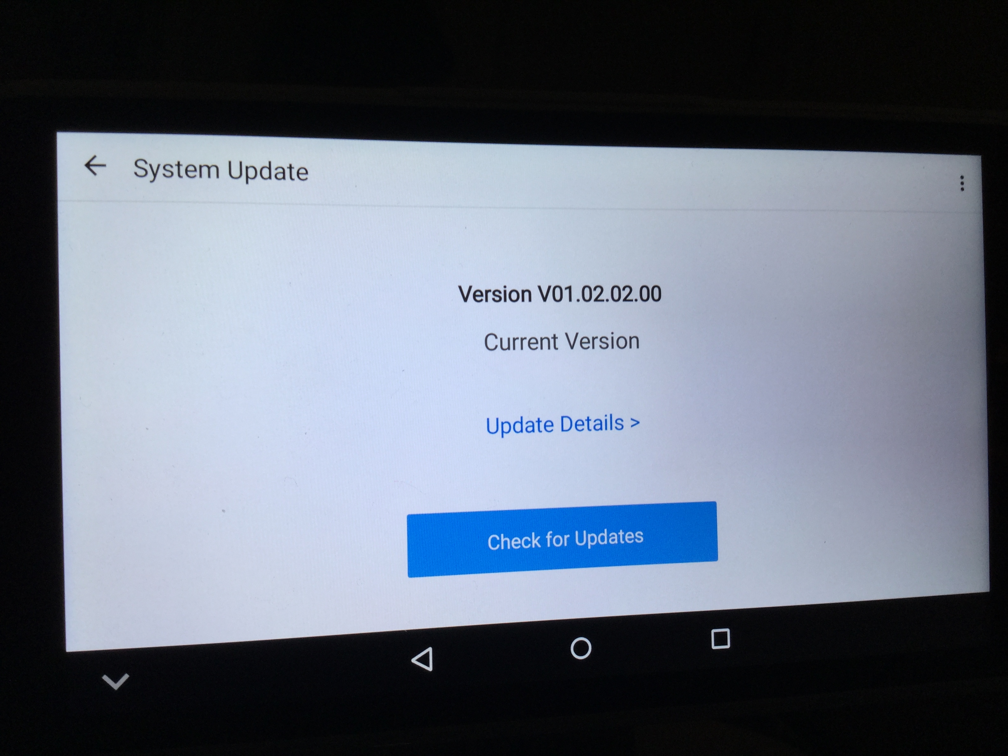

Usually, you will get a prompt on screen for Go4 updates. Accept. For firmware updates, Use the drawdown screen, finger down from top of page. Touch gear icon, upper right, to open the settings menu. It will shown WiFi, sound, etc. one is updates. Check if the new firmware is available and install. I downloaded, from DJI website, the 300E newest firmware to an SD card. Follow on screen instructions carefully. It’s now ready to insert into the SD slot of any 300E. I’m doing this often enough that I just keep the firmware on that SD card for future use. As a last resort I could mail it to you but hopefully you can get it done.

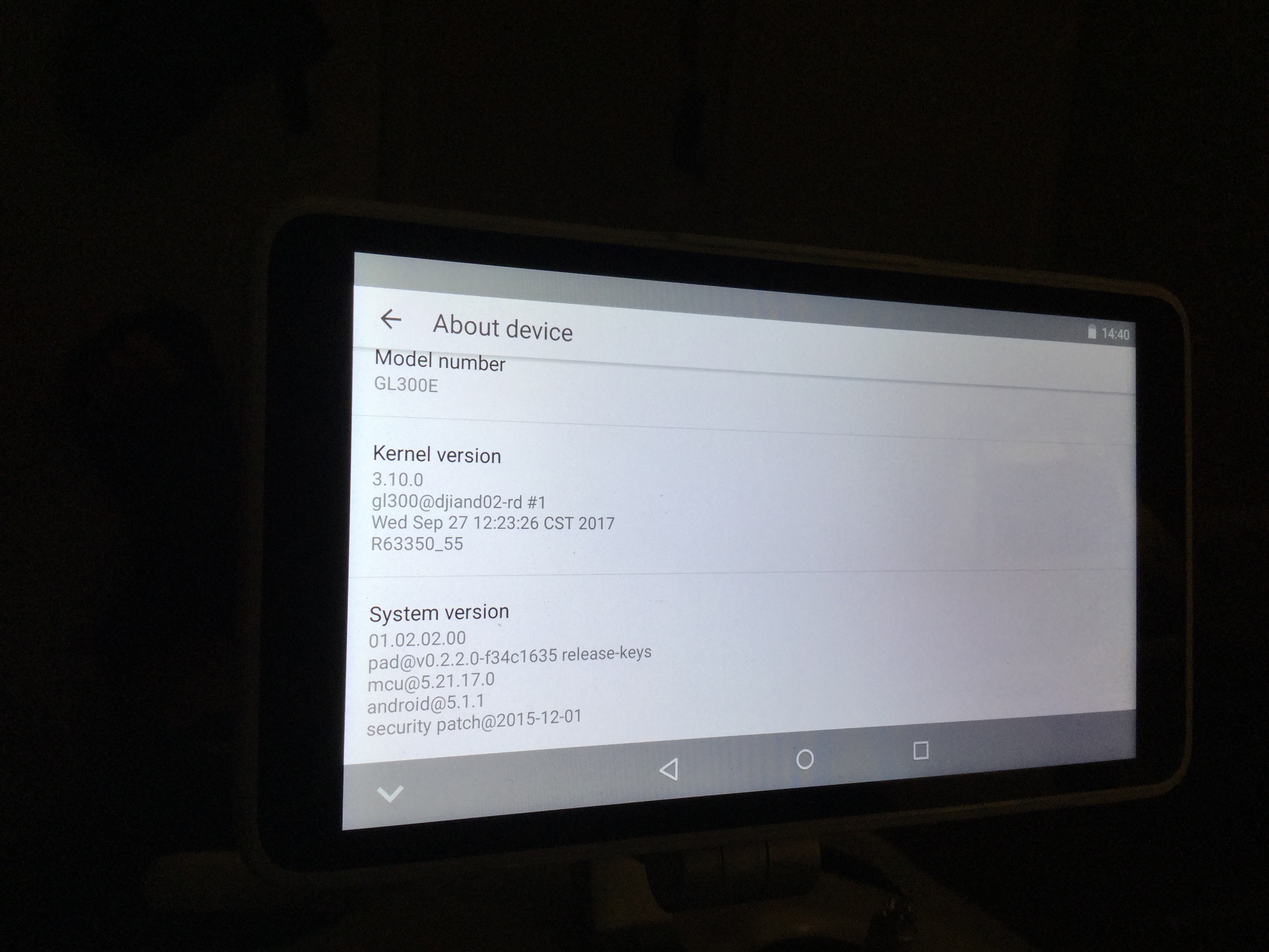

There is only one download available from their site, zipped. After opening it you copy it to the SD card. I think the number was on one of the pictures I sent post #5. You're almost done, insert SD in RC and follow any commands. Watch download, do preflight and go fly.
V01.02.02.00
