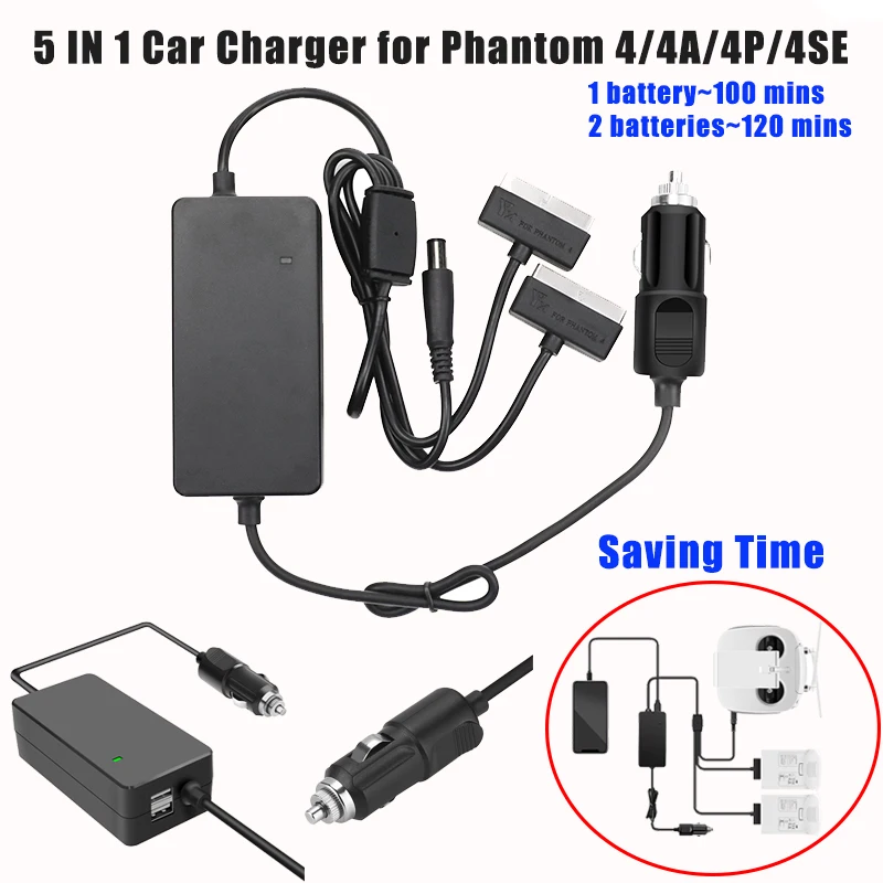

Battery-cables are hard to get these days, you could buy this car carger which has 2 of them:
Thanks for suggesting the car charger. I have ordered one.
