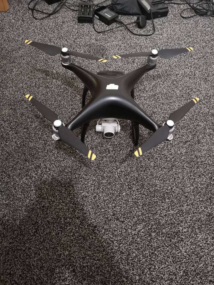

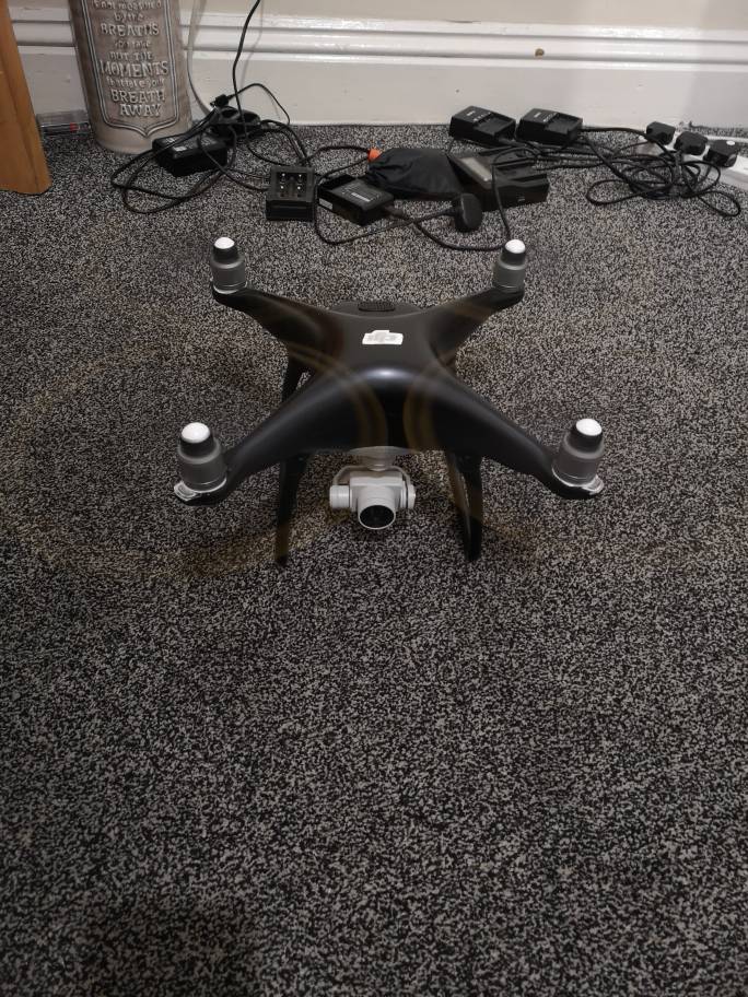

Hey guys, I recently purchased this used Phantom 4 from a friend, I have flown the bird on a few occasions and have yet to fly this outside (with the new paint coating) to see how it fares.
I did read a thread here that said painting the landing gear can cause GPS Malfunction/Loss of signal but I will have to test that out myself.
I painted the drone with Plasti-Kote in Matte Black, purchased the spray paint from Amazon.
I did not disassemble the drone to spray paint, I simply covered each and every hole with 3M Scotch masking tape, I covered all the sensors, in this case these were the front facing obstacle avoidance and the lower half of the gimbal ones.
Before painting I made sure that the gimbal was properly secured and that there was no room for any paint to enter in any of the ventilation areas.
Just joined the forum today so I thought it was ideal to post what I did.
I did own a Drone before this (Xiaomi Mi Drone 4K) before I crashed it into a tree whilst making footage - I have yet to fix it, since the gimbal along with the camera disconnected from the drone itself.
But yeah!
The props were also from Amazon, they looked quite fitting for the drone imo.

Hmmm... looks like you handle a spray can pretty well!!
Props spinning in first picture? Looks like it.
I don't think the added weight will effect anything. What could it amount to? An ounce maybe?

Haha thank you, it's my first time spray painting something, I usually stick to traditional methods of painting things with brush and paint bucket!
I did fly it today and have yet to check the timings and how much they differ, it flew very well though.

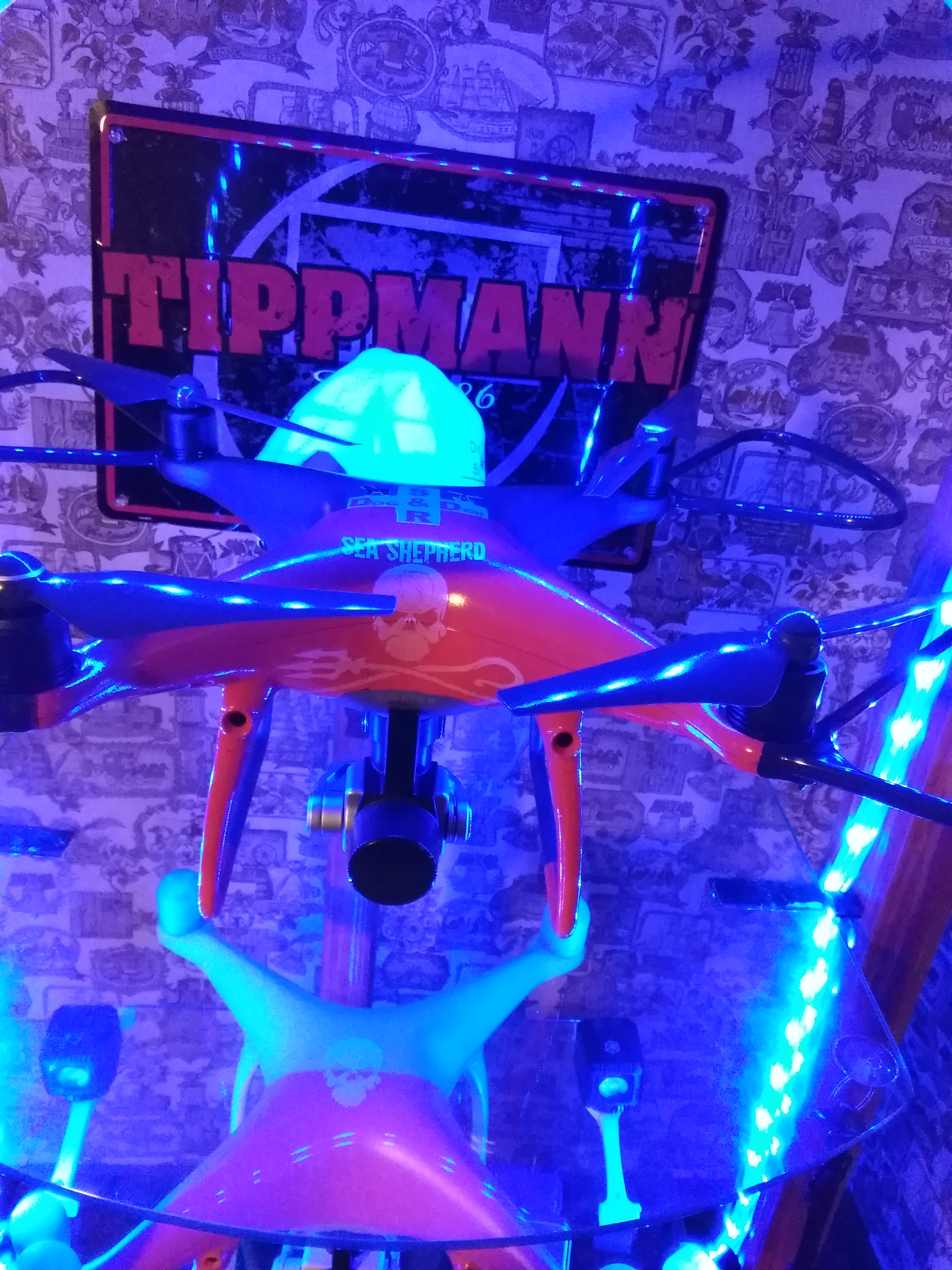

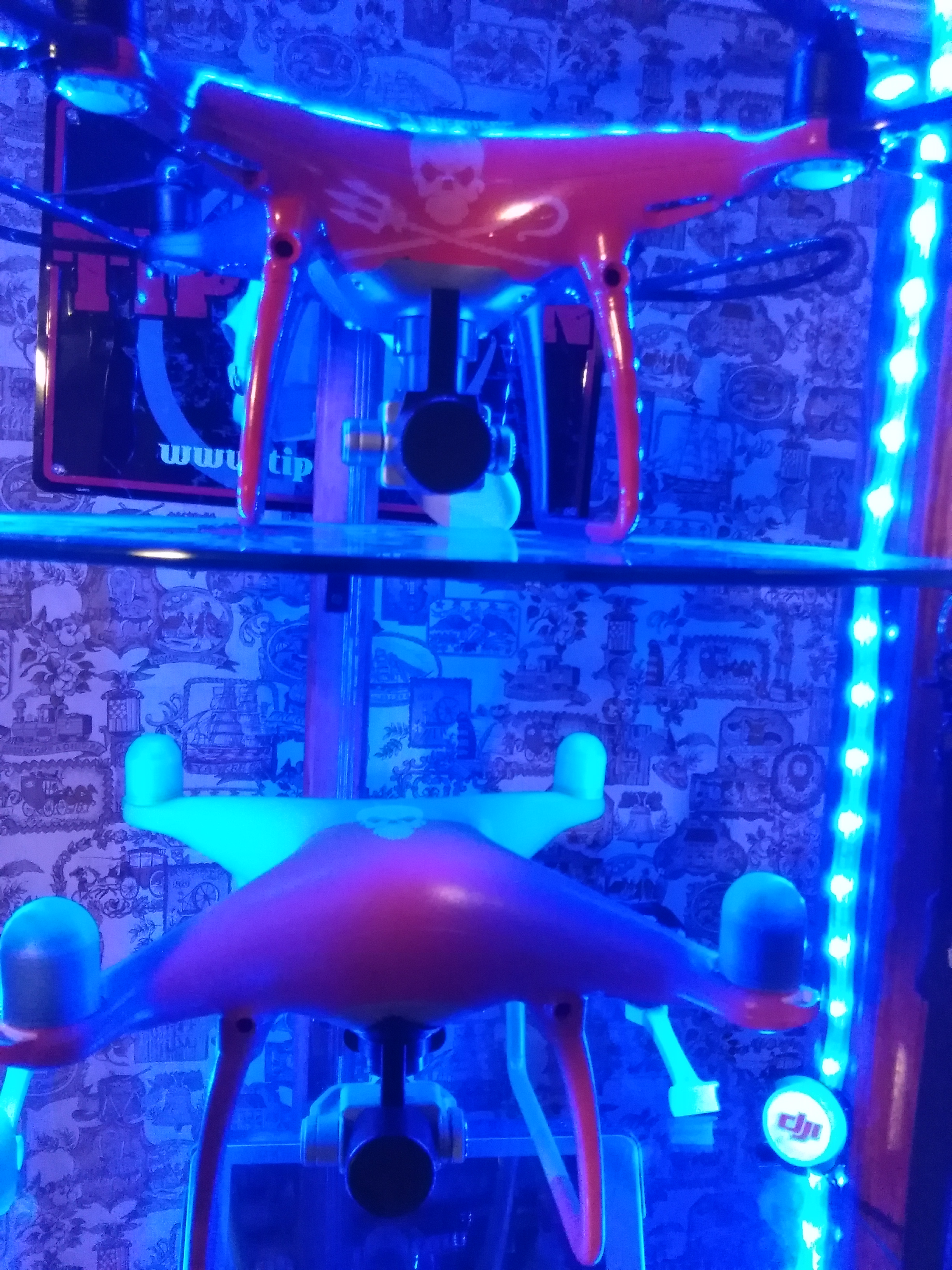

View attachment 103298 View attachment 103299 You can wipe off the permanent marker with isopropyl alcohol. So if you get board with your colors just wipe off and change it.I have painted all my phantoms by just taping them off including front of Obsidian.I have owned 8 phantoms but down to two now.lol.I have flown p3 standard and Obsidian farther than I care to say.No problems with any of them do to paint.Hey try rust -oleum glow in the dark on your phantoms.
Wow that looks awesome, and I'm glad you've painted your drone too, it turned out amazing with that colour scheme you chose! I've flown mine quite a bit and have had no problems whatsoever since the time of spray painting.
