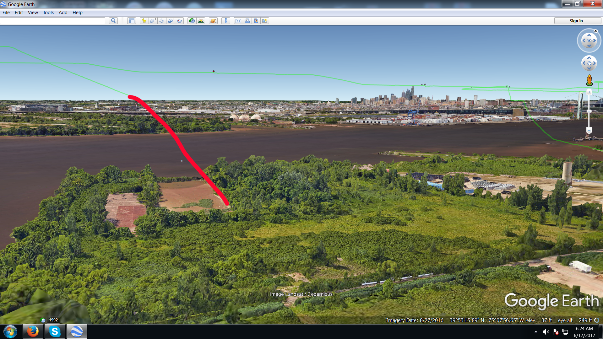

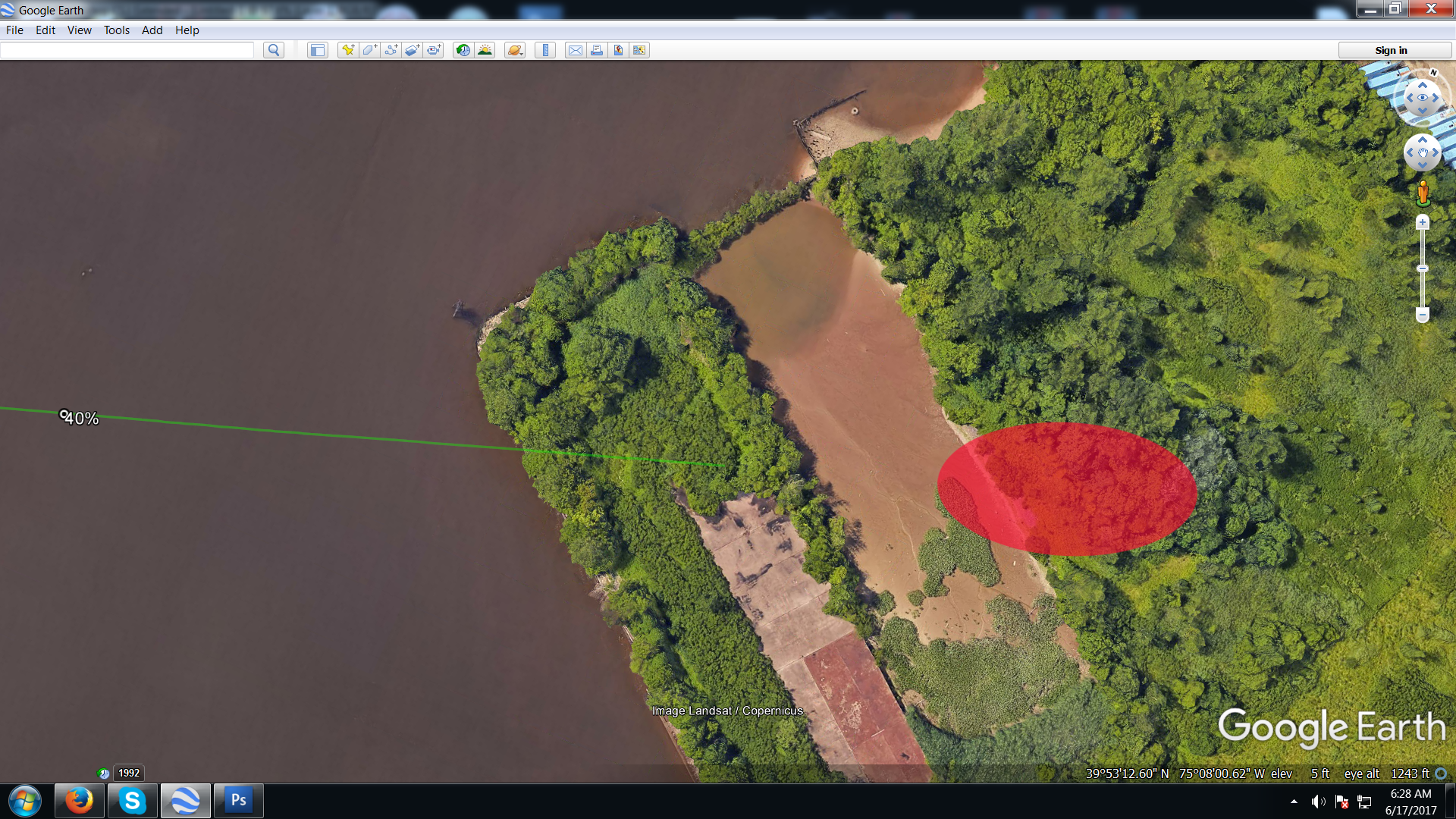

This is one of those frustrating cases where the flight record doesn't show exactly what caused the incident.
It gives us enough info to eliminate most of the usual suspects.
The battery appears to be fine, no obstacles or wind to worry about..
The flight record just ends with the Phantom approaching home, at 376 ft and descending under control.
The two possibilities that come to mind are hitting something (a bird or a wire ??) and dislodging the battery or a random hardware problem that cut off the power.
To get to the bottom of this mystery, the Phantom will have to be recovered and the internal flight data may show more.
At the last recorded position, it was making 30 mph, so if it lost power and fell, the momentum would have carried it further along the same line.
If it carried on for more than 100 ft, it may be in a pond.
My rough arithmetic suggests it would have ended up close to the arrowhead above.
It's not possible to calculate exactly which side of the edge it would have landed.
That Pond is just some run off from the Delaware River...The last image on the ground it looks to be surrounded by brush. Also was getting signal from Marco Polo tracker. Also I view the entire Death Spiral, didn't lose signal until it hit the ground. I was too high to have hit a tree or wire bird strike possible but never even a close call there in a year. If it was a bird I didn't see it nor did it look like it was hit..simply flying along with homepoint in the viewfinder and dropped from the sky. Not knowing what happened is the worst issue in that I think future flying I'll always be waiting for the bird to drop out of the sky. As I mentioned I've flown nearly everyday past year...with never even a close call of losing bird. Very disconcerting. Thanks for your reply.
Looking at the area I see no lines at that altitude. The data shows no abnormalities. My take is either it was shot at, battery fell out, bird strike, or some system power failure. However your shots show it near the surface with vegetation in view. At 30MPH velocity I would start near the areas I plotted out thinking of a Phantom type weight at given speed and height.

I have a Marco Polo and was getting 27% signal outside of the fence. I was close enough to hear a shot, no one around that area..I just hope with the marshy area I can make it to the bird.
This is terrible ,I don't know if I'd be able to wait till monday if I was you I'd be in the area now looking around trying to get access to the area even if it meant hopping a fence.
Well the fence is barbed wire with tons of No Trespassing signs. If I didn't think I could access Monday I'd be looking for alternative ways. I'm gonna fly over the location today and see if I see anything.

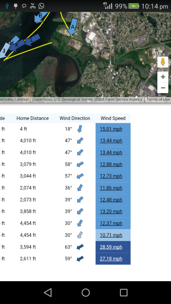

One other question @Meta4 if you don't mind, if you look at my screens above it's saying my distance was 4600 feet when in fact I was about 1300 feet which is confirmed in the data, what would cause the screen to report this?
Just a guess but is it possible the wind would be fast enough to flip it over ?
