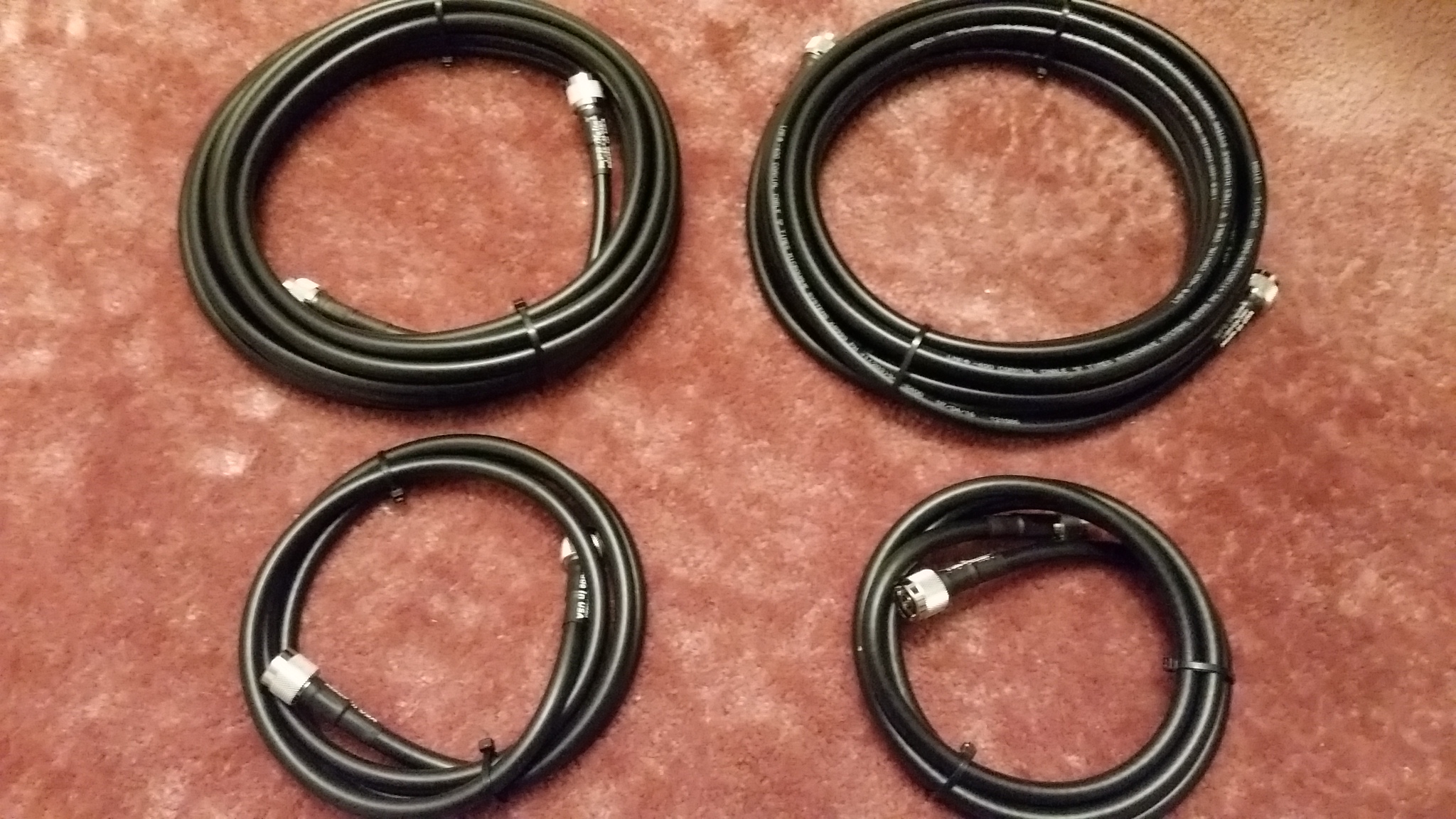

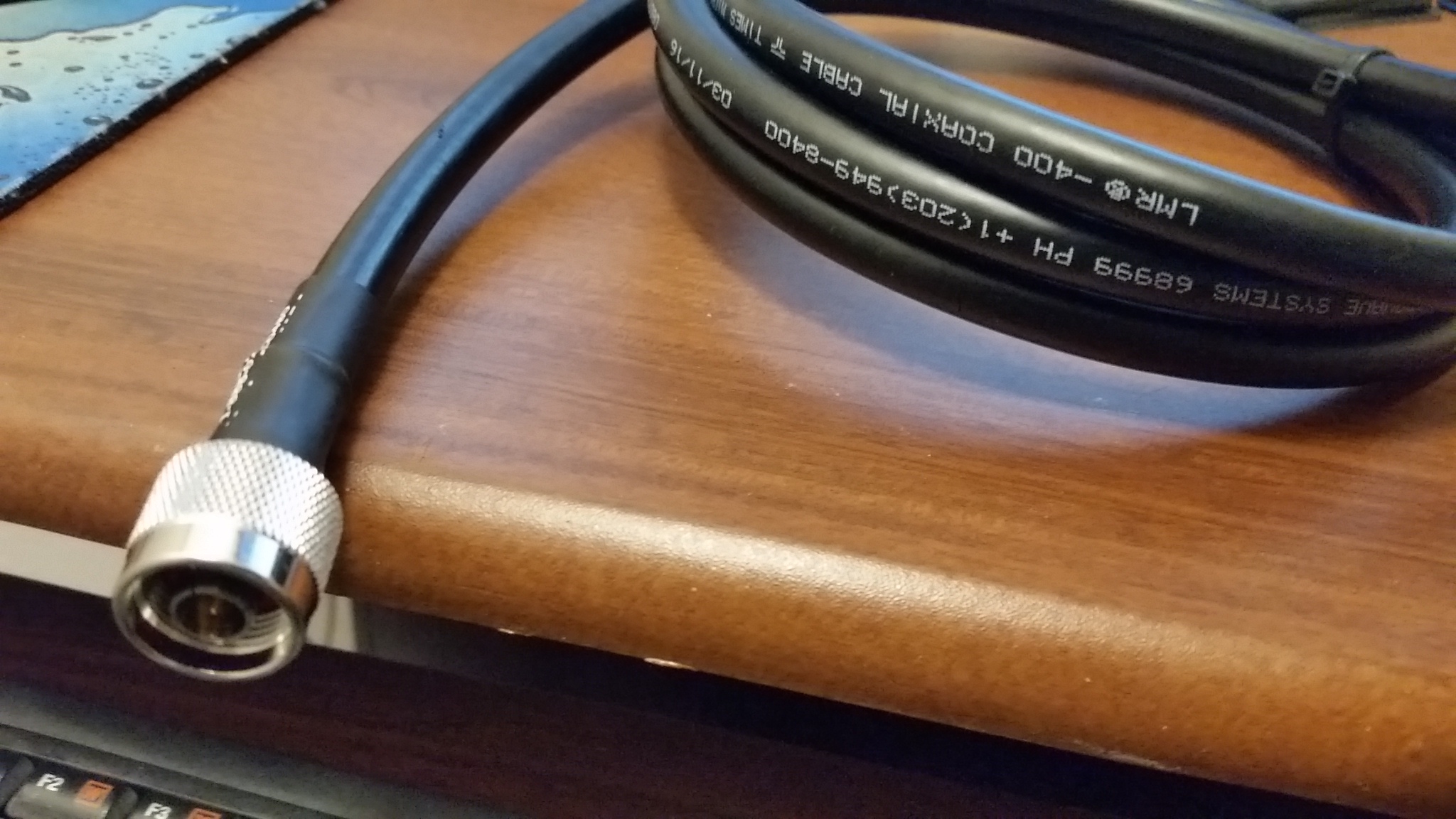

Just found a Amazon box on my porch. What could it be? Well it's LMR joy! (These are NOT bend friendly cables) LMR-400.

Just found a Amazon box on my porch. What could it be? Well it's LMR joy! (These are NOT bend friendly cables) LMR-400.View attachment 73048 View attachment 73049
Man those are thick! Look high quality! And yah I bet they are like bending steel lol. How much did you pay if you don't mind me asking.. And why did you decide to go to it vs rg6
