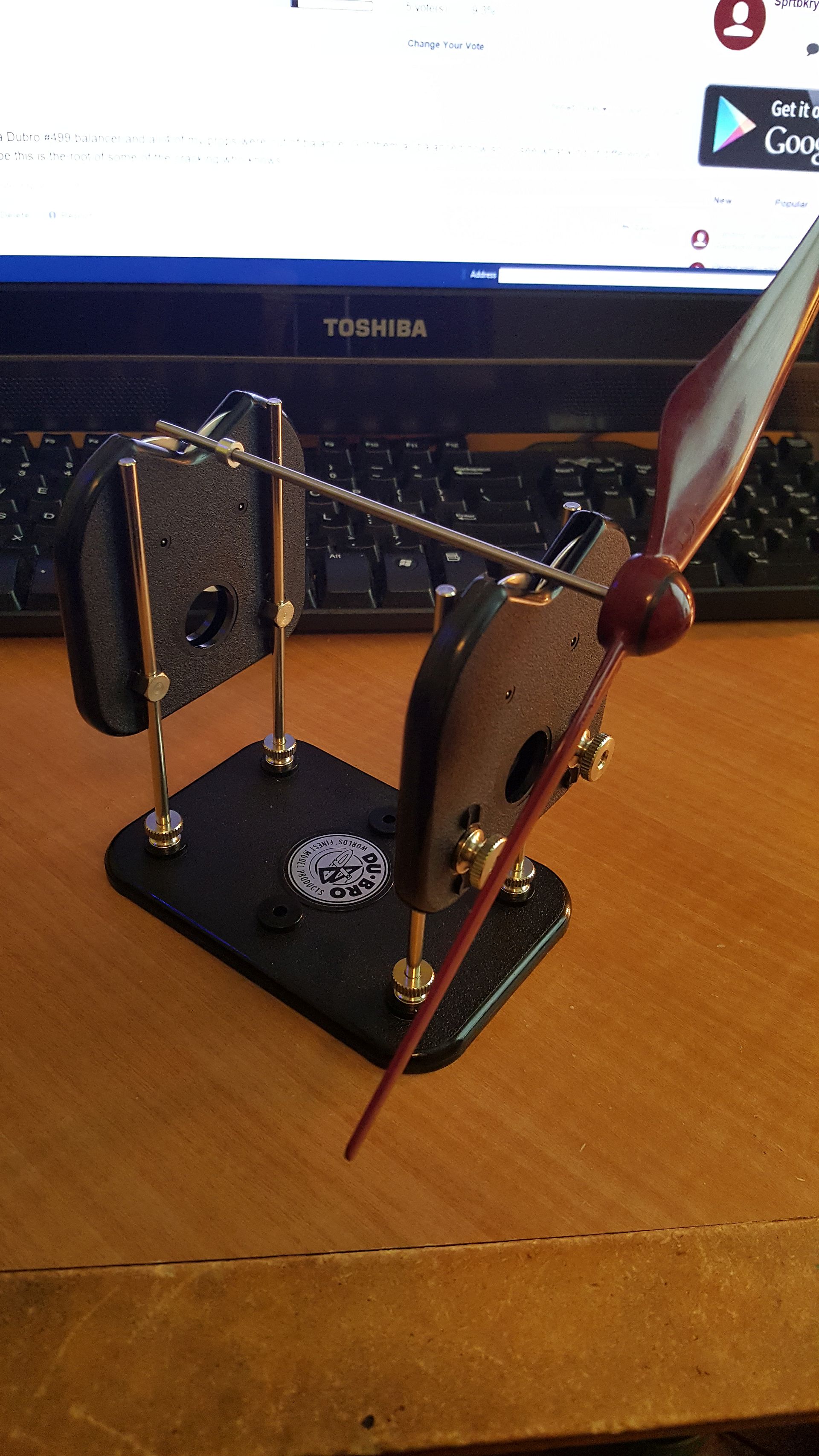

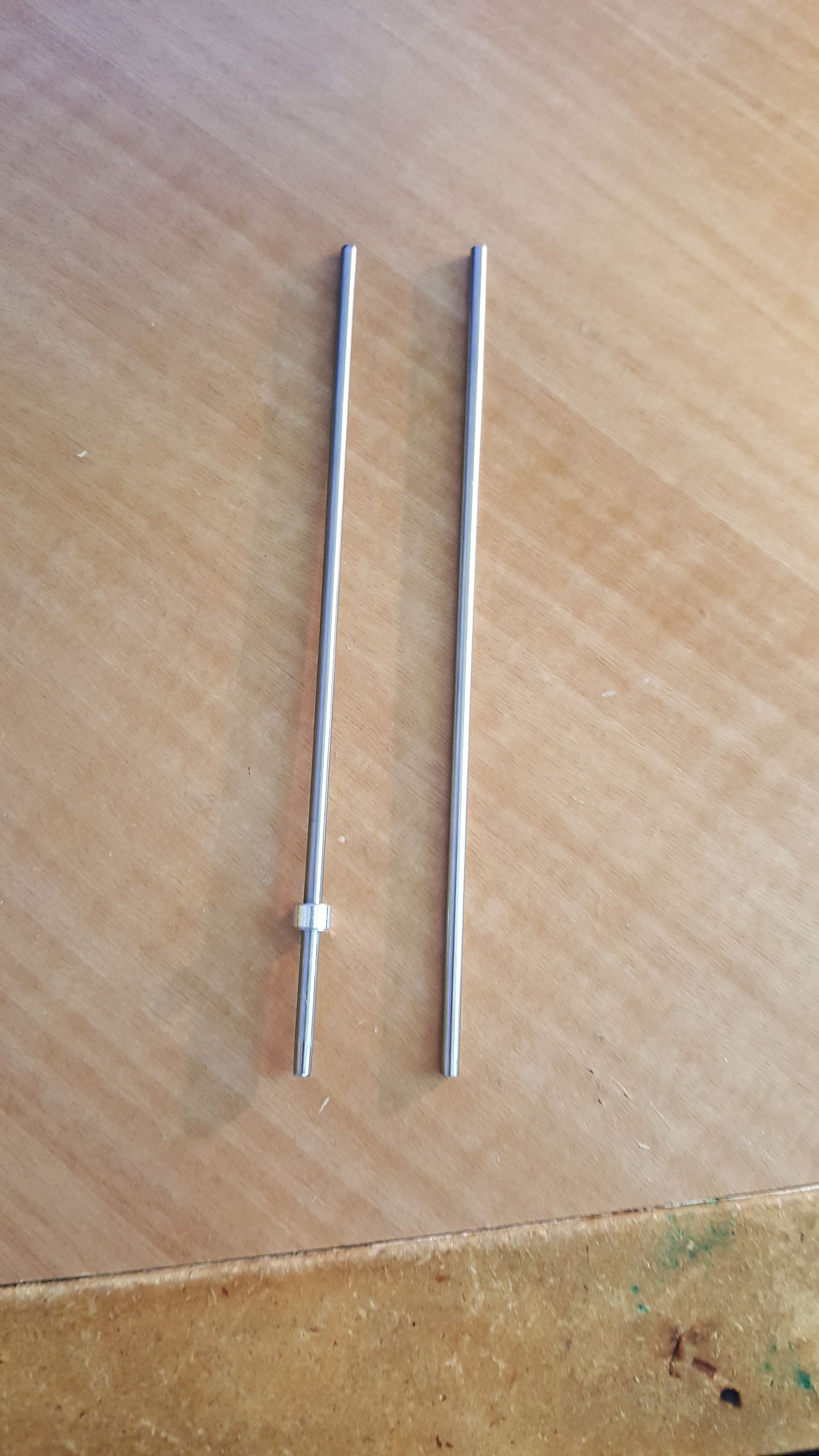

Did you have to buy a balancing rod as well? If so, which one?
Yes Dubro makes a rod just for the Phantom 4 but I found out that the rod that comes with the kit fits them just fine. You can find all of it on Amazon.
I'll trust your findings and just order the kit and not the P4 balancing rod. The comments on Amazon say you need to purchase the P4 rod separately.
The included rod fits the P4 props just fine. You'll be ok with using it. It's a "friction" fit so it will just stick into the hole on the prop.

Here's a pic showing my prop setup on the stand using the included rod. Other pic shows the two rods. One on the left is the included rod.

Received this today in mail. When balancing my P4 props, I'll insert the provided balancing rod snugly into the hub hole. It may show a prop perfectly balanced. But then I'll take the balancing rod out and insert again after a slight rotation and the prop often shows it's slightly out of balance. This is quite tricky.
If it's balanced properly the prop will stay at any position that you set it and it will not move. So rotate it around and stop at different positions and see if it stays there. If it does it's balanced.
