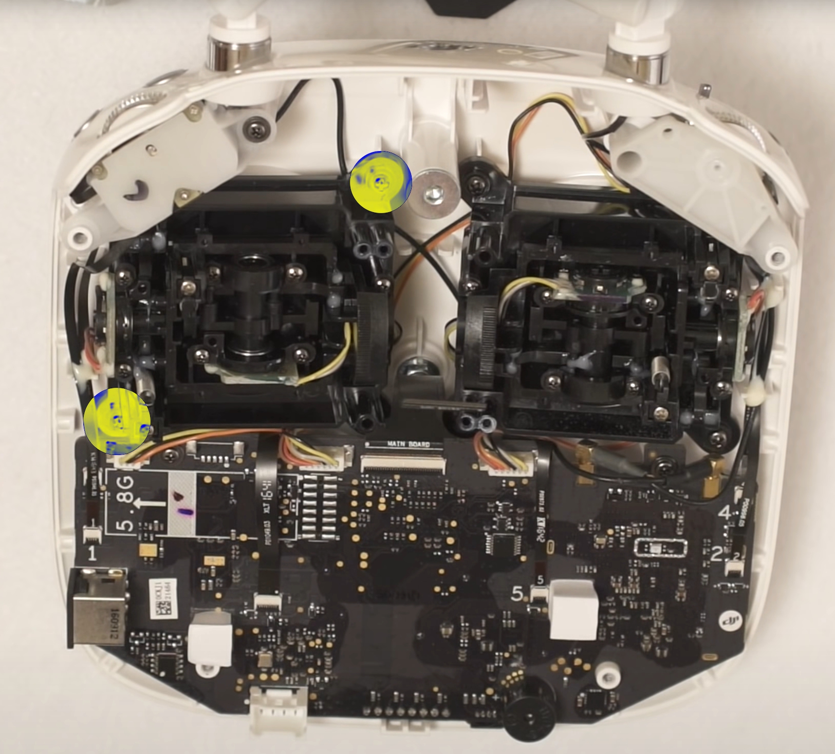

P4 RC disassembly:
11:41
Most likely the screw-seats split or broke off and you have to use quality glue for the repair.

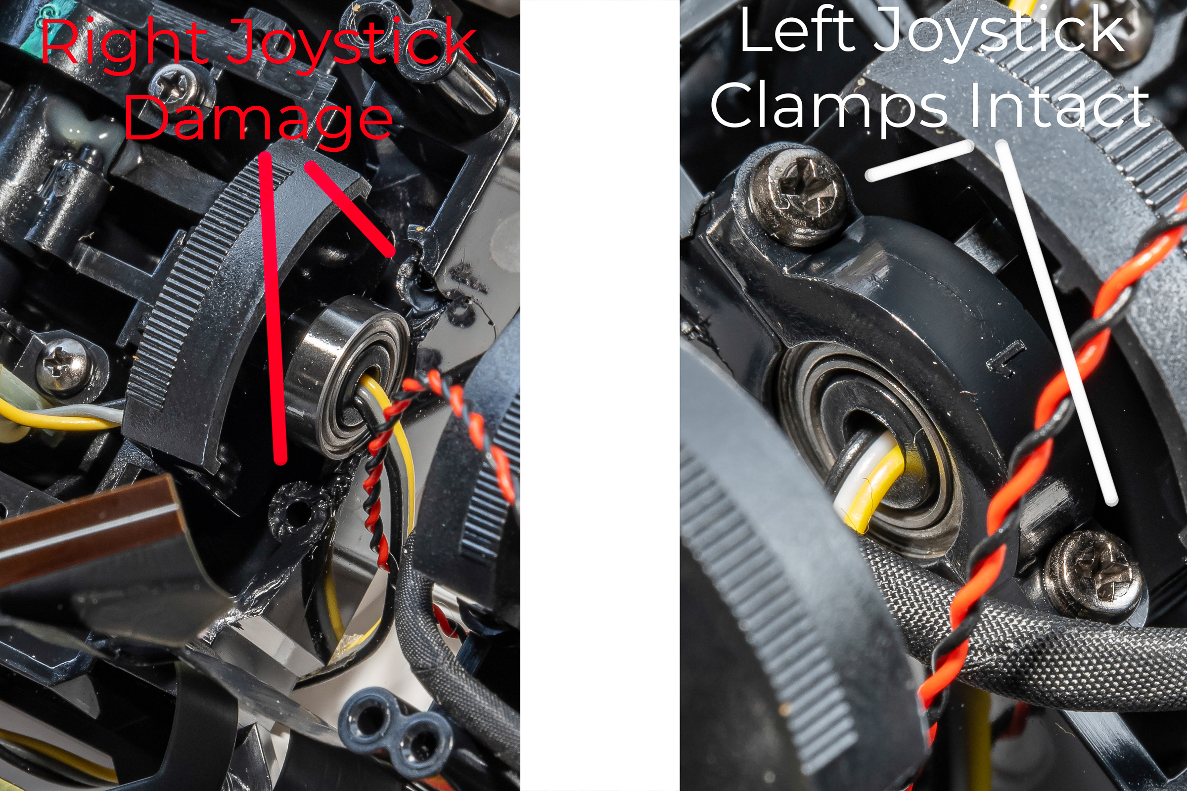

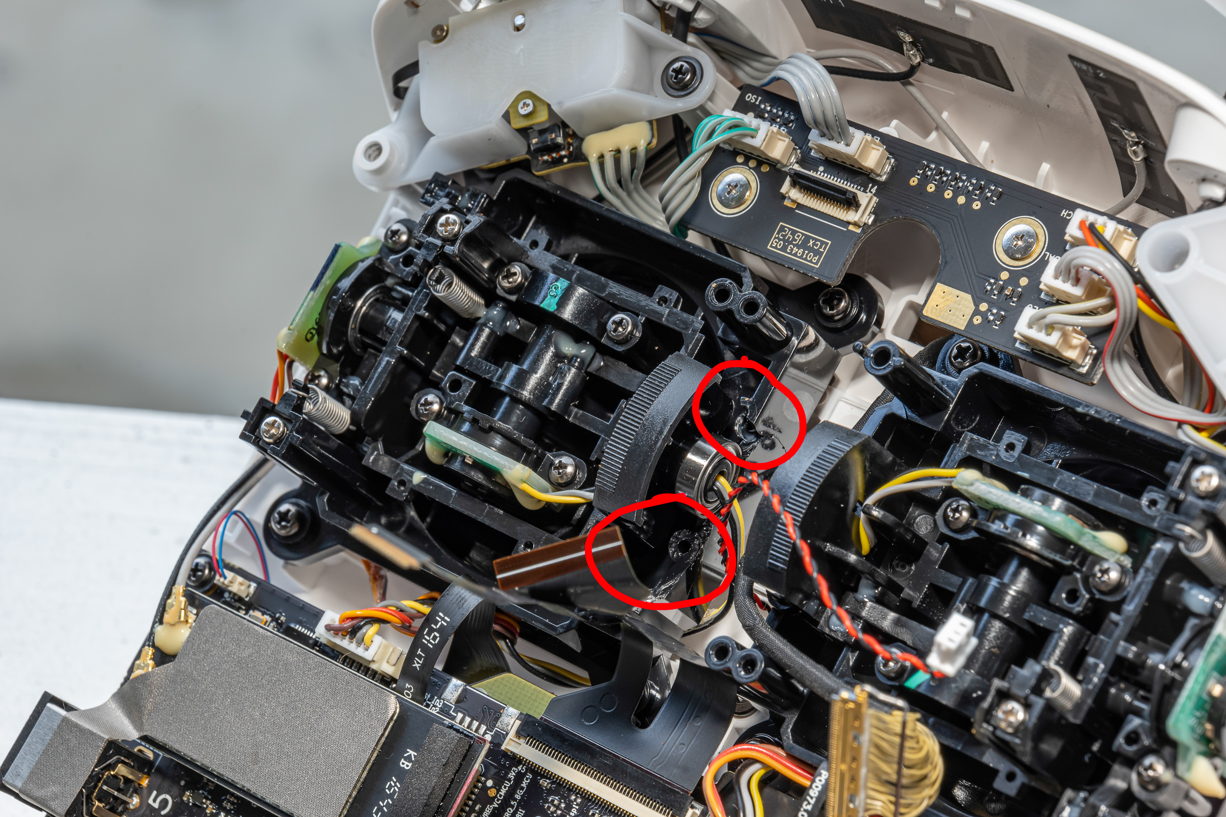

I opened up the RC and it looks like there is a mount that is supposed to have a retaining clip screwed in to it, but it appears that it has broken off.
If you look at the photos, I have taken a shot of the Left joystick gimbal (the left side joystick works fine) which shows a small semicircle "clamp" that is held in place by two screws. If you look at the right hand joystick (the one that flops around) you will notice that clamp is missing and the base underneath it appears to be damaged.
Oddly enough, there were no missing pieces inside the remote control unit. Also, I never heard any rattling around of any loose parts. I can't imagine that a part that size (about 4/4 of an inch long) would be able to fall out of the controller.
Any ideas how to fix or whether I can send it in to DJI and have them fix it for a reasonable amount of money? (It is out of warranty).

It looks pšretty odd. Seems that the plastic, where screws should hold the stick, broke off.
It must be pushed unintentionally the stick so hard that it broke. Or maybe you hit the RC to something.
I think that the best thing to do is get it to the DJI service. It should be a cheap repair.
With nowadays glues it will hold as well (maybe even stronger than the plastic holder) but you can have a problem calibrating the stick if it's not completely aligned.
Send it off to DJI. You will end up with a new controller.
The previous owner would probably be the one that removed the broken pieces.
But probably it is out of warranty and such things are not included into it. New RC is not so cheap.
