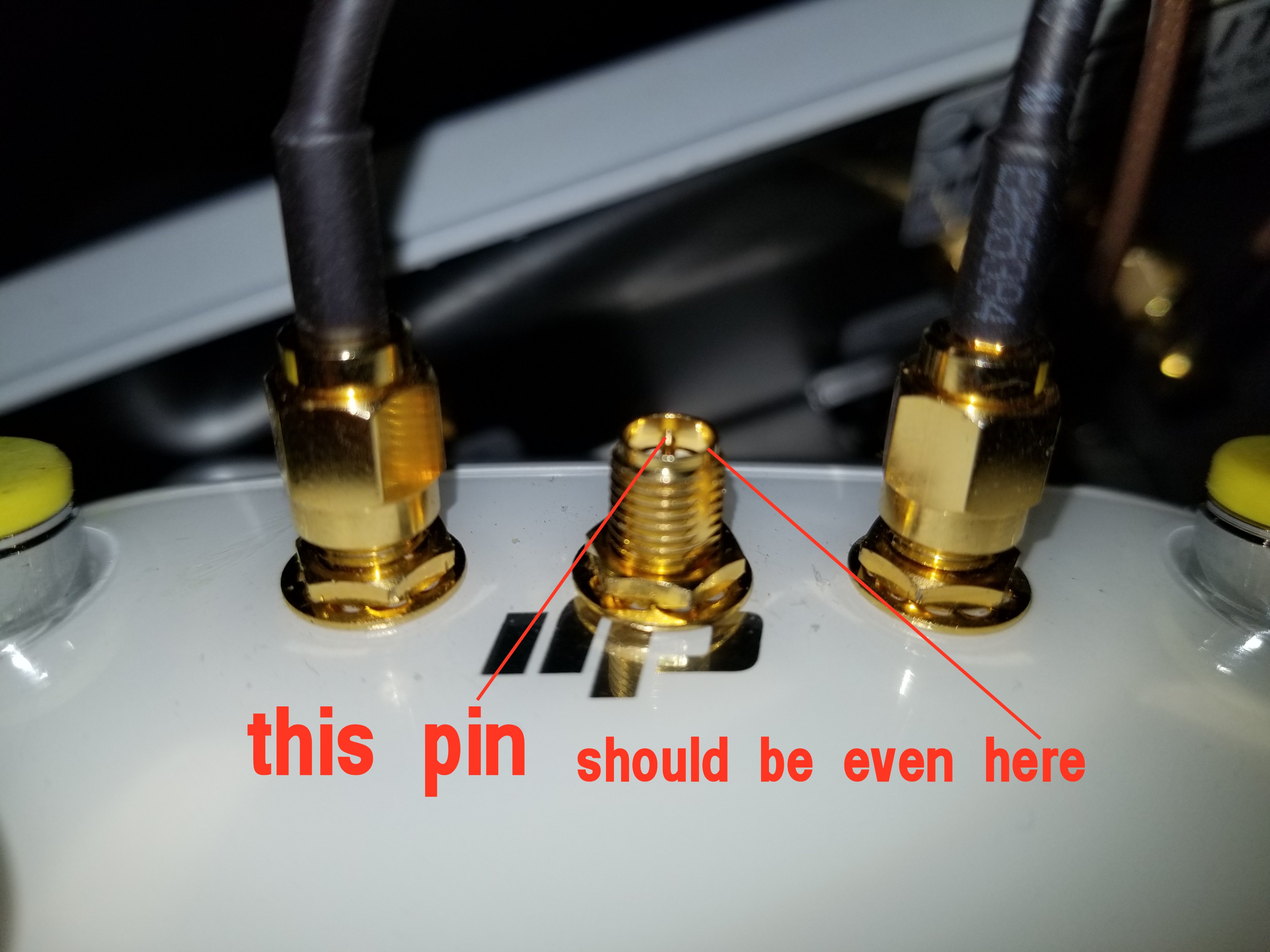

I am using the DBS and its awesome I was using the Argtek and it was also very good but the DBS is better for sure. one thing to look at is the center pins on the cables some folks have had some issues with that center pin not being long enough to make a good connection the pin should be even or slight above the rim like in this picture. some are much lower if it isn't you can replace it with a new one or carefully file the rim down till the and rim are the same height but don't go any lower then the start of the threads. had to do this on the Argtek on my nephews drone now he can get out to 5K easily
