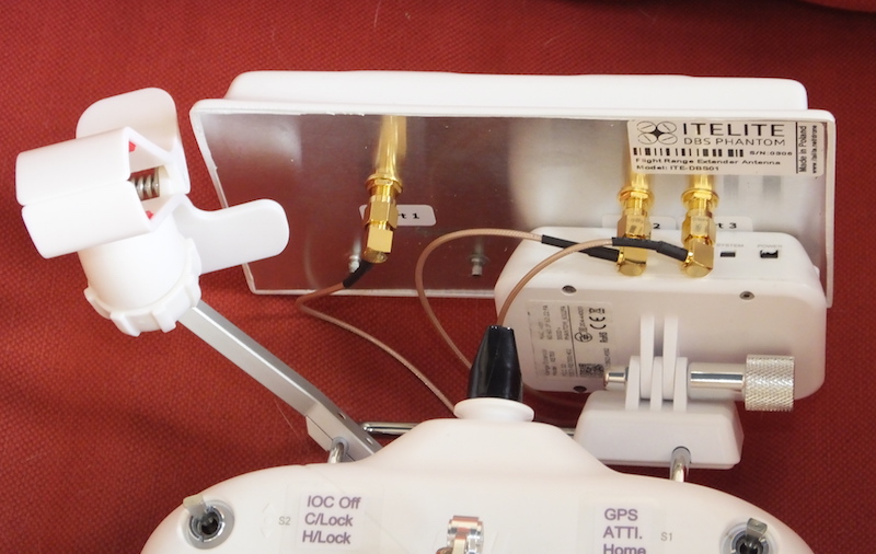

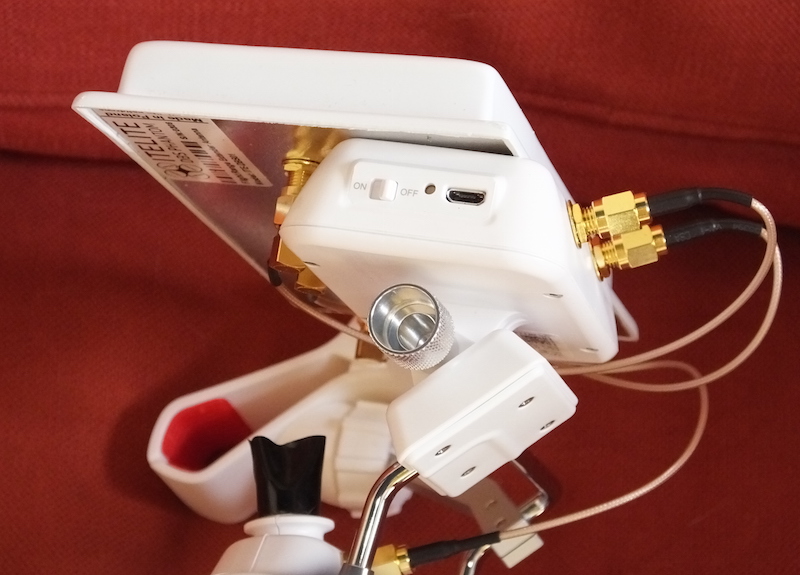

Finalized the installation today and the weather is good enough to test it out later today, I'll return with results later!
I went for the mount on extender strategy as well, and I agree, it's a tight fit, especially with the tablet clip, but it works! So happy that I managed to squeeze everything into one case..
I remounted the panel as above directly onto the extender.
Though I have my cables coming out of the base.
I did find also the stainless bracket was starting to rub off the label on the extender. (with I guess the important mac address).
It also fits neatly into my padded backpack, similar to those shown.
View attachment 17807 View attachment 17808
****! I should be getting ROYALTIES for this mounting system! :p
That came out beautiful!! Love the whole carbon look!! And the black motor mounts!! :eek::eek::eek:
True statement … this is really catching on :cool:
Great ideas are made to be shared bro... excellent contribution to The Swarm!!!

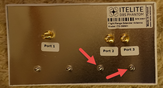

I mounted the Itelite directly to the range extender
How does one go about removing the cover of the Itelite so the screw studs picture here can be removed to facilitate using Velcro to mount the Itelite directly to the range extender (instead of drilling holes in the extender)?
Reactions: Skynet1
The panel is siliconed shut... very hard to open... dulled utility knife and mangled plastic and bent aluminum reflector plate are usually the result. (Not good for reassembly and optimal performance)
And those screws are studs that are machine pressed and bonded to the aluminum from the inside... so once you get in there you will not find a nut or a Phillips head to turn and remove them... better to grab the trusty dremel tool and cut them off... if you try to get them from the back you will end up drilling them out anyways. (AND you can't get to all of them... some are under the actual patches mounted inside the panel)
Brent, you may consider simply cutting them off, via Dremel tool, or other means, flush to the backing plate. Just a thought! :)
Oops, DBS beat me to the punch. Disregard.
i love velcro and I use it in many gadgets, But I don't really know if this would be a good place for it.
To be flush with the TX, the antenna panel must be sticking on one side to the extender, not the center. so it will get side heavy and may be wobbly.
What exaclty is the reason for not drilling the extender and get a tight grip?
Thanks for the quick responses, guys!
