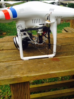

Any chance of getting a pic of both sides after the mod was done?

Me talking on your bird..did you put the 5.8's on there too ?
No I did not but I would like to try it!
here are some pics

Cool ! Thanks for the pictures . I already have mine fixed for both as I said and was hoping to see if you were running both , I would have to look back as someone was getting ready to have both and was gonna wait and see what there's did before I changed again .
Always changing something :D Can't never leave well enough alone :eek:
Added/ Here's the way I have my FPVLR's hung

Added/ Here's the way I have my FPVLR's hung View attachment 23534
so let me ask you,the 5.8's what are they for? are they the antennas that look like the path of an atom? I dont know how else to describe it.. are they for the flight transmission? if so they look better than the 2 skinny wires that come stock..
And I know what you mean "can't leave good enough alone" but thats the fun of this hobby tweaking and modifying..
5.8's are the TX side and are the little ones ya see on my bird . The way you see them there ..they are just the opposite on the other side
and on the front leg . 2.4 are FPV
They do look cool but a pain to transport if ya don't take em off which I don't .

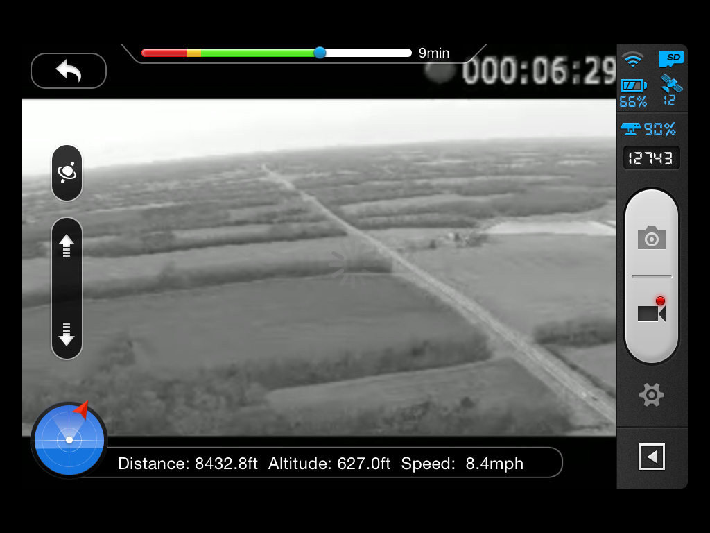

843.PNG A lot for me with what I got but still not bad considering ;)

HOLY SWEAT!! that's some great distance,and it looks like you had some left to go further!
I want it!!! where do I get it?????
That was with the stage 3 FPVLR's and have seen many go way farther . When I go out I do so in ATTI and start back when I usually
see I have 60% battery left . I will HL back most of the time and Always check that before I do go for a run !!!!
I always have my tracker on also !
I do like the itelite panel as it don't take up as much room on the TX and waiting to see how Tony's Birdsides do with it .
