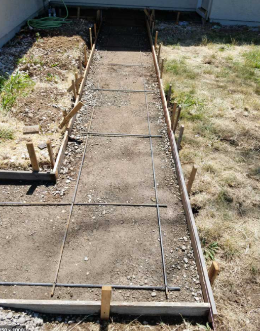

Though I've never had any issues with interference specifically when taking off from any cement surface I do hear such stories. I do construction progression videos sometimes and always have this in the back of my mind. I never know where i may have to take off from. I do know to avoid parking decks/garages...THAT i do believe. lol....I've heard launching pads can cause issues(though ive never experienced), Ive heard to never take off from cement/pavement/asphalt. So what do you all think?...is it really a valid concern?

It's potentially a very real problem and many drones have been lost because of it.
Your drone uses a magnetic compass and gyro sensors for directional guidance.
The gyros need to be initialised on starting up the drone, so they can provide accurate direction data.
It takes its initialisation from the magnetic compass, but if the drone's compass was placed close enough to a steel object, the compass will be deflected and the initialisation of the gyros will be wrong.
Asphalt doesn't have reinforcing steel and would only rarely have something steel buried close under it.
I suspect steel rings in launch pads aren't a problem unless you launched from the edge of the pad as the steel is small and far from the compass.
I've only heard people asking about it and seen no reports of it causing trouble.
For more details see this post: Avoiding the rebar effect
I've never heard of issues with pavement or asphalt, but cement can be an issue (and has proven to be countless times) if it contains rebar.

It would be very rare for the black stuff to have any buried steel under it.
They don't put reinforcing steel in roadways etc.
Any structural concrete is going to be full of steel, so beware of the grey stuff.
If you can't avoid the concrete, lifting the drone a foot or two above the deck (on a case etc) would prevent the issue of having the compass sitting just an inch away from invisible reinforcing.
