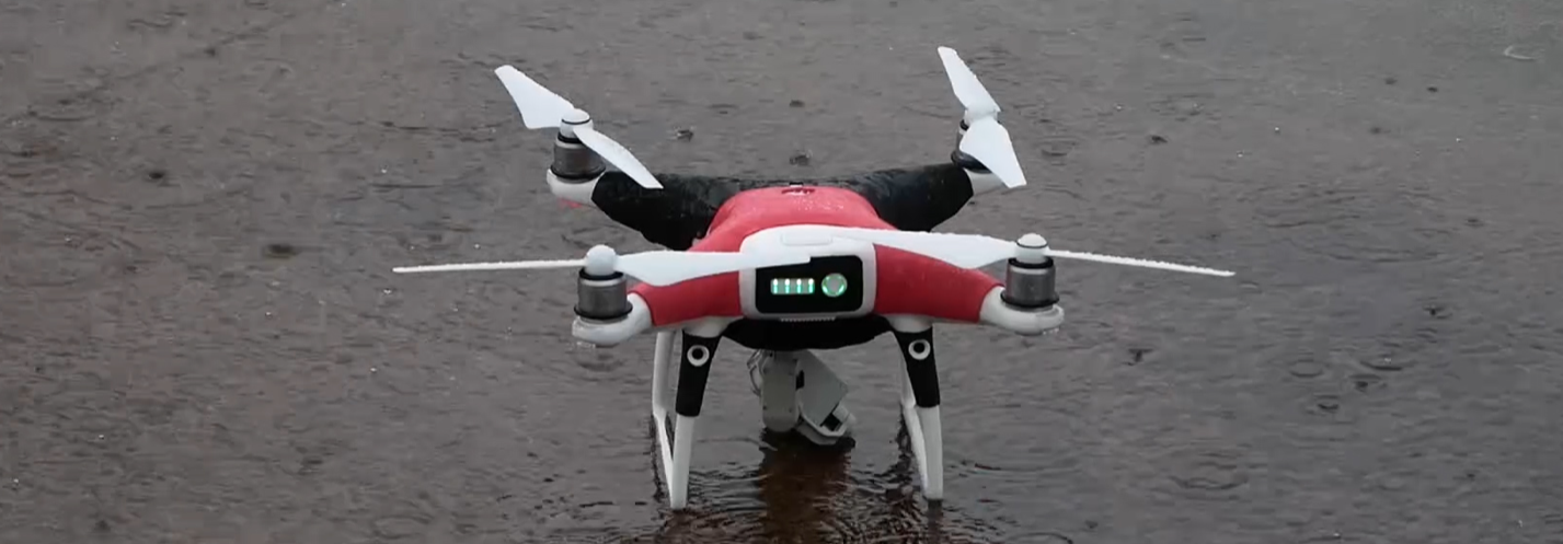

We now make the Wet Suits for the Mavic and the Phantom 4 , this will allow you to push the envelope on flying in the rain and fog.
We have some amazing footage on phantomrain.org

Now the Mavic is ready for extreme flying, battery seal: Prop seal: vent closures and great design.

What happens with the vents at the front? Surely this is one if not the most significant point of ingress??
You might think that, but you would be wrong, the battery is the weakest link, you have the Power button on top and the seams in the battery housing , so we sealed that up using the exact same concept from the Phantom Rain Wet Suit and we sealed the Power Battery button with an acrylic cover , worked like a charm.
The front vents we doubled the walls, inside and out , you just cannot see it. , so the vents do a great job of keeping the water out as do the prop covers . .
We have been watching the Mavic forum for some time seeing what the issues were with the Mavics and the New Mavic Wet Suits solved some of the biggest issues and the Compression cones we made to seal up the drone work extremely well and fold into the open vents when the legs are closed.
Engineering marvel. lol
So if the water were to get past the first vent it will not get past the secondary vent inside as it was designed to be much narrower but without blocking air flow.
Phantomrain.org
approved vendor
There is no way that this will reduce the amount of moisture from the air! And again, DJI would not replace a wet drone that was "Protected" by your snake oil products.
