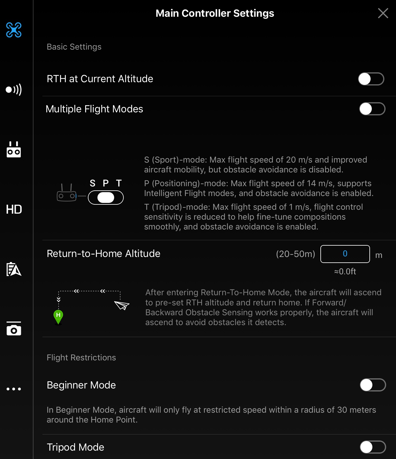

Hi All, I have recently noticed that my intelligent flight mode icon is missing on my Dji go 4 app. I have deleted and reinstalled the app with no success. I'm using a Phantom 4 pro with an iPad mini 4 that has been working flawlessly since I purchased the drone a year ago. Has anyone encountered this problem? If so did you correct it, hopefully someone can help. Thanks

That icon will also disappear when Sport mode is enabled.

If not not stupid me! I don’t recall ever turning it off but, I will definitely check thanks. I wonder why DJI support didn’t suggest turning it on.
Do let us know and hope that’s all it is.

Thanks for all your help turns out I was in sports mode. Must of hit it by accident cause I never fly in sports mode. Thanks again.👍
