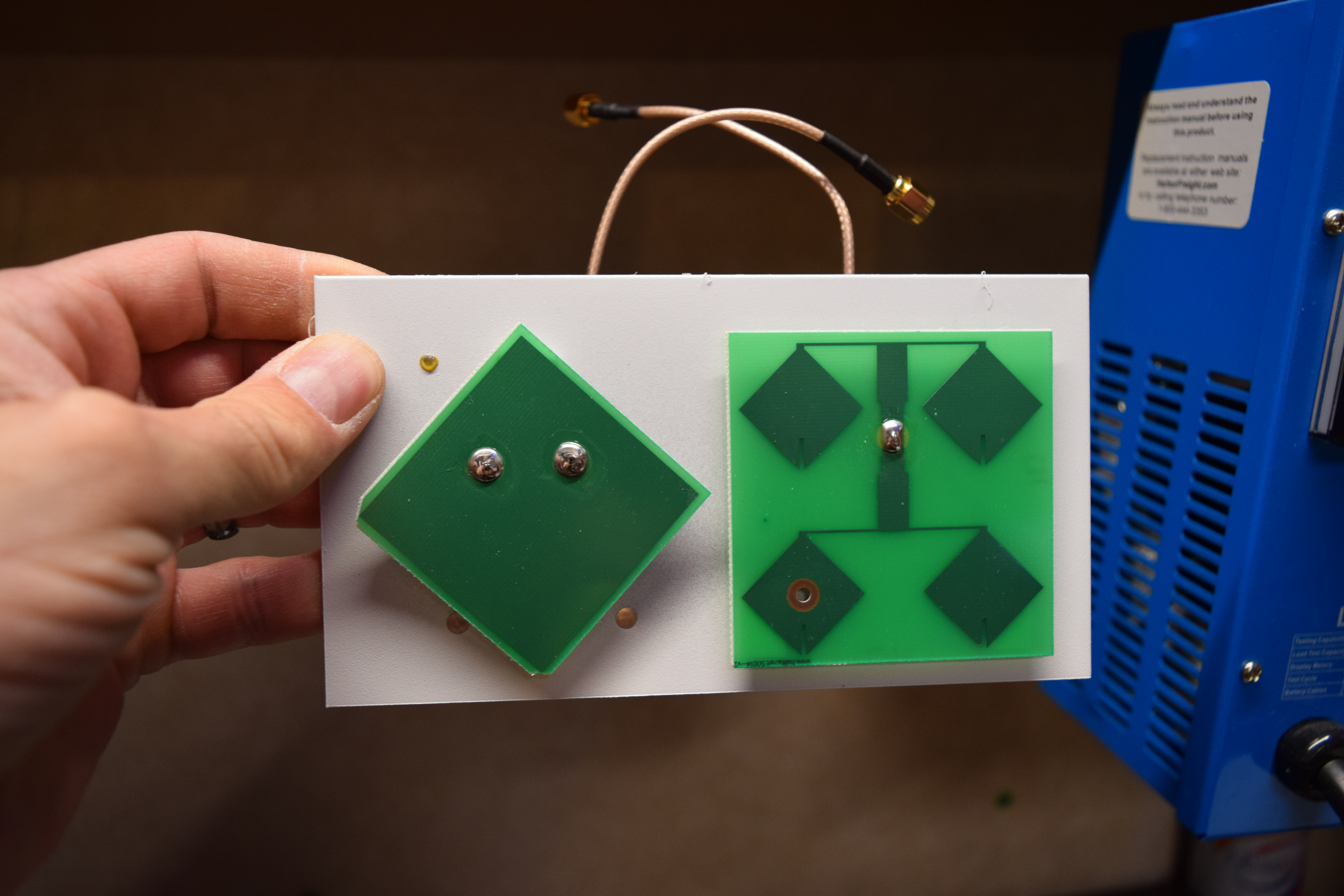

My DBS mod only gets me about 1500 ft before I start to lose video. I have full control well past that, but can't get video past about 1500. It is way better than what came on it though.
Any thoughts?
Any thoughts?
What kind of altitude you running? I need to be 300'-400'+ to maintain video with my DBS. And that is in an unobstructed area free from wifi interference, trees or buildings.
I set my max flight distance at 1000 feet as that is the best I can get stock without losing video feed. I've used the ITElite DBS antenna and the P3A dipoles and no matter what I use, nothing works better than stock configuration.
Heck I could not even connect to the drone 5 feet from it at times with the ITElite DBS antenna. Very disappointed to say the least.
The only mod I did see work better was replacing the stock 5.8Ghz telemetry antenna on the transmitter with a four leaf clover. I get 4-5 bars consistently, even at 1000 feet. I am still working on a solution to increase the range of the 2.4 Ghz system for better video signal range but to no avail so far.

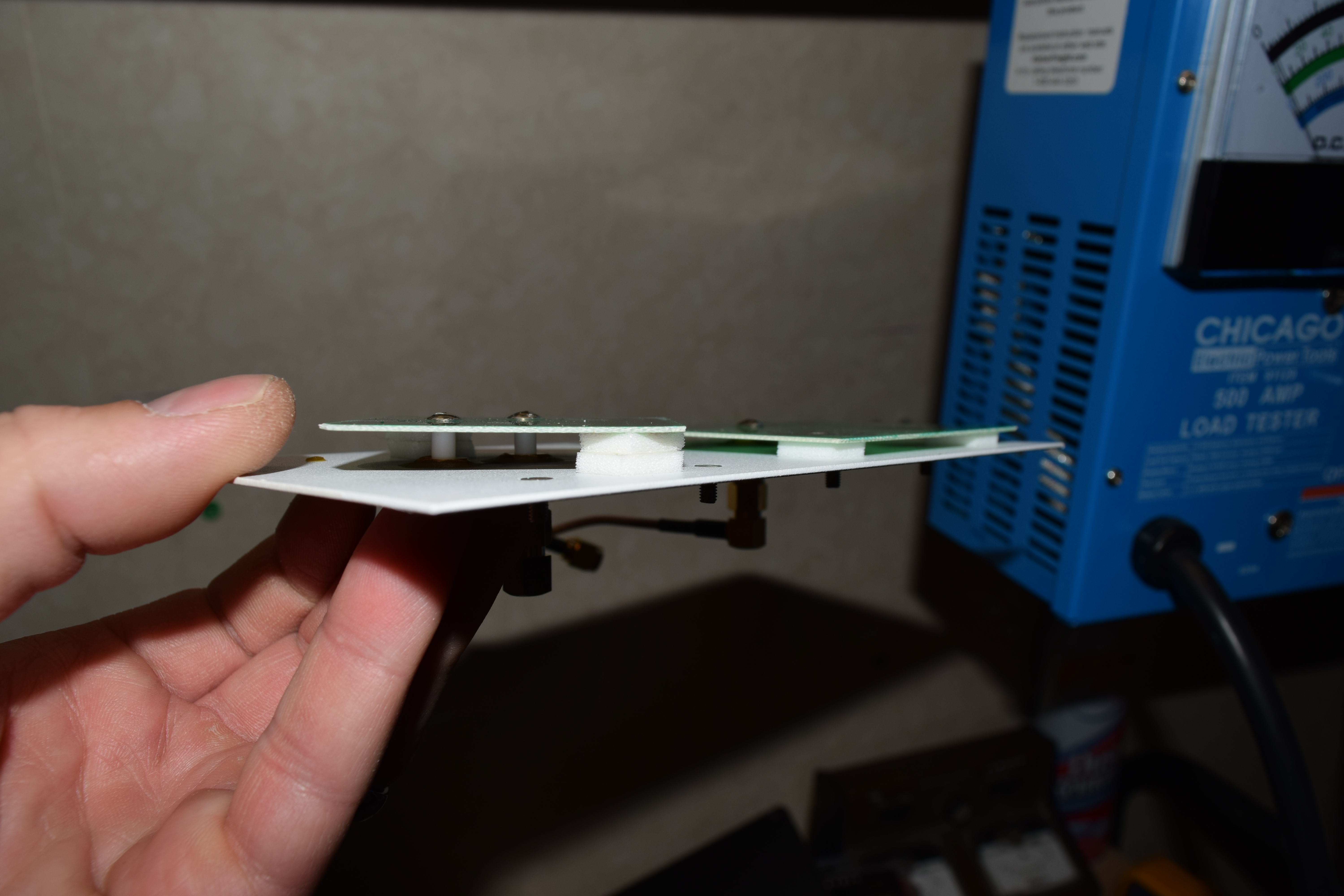

The DBS antenna kinda fell apart on me too.
Looks like a manufacturing defect and the plastic cover separated from the rest of the metal backplane of the antenna. The inside is bunk for 2.4 Ghz. I don't know why more people have problems as they combined the two 2.4 ghz antennas to only one element and then didn't shield it from the 5.8Ghz antenna which I am sure is causing what I observe as poor performance. Having two different radio antennas in near proximity leads to AGC pumping/desense in the receive side of the radio.
When time permits I would like to mount the two original ceramics from the transmitter on either side inside of the DBS antenna backplane and affix the 5.8 Ghz quad element squarely in the middle with two grounded shield partitions between all three sections to reduce/eliminate the possibility of receiver AGC pumping/desense. Maybe this will yield better results. I have some other directional 2.4 Ghz antennas left over from another project that are reasonably small 10 dbi gain "dishes" I could try to implement if all else fails.
I really don't want to go overboard and implement my dual 19 dbi gain panels. That would be waaaaay too heavy but I guarantee I could view the video stream from the next county!
I'm lucky if I can get 100 feet vertical altitude distance before disconnect and RTH. That's the main reason I reverted back to stock as at least I can fly with stock. I am still exploring some other options to boost the range of the operator control unit.
