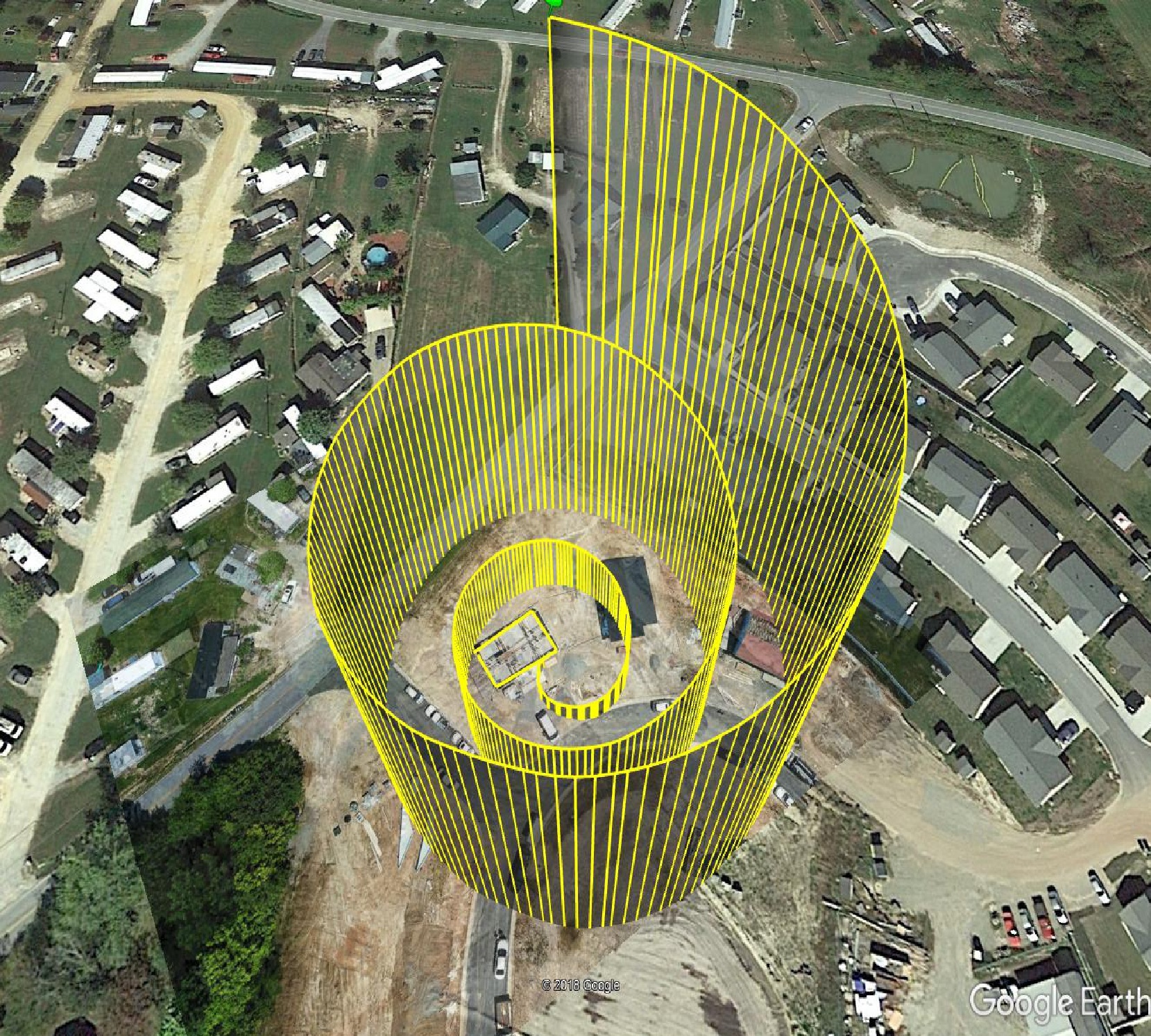

I thought I'd come back and update this thread a little bit. First off,
I am absolutely LOVING this program @namirda. I have had an absolute blast playing with my missions and "Tweaking" them using VLM. Below is a screen shot of a Descending Spiral we are doing for a client next week.

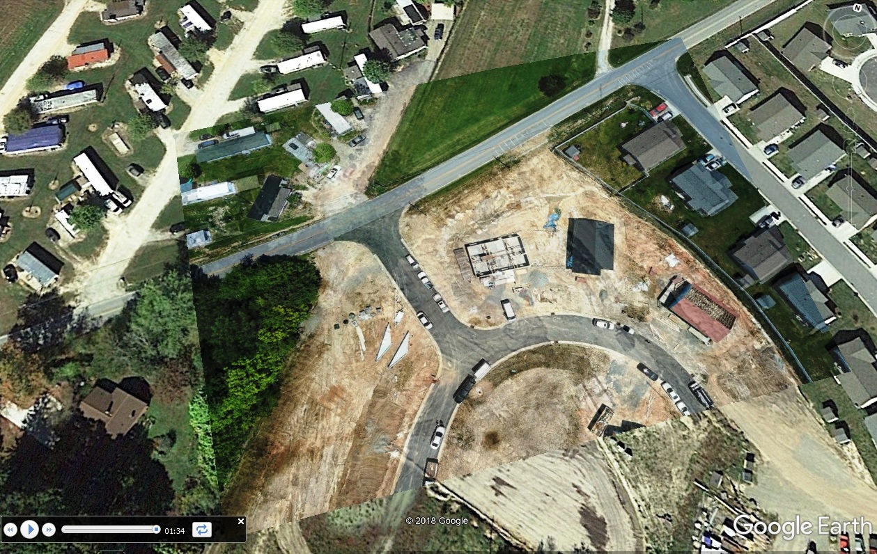

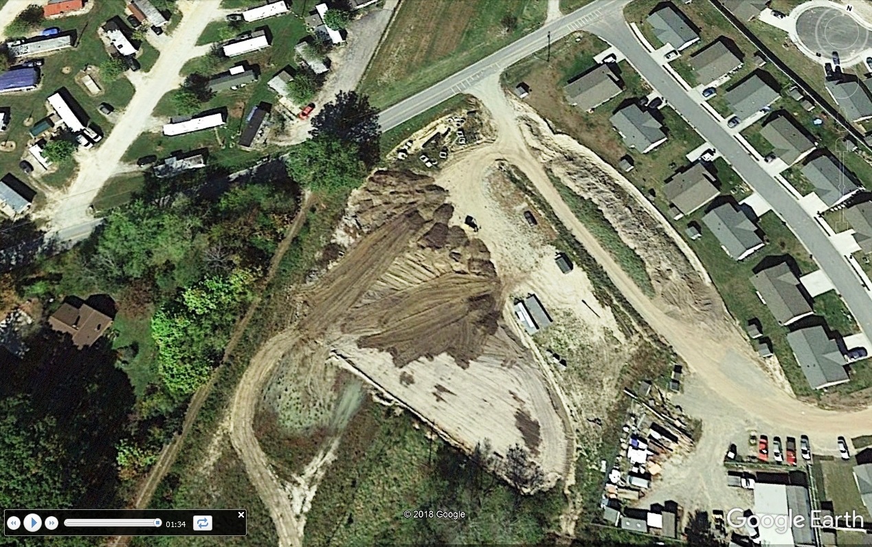

I finally was able to add the image we had taken of the jobsite over the Google Earth Pro as a layer and now I can turn it On/Off at will.
Here's the image before adding the new layer:
And here is my layer added to the image:
