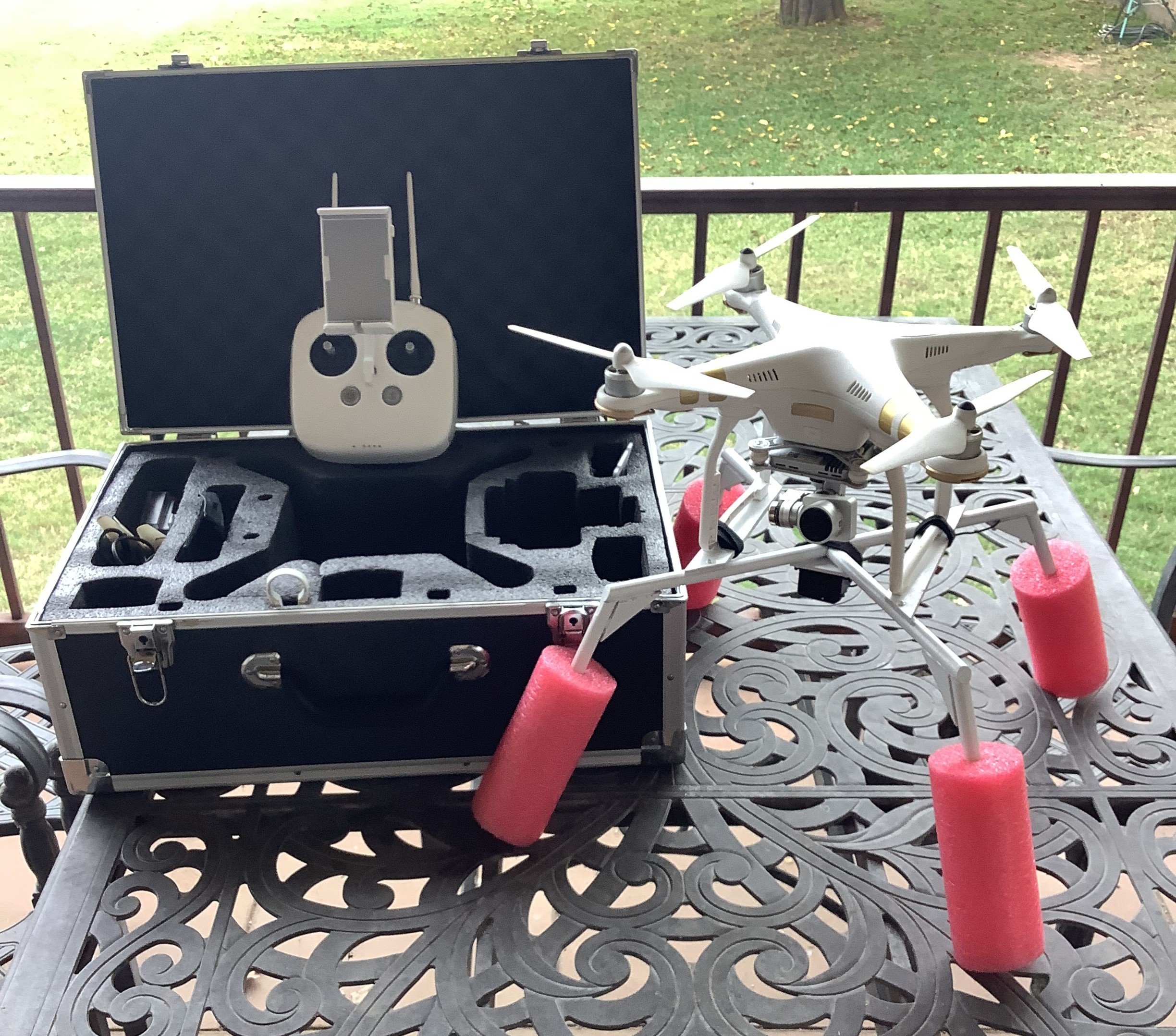

$30 bucks at Amazon and $10bucks for 1/2in dowels been using this system i made for dropping bait.
no need for go app I just fly
