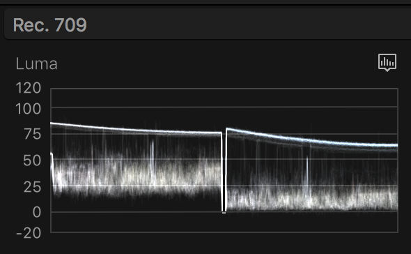

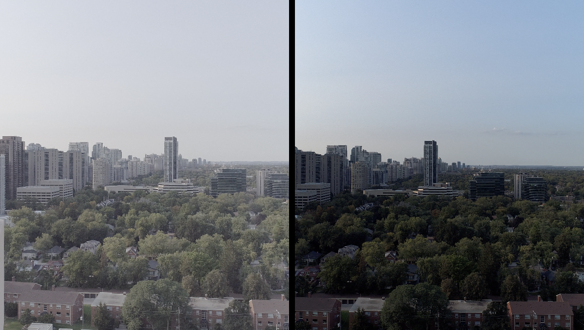

Then I took these images to FCPX for grading. First here are the luma scopes before grading. As expected the data is much more compressed with dlog:

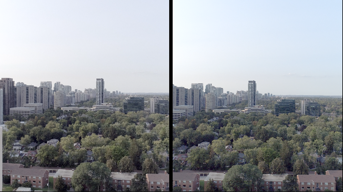

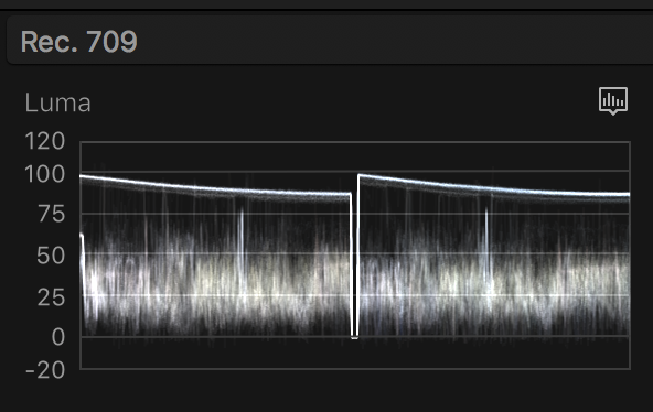

Here are the results after I grade them both to something more pleasing. I tried to match them as best as I can in the scopes as well:
As you can see, the DLog footage (left) is not in any way better than the right (normal). In fact, I would argue there's slightly less details in the clouds but that could just be due to imperfect grading. Also, color is less saturated with dlog even though both were shot with (0/0/0).
