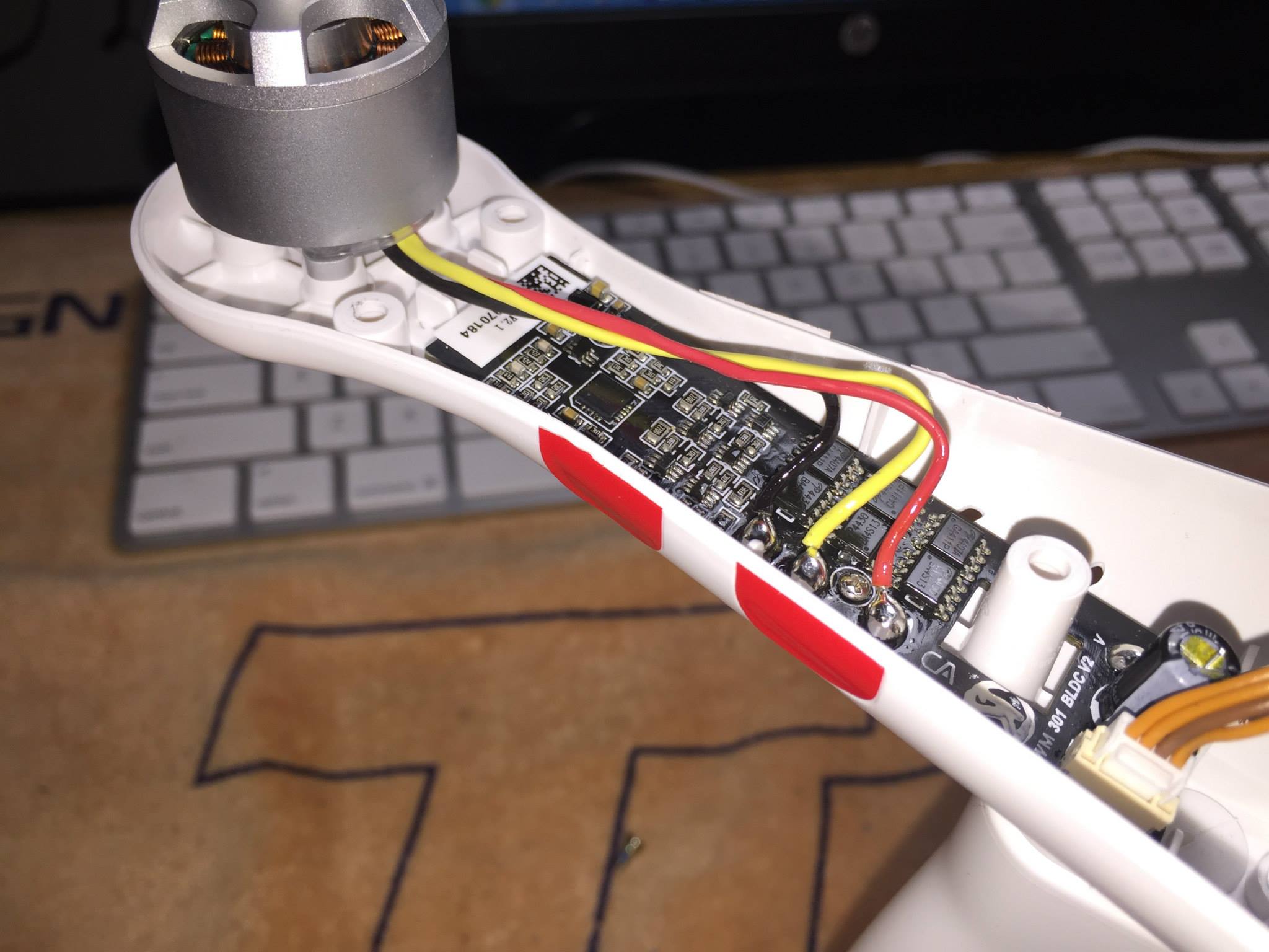

from one of my many "upgrade the wires" upgrades, just like Jeremy and I do it.
i've had so many people sending me their V3 Phantom asking to replace the wires and
so many were "next flight away" from bird dropping from the sky because the next flight would burn through the wires
or short something out.

Hunch.. which version of ESC do most of your clients who almost a crash do to wires dying have? And do you upgrade ESC to 2.1 for them? Or atleast recommend it?
do you guys just replave wires from thr bits sticking out ftom motors? Like in your first pic, do you rewire from that point?? Or do you take motor housing apart and change the wire from the part hidden by motor housing?? Thanks :)
